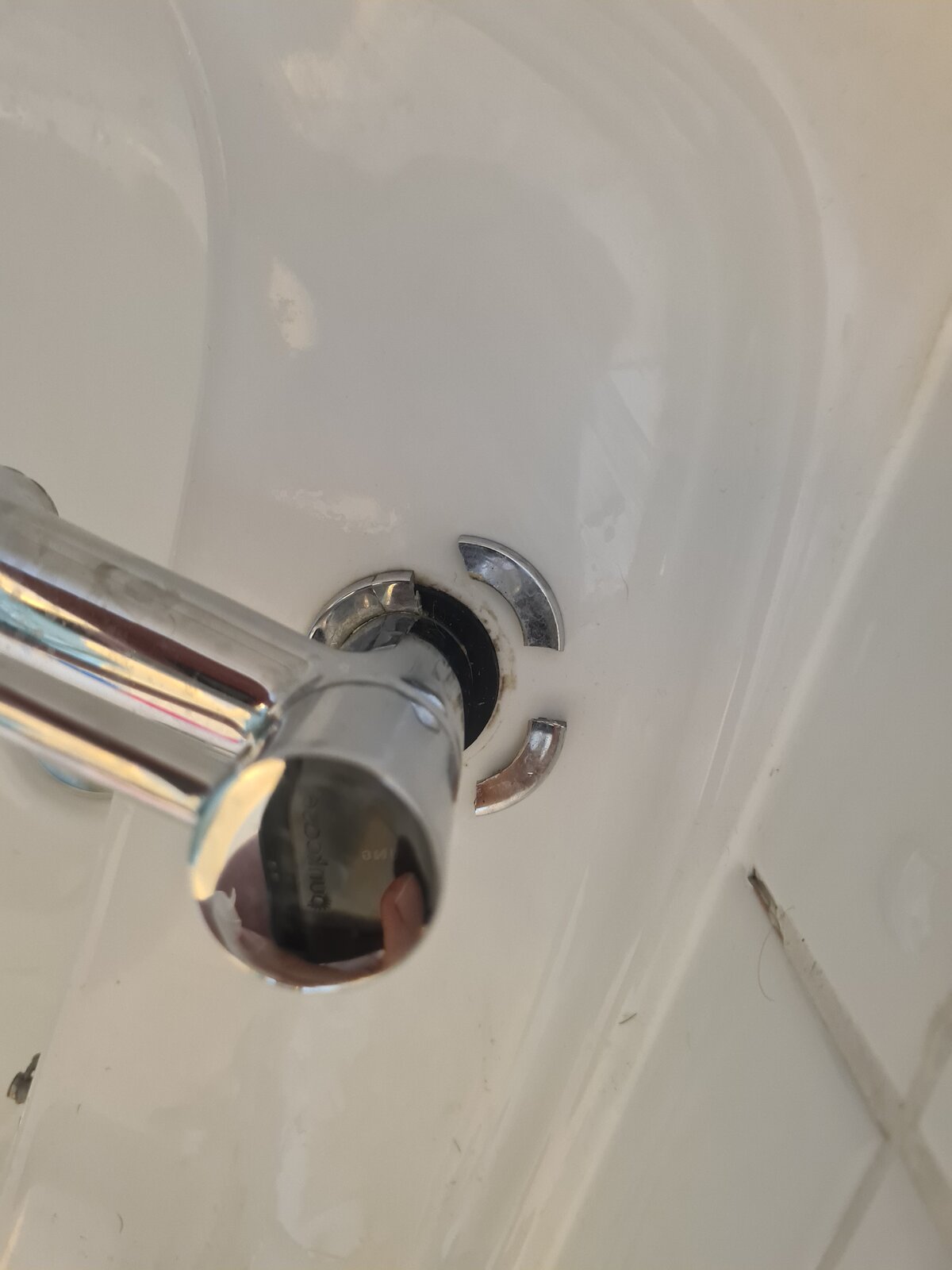

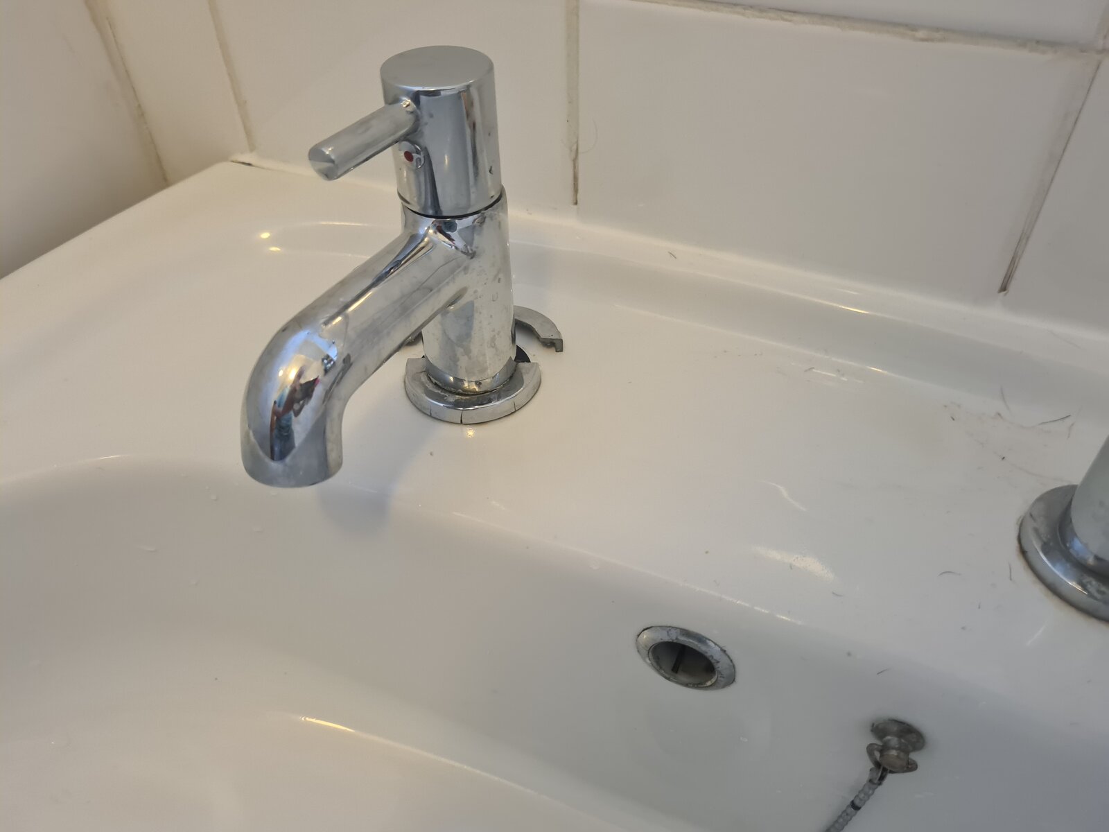

Hello all, our taps came with plastic escutcheons (if that's what they're called?) and one has broken.
Are these available without buying a tap?, ideally I'd like metal ones.
Is escutcheon the right name or are they called something else?.
Cheers all.
They're only 2 years old, £50 B&Q.
I'm sure the old ones had metal bases, should have kept the bottoms!.
Did the bath taps at same time (wife likes matching taps..)
Tap's been overtightened onto the basin/bath.
I just know them as Tap Base Rings/plinth. If you do a search you'll find loads.

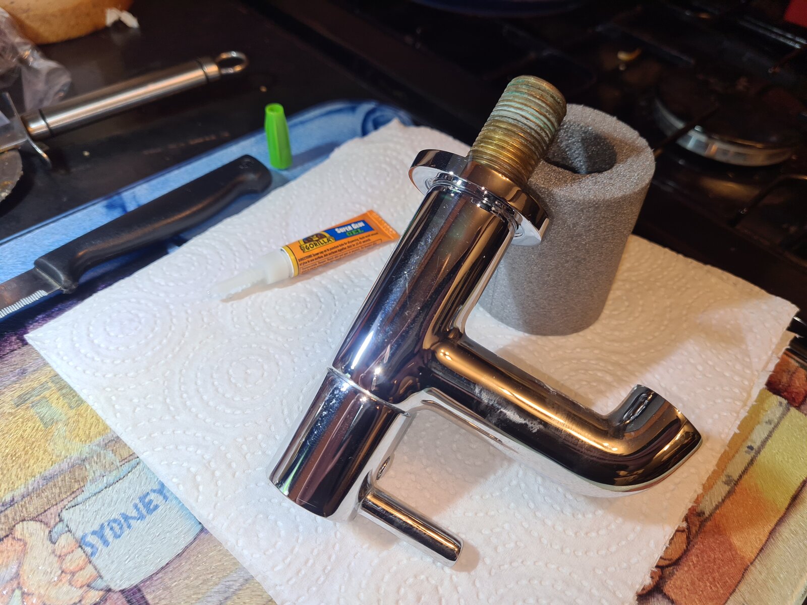

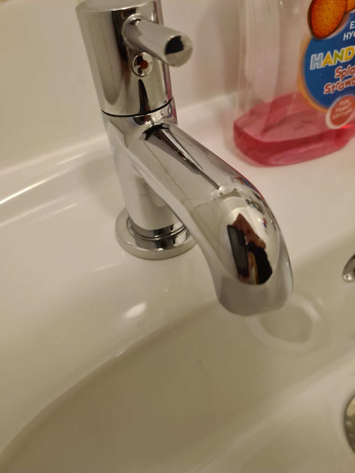

I managed to get a pair of brass base rings and fitted them tonight after work so we have a hot tap again at least (£7 per ring).
I remember fitting plastic nuts as the brass ones were a nightmare to get off the last set, but the plastic nuts are sh1t; that's why they were overtightened.
So next job is to buy some proper nuts!. Job for weekend.
Cheers, every day is a learning day as they say. The taps themselves look decent quality, the fitting kit was ****e!.

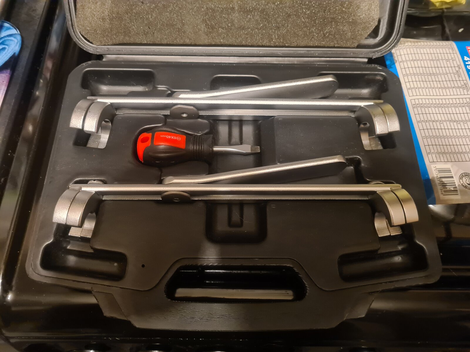

On a plus point, it was the 3rd outing for my Armeg Jaw Droppers.
Money well spent?, I'm a bit of a tool nerd..
They are good, if you use them enough to justify the cost. I use a par of adjustables for the connection and a box spanner for the back nut
Plastic back nuts are crap but a trick with the brass back nuts, wire brush the taps threads and add a little silicone grease, will stop the threads mashing together, if you overtighten the brass to brass they will be a nightmare to get off. Also makes sure the surfaces of the basin are spotless and dry, will allow the rubber seals to grip properly without having to overtighten.
Cheers, I bought the Jaw Droppers for our bath (originally fitted taps before it went in), genuinely don't think I'd of managed without them so money well spent.
