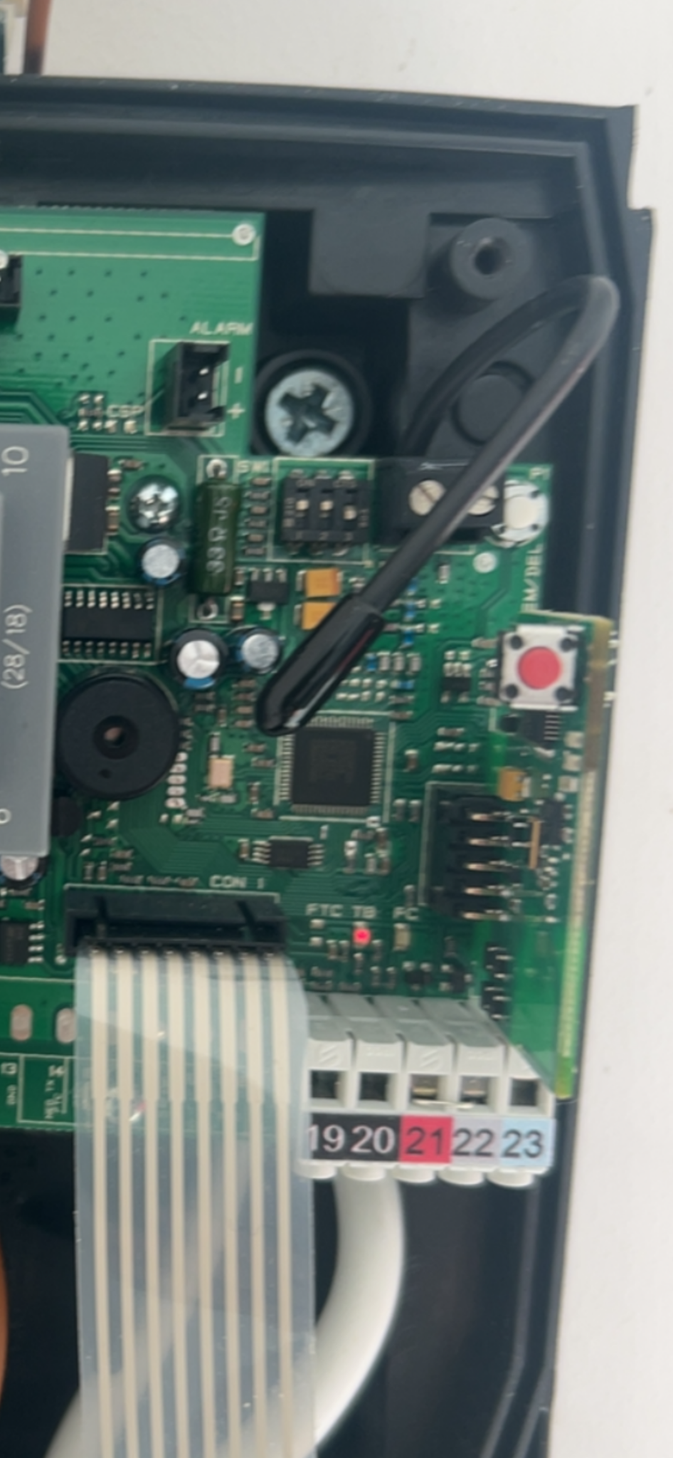

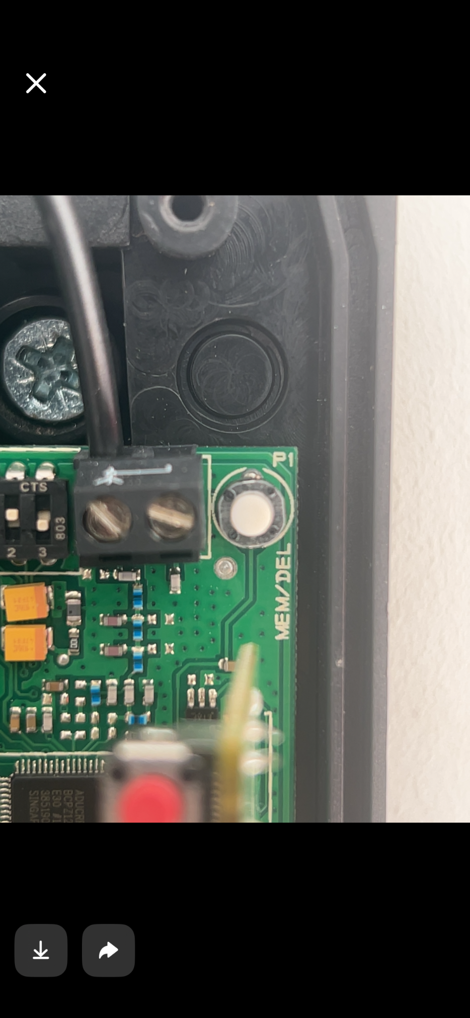

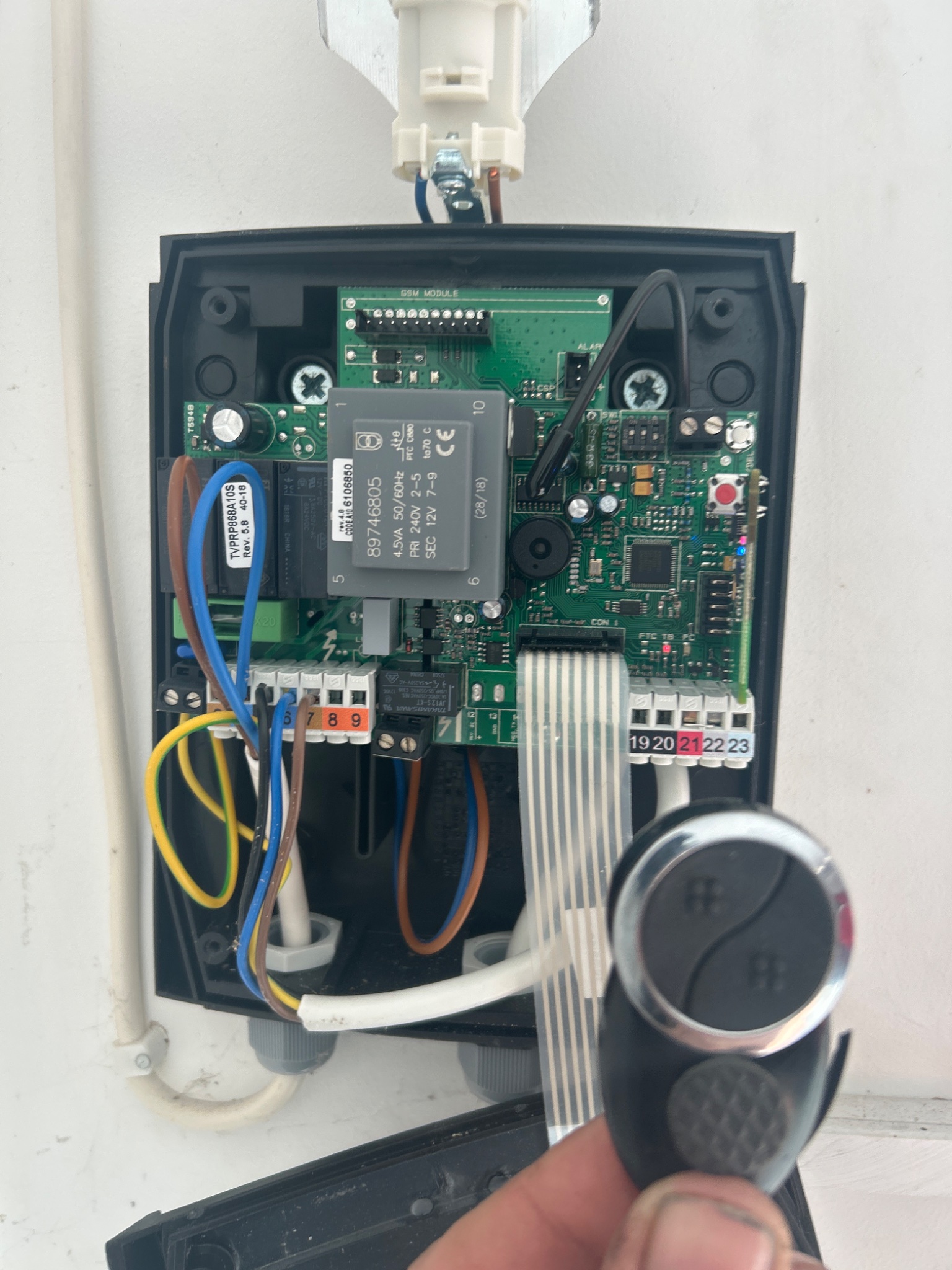

Can anyone offer some help to what should be a simple task. My old mans got a teleco controller running his garage shutter. Works as it should up and down on the box and up and down on 1 fob, but has 2 other fobs that I can’t get to works. They were working but since battery change they will not operate the door. Red light illuminates on the
Fobs but nothing works. Have had the box open and found instructions to pair. Press and hold p1 on the board and press appropriate button on the fob but it does nothing. Tried many times on both spare fobs but nothing. Tried the clone from working to non working. Press p3 on working fob the wall unit beeps and press working button followed by non working button to clone but still nothing. Driving me mad now as I’ve spent way too long trying to pair the fobs. Also can’t find much info on the red button on the piggyback board in case I need to do something with that. The fobs are the correct mhz as they came with the door and were previously working.
Cheers in advance.

Just looked online and I finding different instructions.
Programming mode by holding buttons P1 and P2 on the receiver panel until LEDs flash. For one-button operation, hold P2 until a continuous beep sounds, then press the new remote button. For two-button, press P2 twice, then the remote button.
Look yourself to see if it makes sense and works
