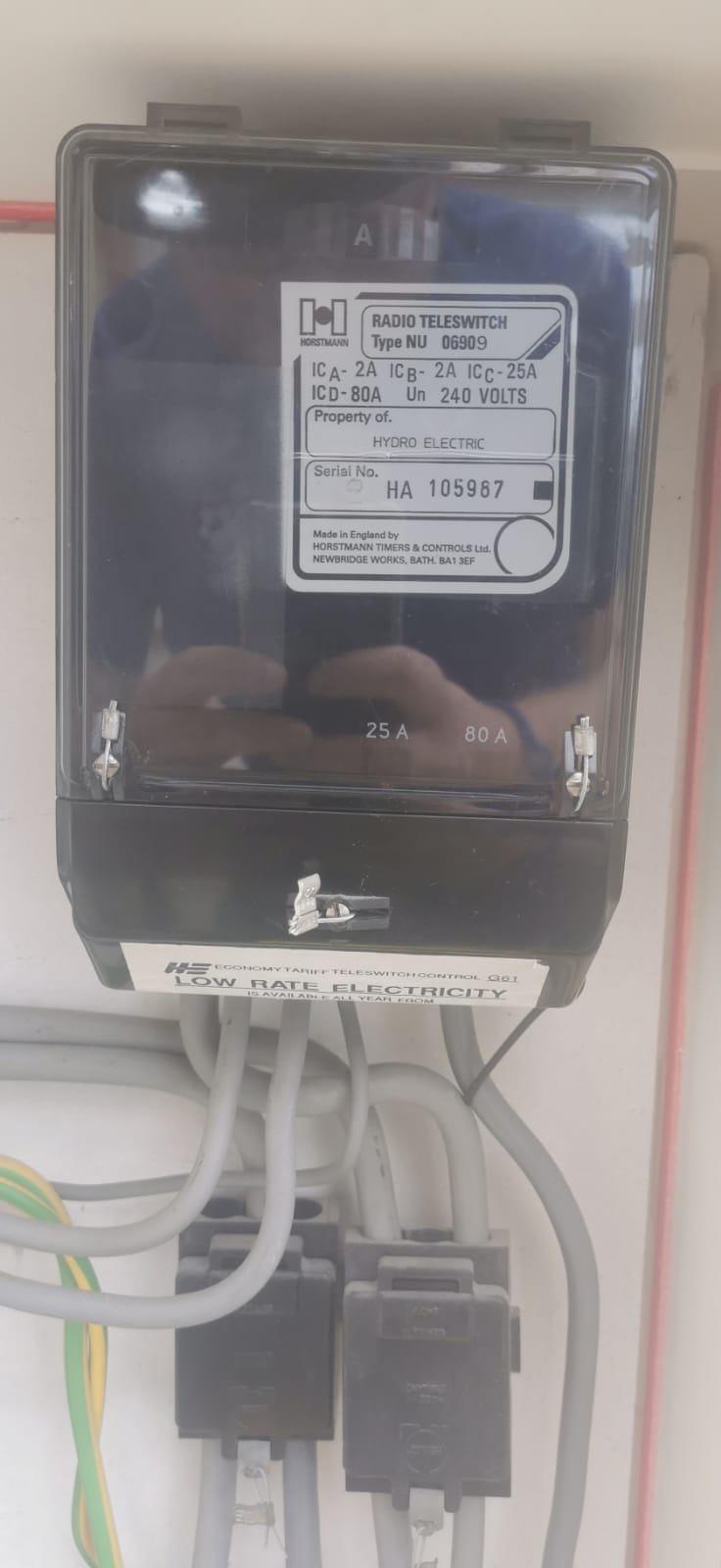

Property with "total heating total control" installation from back along. I believe that the heating (4 x old mass storage + immersion) is controlled by a radio teleswitch; I believe it relies on a signal embedded in the 198kHz service which is then decoded inside the teleswitch module.
anyway for some time now (like at least a year) the heating has been unreliable.
in this district SSE have been doing a lot of work recently burying formerly overhead 11kV lines, and arranging temporary generator services. apparently the heating worked well when they were on a generator supply but has been very rare to come on ever since.
do these teleswitches fail?

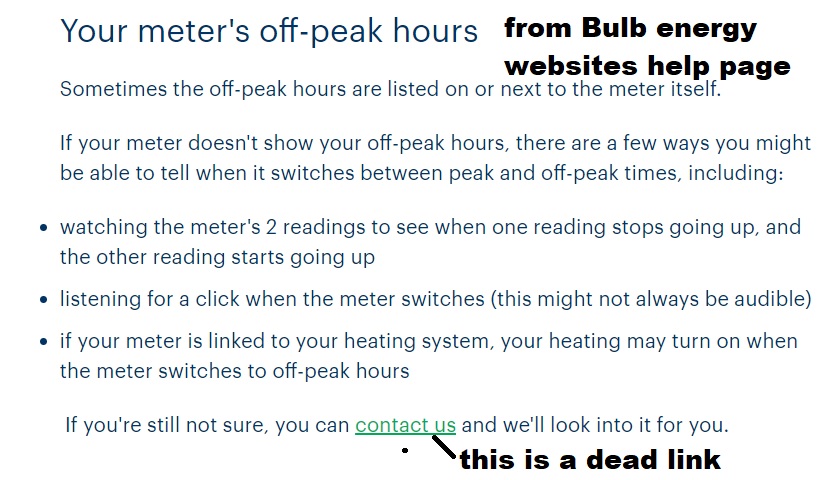

attached is the somewhat unhelpful guide from Bulb energy (the present supplier for this property), I seriously cant believe that they are suggesting listening for the clunk or watching the meters.

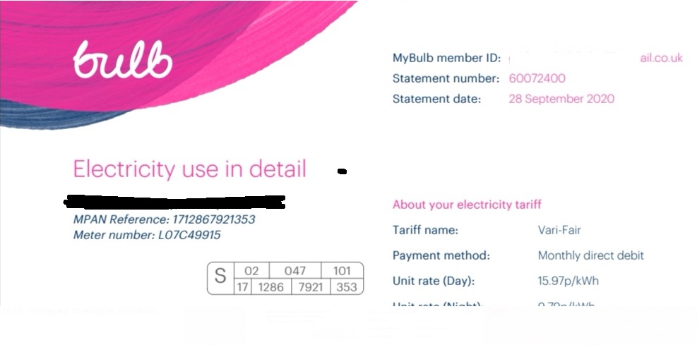

also attached extract from recent statement including MPAN nr, can anyone help to identify the timings for this teleswitch please?

They are deliberately randomised. Otherwise you might have ten million electrical heating systems all switching on at exactly the same moment. Which would be very inconvenient for the electricity generation, transmission and distribution systems.
If you want to know your own, exactly, listen for the clunk or watch the meter.

BTW the meterpoint number number is occasionally useful to know. You might like to write it on a durable label and stick it close to your meter.
yours is
S 02 047 101
17 1286 7921 353
which means
S Profile Type. This does not seem to be published any more, but from memory it means it is a Supply meter, i.e. you are not a generating staion.
02 Domestic Economy meter
047 DNO specific time switch code
101 Line loss factor
17 Northern Scotland SSE (used to be "The Hydro")
1286 7921 Unique identifier
353 Check digit
The numbering system was created by people who did not understand, or perhaps did not trust, the concept of reference numbers. "1286 7921" is your unique number. All the other stuff is not reference number, it is data associated with that reference number. However the systems have been designed to require all of it.
really?!
the meter & teleswitch is on a semi-outdoors porch, I used to live there and you never hear it. I rigged up a lamp on the heating supply so that the current occupant would be able to know when the circuit energised, but... really? in his world, he is unable to sit there all day watching the lamp/looking at the meter/listening for the clunk! who is? and why should he have to!
