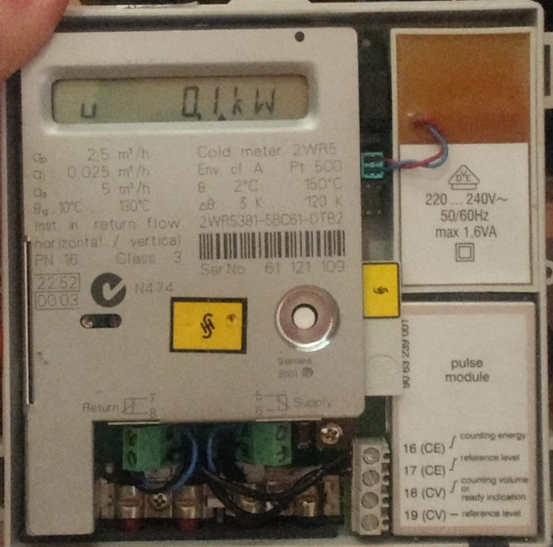

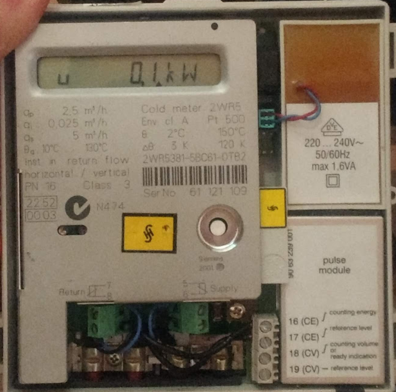

When I enter Service Loop 1, the Current Flowrate and the Current Heat Output parameters are shown with an "u" sign in front of the values. According to the installation instructions, the explanation is:
The flow rate, the heat output, and the differential
(temperature difference) are acquired with the
correct sign. If the lower response limit is violated, a
u is displayed in front of the value.

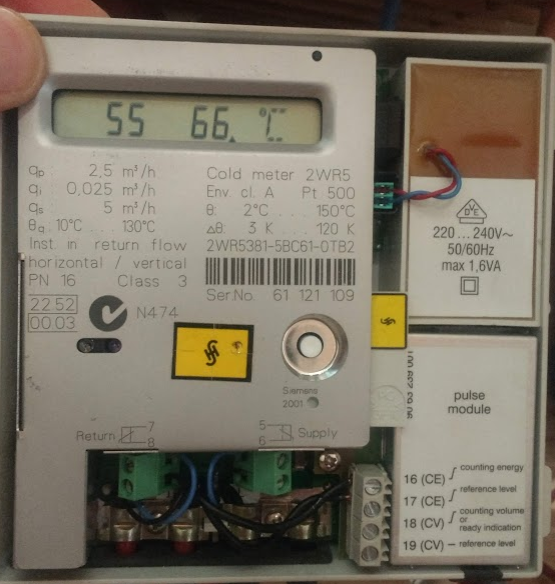

I am not sure how to understand this line. The meter registers flow and return temperature, which are accessible via Loop 1.
What I've done so far is: disconnected the PT500 sensors and read the values below:
Return: 598Ω, corresponding to 51° C approx.
Supply: 602Ω, corresponding to 53° C approx.
The Supply value is shown in Loop 1 and was correct. I don't think there's a way to show the Return value on the display. This may point out that there's a fault in internal measurement of the Return temperature. The display is not showing any F errors.
Below is a picture of the meter. Can someone suggest how to check for other faults before buying a new meter.

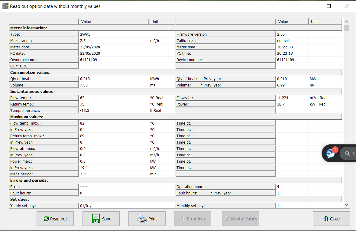

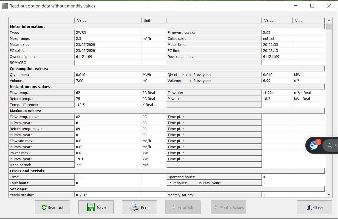

I connected to the meter via UltraAssist and it appears it correctly registers flow and temperature difference, and calculates the kWh value with a correct sign, see attached picture. However the display still shows an "u" in front of these values, meaning they're under the operation limit. The operation limit is set to 20% from qi (0.2 * 0.025m3/h) - I am able to read that but not modify it.
Any ideas how to proceed in order to find the fault?

I just had a look at the instruction manual. The illustration for loop 1 shows the current FLOW and RETURN temperatures from left to right as 92 C and 55 C.
Your photo shows the FLOW at a lower temperature than the RETURN.
If you agree there is a simple choice of test:
Test 1. Disconnect the cable to the supply sensor (terminals 5 and 6). Does the FLOW temperature indication change to a silly figure or error message?
Could it be that you have had some rascal sneak into your flat and swap the cables over, because SUPPLY should be warmer than RETURN?
Could it have been the same rascal that measured the resistance of each sensor?
Test 2. Take the SUPPLY sensor out of its sensing pocket and leave it to cool slightly. Do you see the SUPPLY temperature drop on the display?
If your wires have NOT been crossed then take BOTH sensors from their pockets and tape them together in air. Do they display very similar readings?
Put them in hot water (if they're waterproof, of course); Again do they display similarly?
Are you actually using any heat at the time you make this observation?
What makes you think the meter is not functioning correctly?
@MeldrewsMate: The meter is installed on the return line. The flow is therefore negative. The temperature difference is also negative, and the resulting calculation for the energy has the correct sign.
I did check the sensors and they're working fine. The meter is also registering the water flow as seen in the "Flowrate" field.
@endecotp: I am turning on the heating and can see the flowrate and temperature differential increasing. When I turn off the heating, the temperature differential approaches 0.
What makes me think that the meter is not functioning correctly is that it's not accumulating the consumed energy, and my building manager is complaining that I am using hot water without paying. The meter readings stay the same from several months.

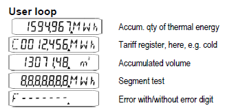

The meter is supposed to display the following in the "normal" mode:
Accumulated thermal energy and volume are not changing.
The meter is connected to the BMS via a pulse output module, that's how the building manager bills me. I haven't tested the actual module for faults.
That's correct I think. You can see flow rate and temperature differential in Loop 1. Accumulated values are shown in the User loop. While values in Loop 1 are changing, values in User loop are not updating.
On top of that the accumulated volume shows 7 m3 which can't be correct. It's been above 40000 when I moved in; to my knowledge, there's no way to reset it.
