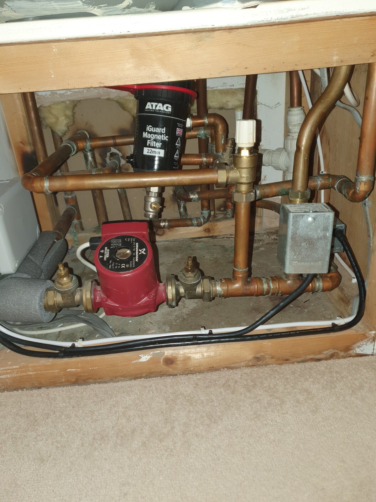

I can't work out which way is up on this pic. It looks as if the pump is lying on the floor pointing upwards which, if it is, is the worst way to install a pump as it will wear out very quickly due to lack of lubrication. The pump shaft mut always be horizontal.
If the pump is installed as at appears in the pic, it could already be worn out as the flow/return differential (A2-A1) of nearly 30 degrees says that the flow rate is much too low, which could indicate a damaged pump.
You asked about A1 and A2 being the same when the boiler cuts out. Do you mean when the flame goes off or when the pump stops working? Normally there will be a noticeable temperature differential until the flame goes out, but this will reduce as the pump continues to run for a few minutes (pump overrun).
Yes the silver screw cap on the pump is pointing upwards, I'll turn it horizontal but it's been this way for 12 years probably. Is there any way to test whether it is working correctly as a new one is rather expensive and I'd rather not go replacing random parts if it's unnecessary? With regards to the flow and return difference, it's always 20-30 degrees difference at the point the flame goes out, and yes the pump does keep running. Also both values do get similar a few minutes afterwards, say if the boiler cut out at 80 ish after a few minutes both flow and return will be around 50-60. Obviously lower if the boiler cuts out at a lower temp. Perhaps explains why the boiler temp was set so high - the installers knew there was a problem with low circulation?

Sorry I forgot to post about that, it didn't look too badly gunged up inside and I tried to give it a clean, hasn't seemed to have any effect though. I should have taken some photos, sorry I didn't think to at the time. I have also now orientated it horizontally, which also has not changed anything, I suppose if its damaged from being mounted incorrectly for so long it's not really reversible. Would it be worth changing the pump out as it's 12 years old anyway to see it it makes any difference?

There was nothing large at least, just little black bits as would probably be expected. Nothing large came out of the ports. Base was clear although a little rusty. It was able to spin fairly freely, and no obvious damage to any parts, but as has been said who knows if it is actually working at the right speed. There isn't anything I can do to test it really is there? Also what do you mean by '6m of head' ? Is that the length of the legs to the rads?
Actually I should mention when I set it to the 2nd or 1st speed settings the motor sometimes makes a buzzing sound as if it is trying to start up but can't, this only happens if it has stopped completely before trying to start, and I will get going eventually. Fastest speed setting does not do this, it runs normally and starts without a problem. Now it was doing this before and after I took it apart so even though it could spin freely when in pieces maybe it is getting a bit stuck when its put together? No obvious reason I could see though.
Mentioned before by others, 'lazy pump'. I would even more suggest changing the pump now.
Fair enough I will do that, should I go for an exactly equivalent replacement? Also if that doesn't help whats the next thing to look at?
