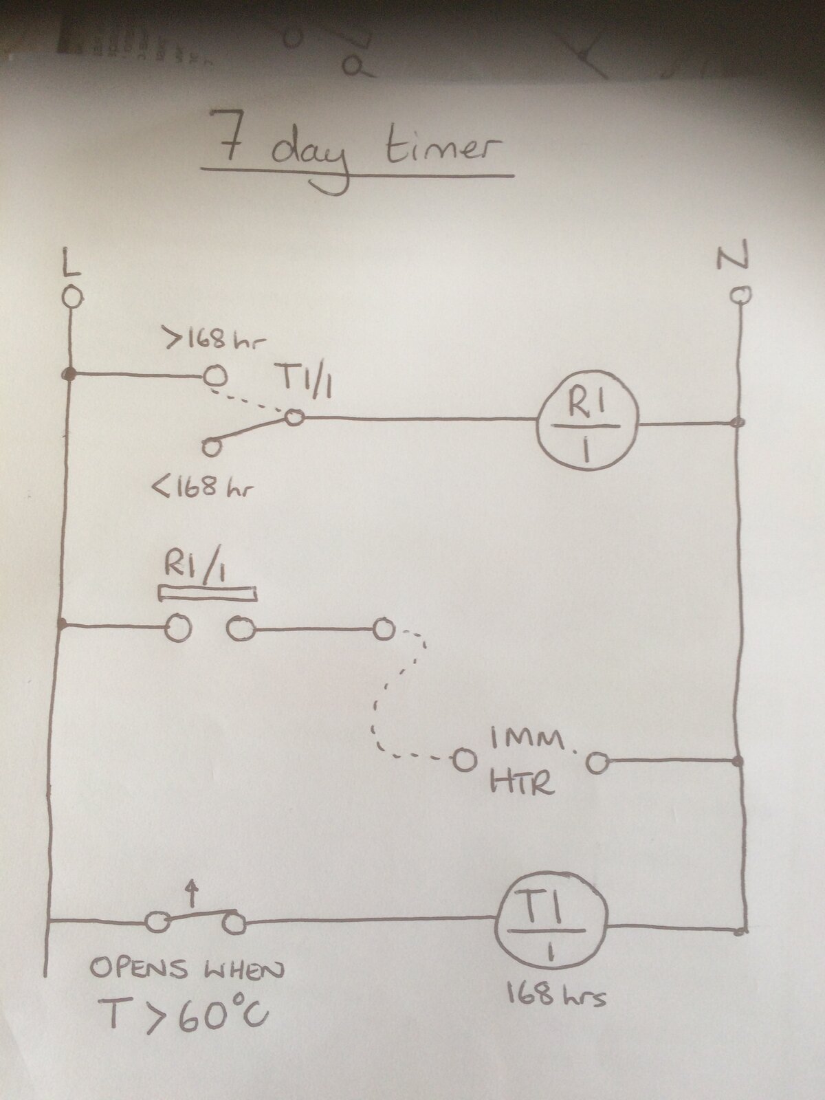

That's something you'd have to build yourself unless someone else knows better. I built one for my dad's solar PV diverter and it works very well, but mine is based on an addition to an existing Arduino based project with a software modification to go with it. Yours could be much simpler, needing an output from your thermostat (=tank has reached 60°C), a mains powered timer (=your week has gone by without getting to 60°C), and a seperate relay (=latch ON until 60°C has been reached)
The time delay T1 by something like this: www.ebay.co.uk/itm/393480531697?hash=item5b9d446ef1:g:bbkAAOSwZpRh29kB
I'm afraid I'm not very good with windows software, so drawing a sample circuit is beyond me. I've drawn it on paper and taken a photo; fingers crossed it'll appear here...
Essentially the live supply appears on T1 constantly until the tank contents reach 60°C. During this time the timer runs. When it gets to 168 hours (7days) relay contact T1/1 closes and energises relay R1. Its contact R1/1 puts power to the immersion heater until the temperature reaches 60°C and T1 is reset. IMG_4822[1].JPG
During the summer months the timer will be reset just about every day as the Sun does its work, during winter or after a long cloudy spell the immersion heater will be called into action using grid power.
Essentially the live supply appears on T1 constantly until the tank contents reach 60°C. During this time the timer runs. When it gets to 168 hours (7days) relay contact T1/1 closes and energises relay R1. Its contact R1/1 puts power to the immersion heater until the temperature reaches 60°C and T1 is reset.View attachment 269370
