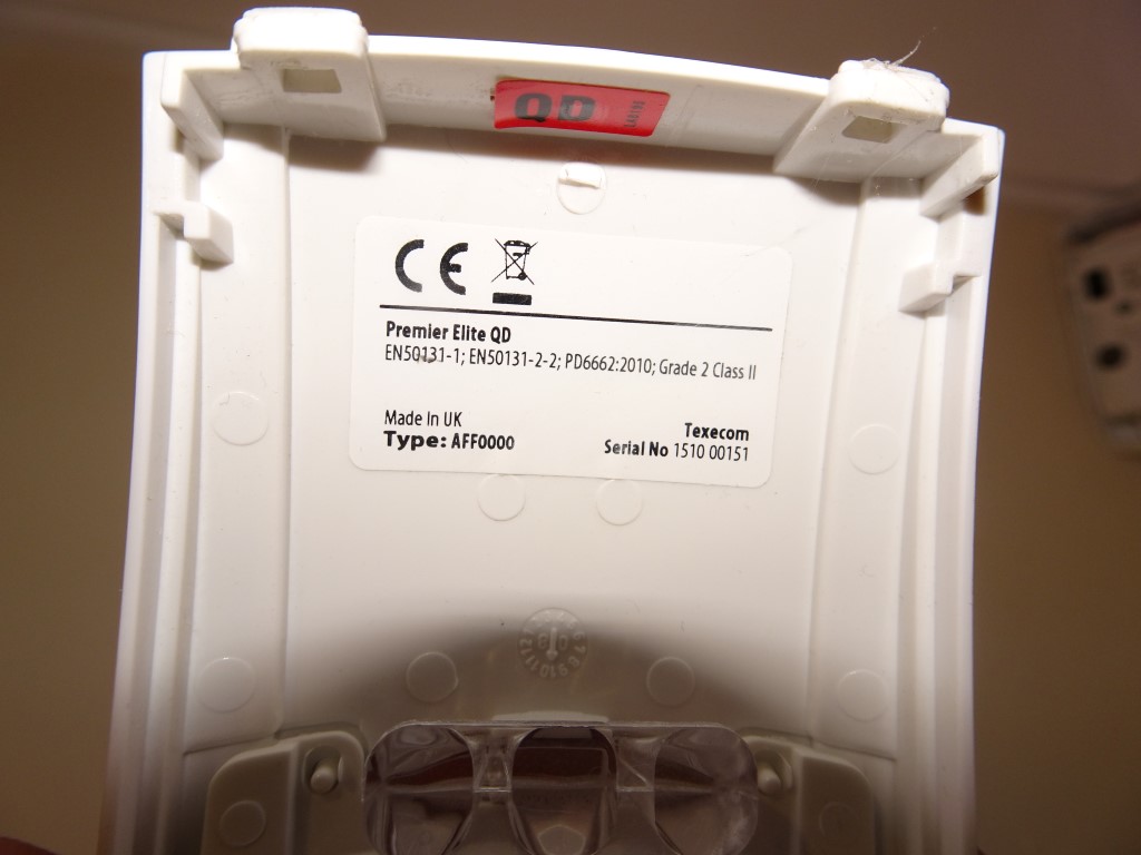

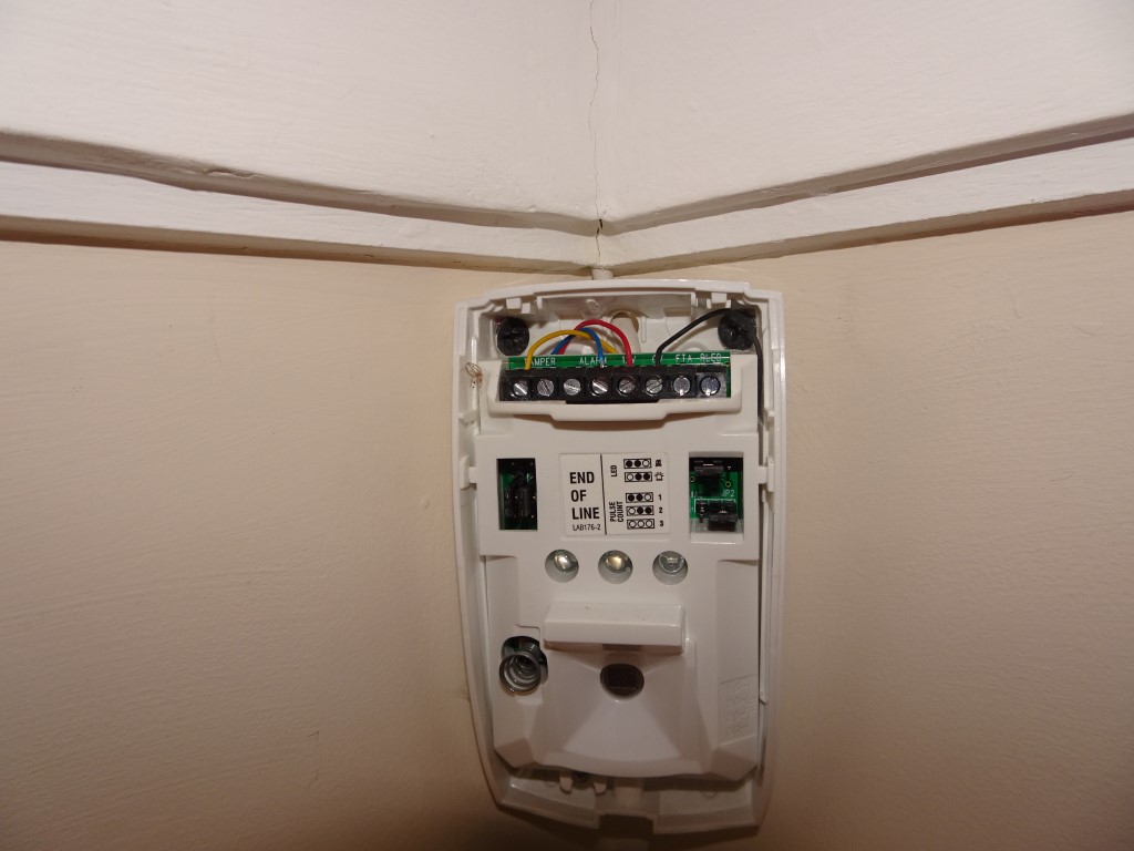

Sorry I dont seem to have as many cables as you mentioned - or are there more behind the facia?
Which of these wires would I twist together?
I can see
Yellow = Tamper
Blue = Alarm
Red = 12 V
Black = cant see...
That sensor is wired EOL (resistor)
Go into zone programming via engineer mode
Go to that zone number and make zone not used
Disconnect power is above
Can not short out by twisting wires together

PIR is on same zone as another PIR and I rather not disable whole zone. Is it reasonable to just use another piece of alarm cable and twist the correct colour to correct colour and reconnect it allowing to hang in a safe space? or perhaps electric connector block.
