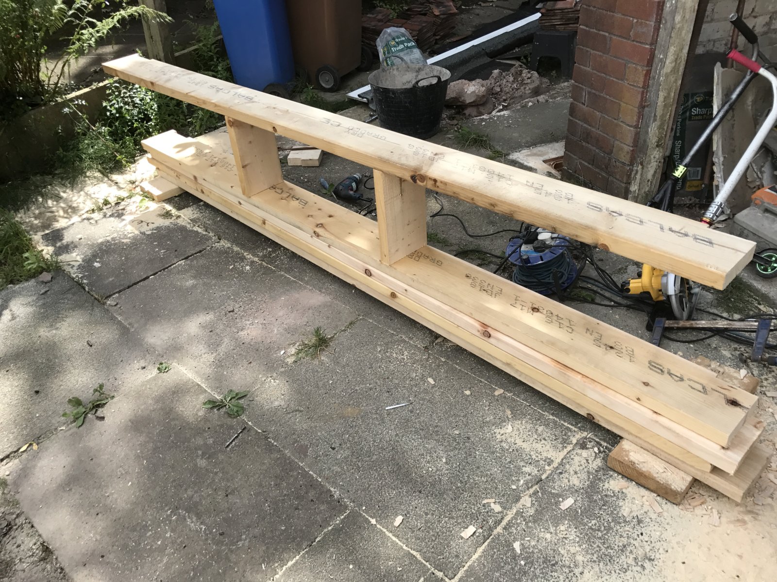

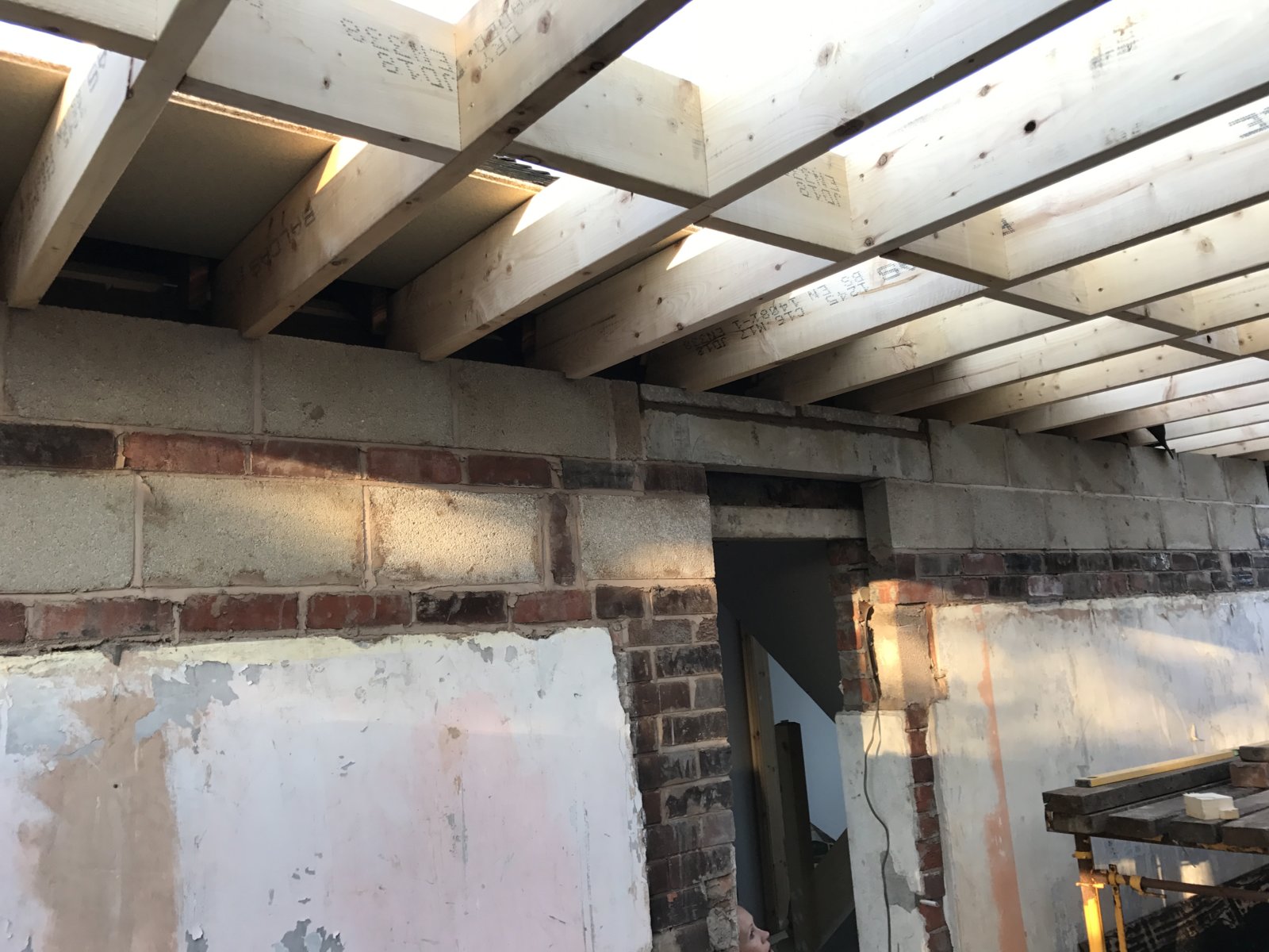

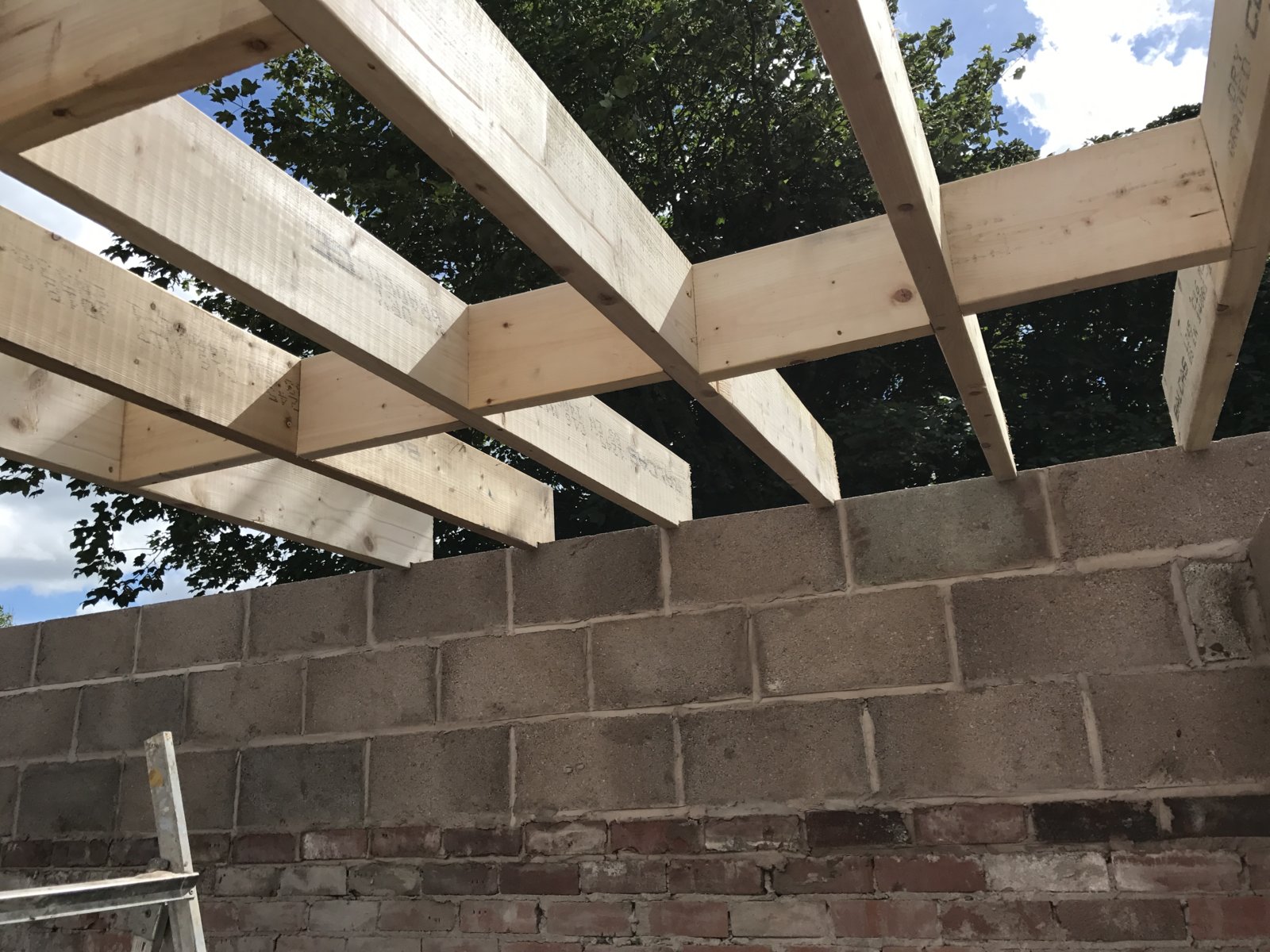

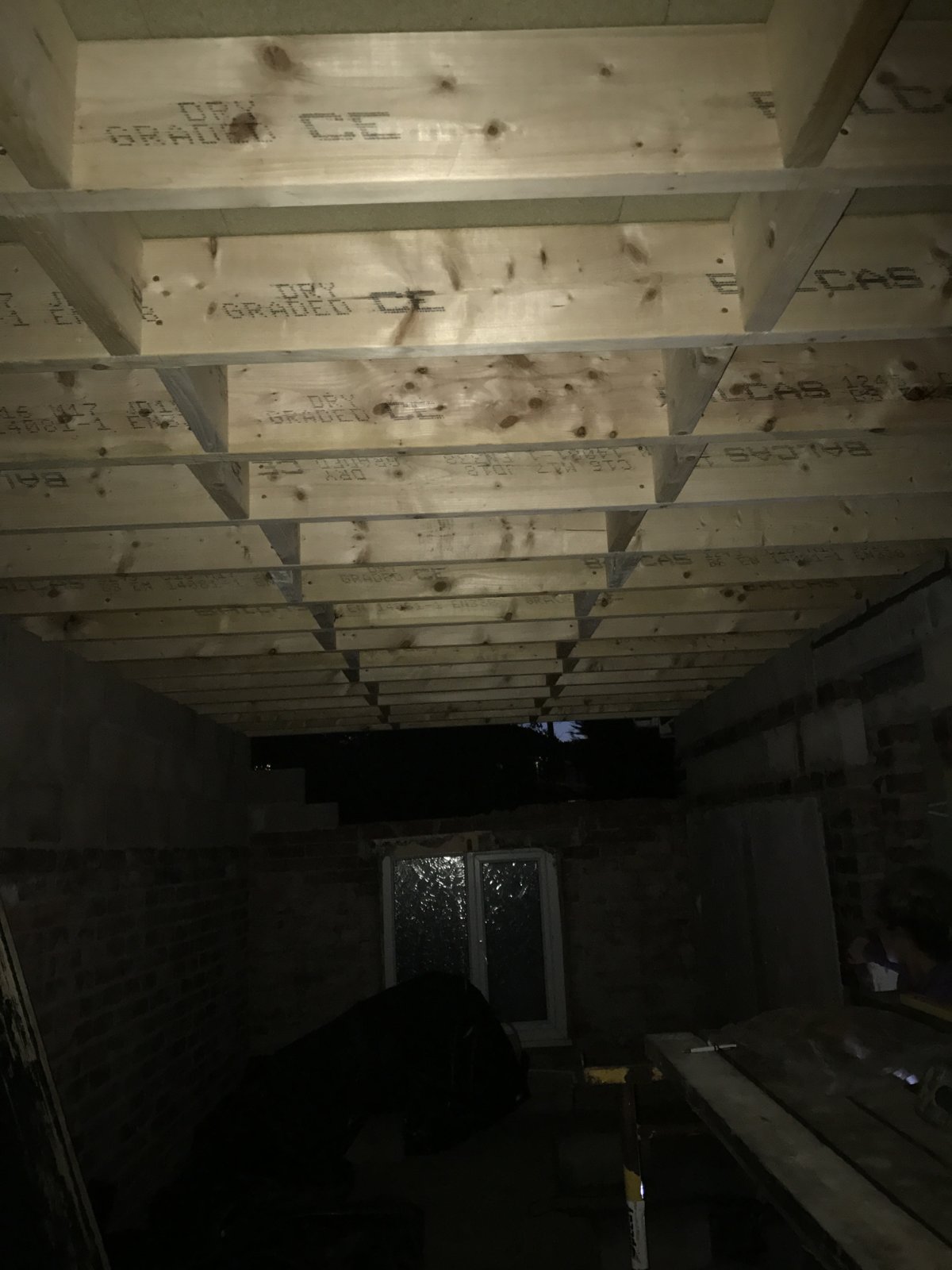

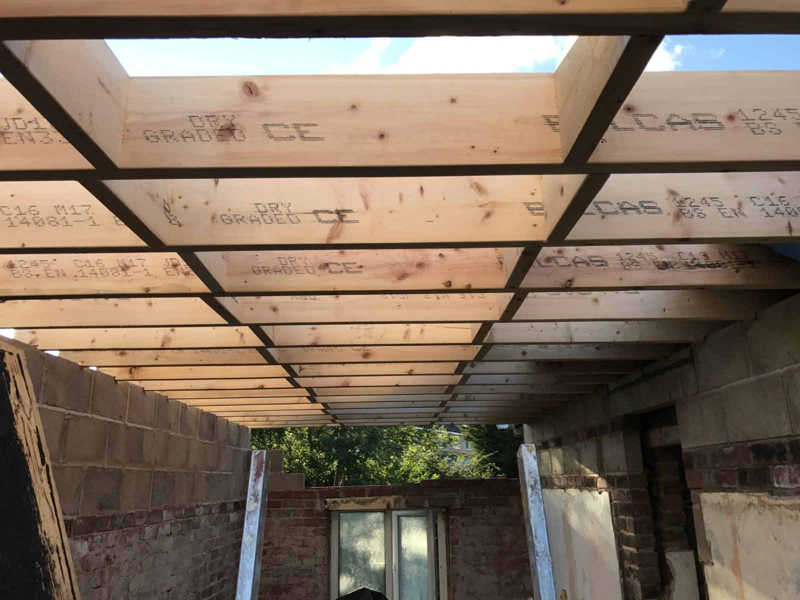

So I blagged a bit in my first post, I just fitted the joists and floor today.

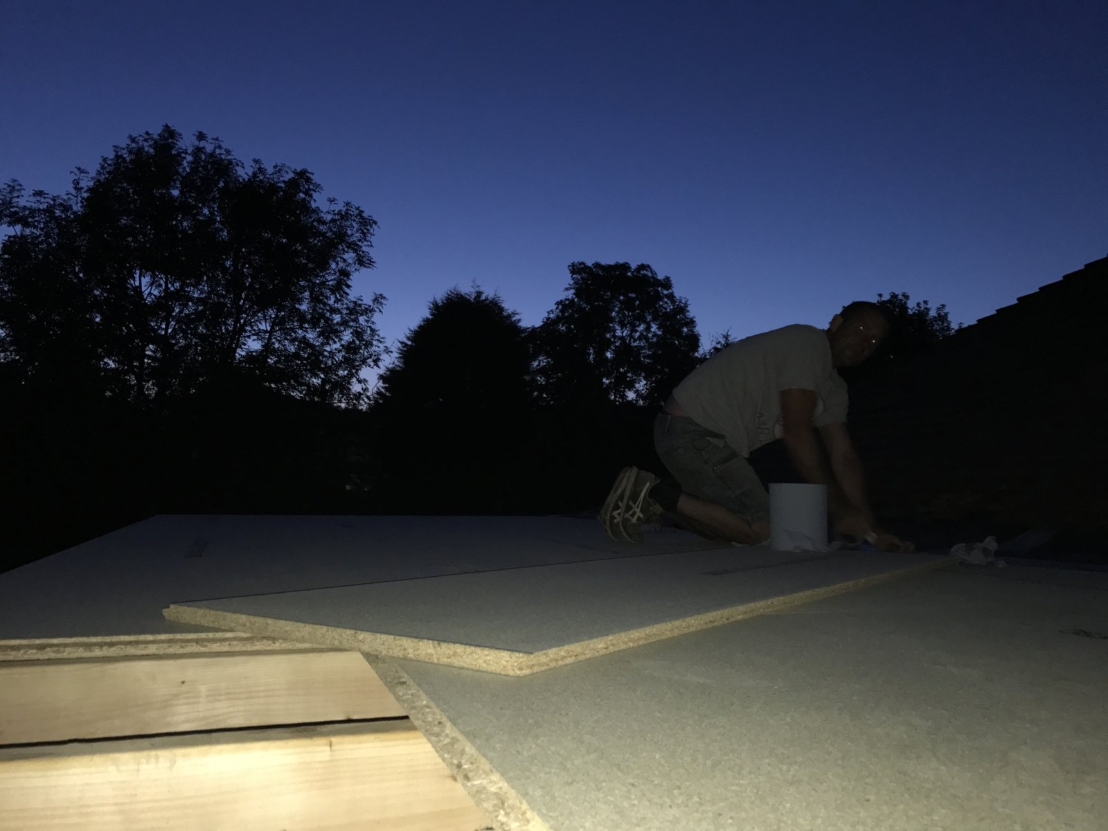

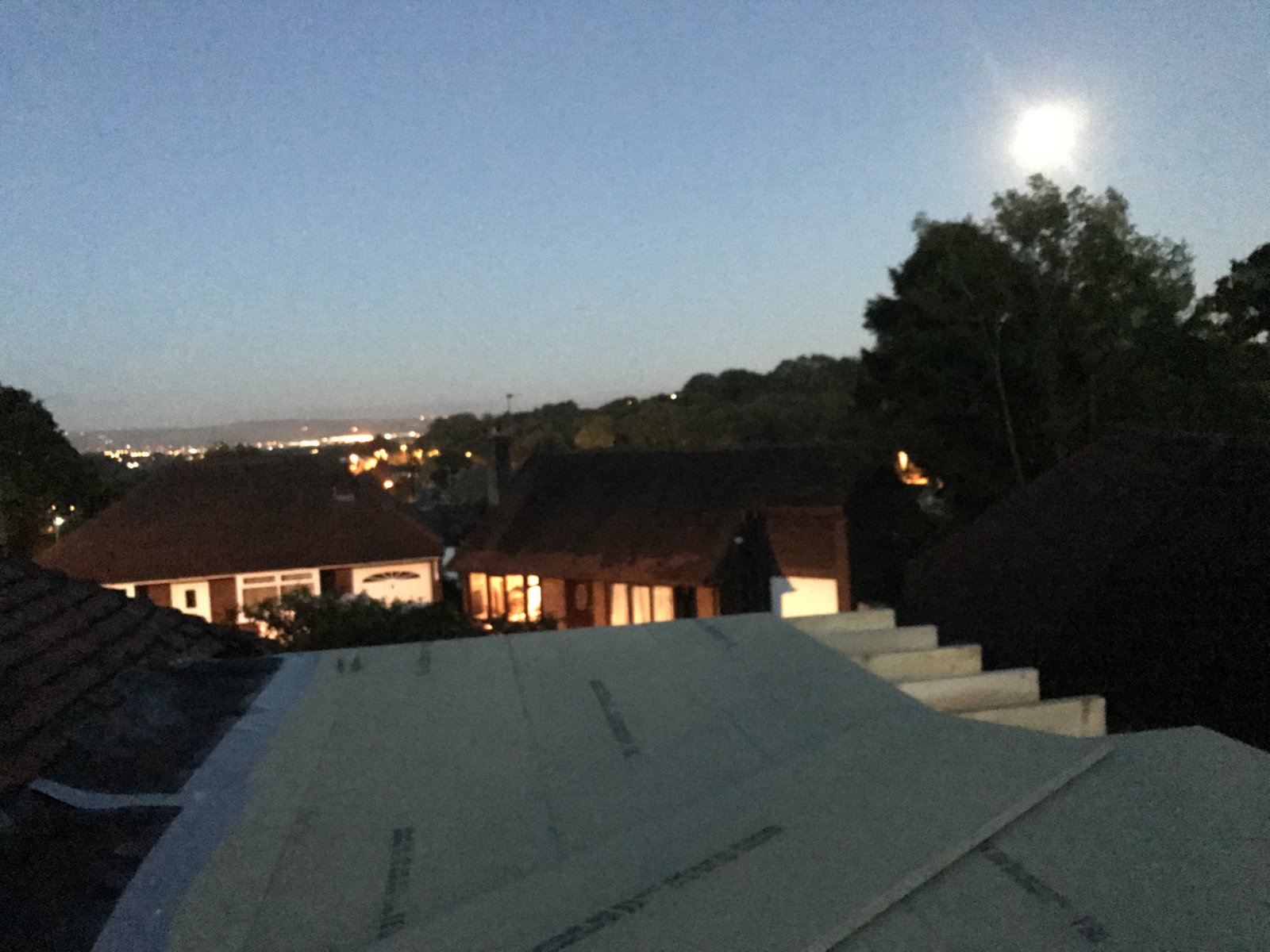

I'm praying for a dry night so I can get it sheeted in the morning. I'm going to Visqueen it and drape a tarp over the top to make use of the eyelets.
Coule of picks for you all to laugh at, yes I do do everything backwards :
Not yet, it's a Dutch end so I need to go another 3 blocks up.
if you were nailing that down when it was that dark, your neighbours must really love you!
