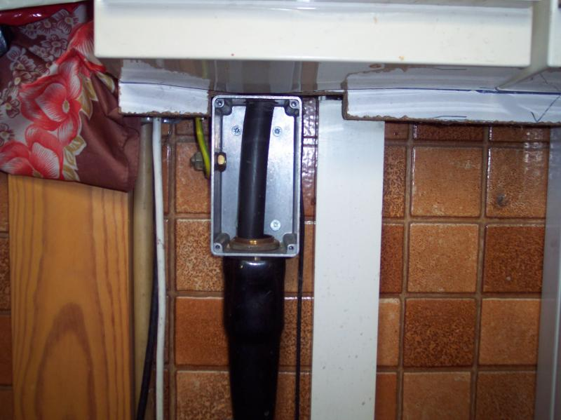

I think we both misinterpreted/misunderstood. I didn't realise you were talking about an existing 'busy' CU - and was merely trying to say that it is much easier to make holes (for anything) before it is populated and wired.
Plastic CUs were/are sometimes rather flimsy (or otherwise not really suitable/ideal) for SWA glands, so it was not a bad idea to do much as you suggest, glanding the SWA into a small metal box which was right up against the CU, and taking the cores of the SWA (and it's 'inner sheathing') through into the CU - if he sees this bernard may well wheel out his standard photo of this!
You can still do the same with a metal CU, but it is then more possible that one could reasonably gland the SWA straight into the CU, hence not needing the box.
If, because the other end of the cable is not connected to anything (merely protected from water/moisture ingress), you don't want the cable energised at the moment, you don't have to connect the cores of the SWA to anything in the CU at this time - merely do something with them to 'make them safe'.
Kind Regards, John
Steel armouring glanded to the bottom of the box, the cores and inner sheath taken into the CU.
In this case the SWA was the incoming sub main bringing the suppply to the CU
I should have fitted a grommet in the top hole to protect the inner sheath.
