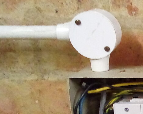

I think we both misinterpreted/misunderstood. I didn't realise you were talking about an existing 'busy' CU - and was merely trying to say that it is much easier to make holes (for anything) before it is populated and wired.
Plastic CUs were/are sometimes rather flimsy (or otherwise not really suitable/ideal) for SWA glands, so it was not a bad idea to do much as you suggest, glanding the SWA into a small metal box which was right up against the CU, and taking the cores of the SWA (and it's 'inner sheathing') through into the CU - if he sees this bernard may well wheel out his standard photo of this!
You can still do the same with a metal CU, but it is then more possible that one could reasonably gland the SWA straight into the CU, hence not needing the box.
If, because the other end of the cable is not connected to anything (merely protected from water/moisture ingress), you don't want the cable energised at the moment, you don't have to connect the cores of the SWA to anything in the CU at this time - merely do something with them to 'make them safe'.

I personally dislike an 'additional box', I see no point in introducing the additional work or cost of materials.
Having made that statement there may be situations where the CU and cable don't line up, for example:
This conduit couldn't be mounted any lower, if it were to be a SWA then an add on box would be the accepted solution.
I agree that it's not very 'nice', but, for what it's worth (and presumably like bernard), I'm personally inclined to think that it might be the lesser of evils if the alternative is to attach an SWA gland to a flimsy plastic CU.
I have to admit that in my (very limited) experience, I have never taken SWA all the way to (or very close to) a CU, the transition from T+E to SWA (in some sort of 'box') always having been some appreciable distance from the CU. However, it is clear that, although I have not personally experienced them, there are plenty of situations (e.g. when it is to be buried, particularly if not RCD protected) in which it does need to be SWA all/most the way to the CU.
View attachment 271633 This conduit couldn't be mounted any lower, if it were to be a SWA then an add on box would be the accepted solution.
I presume this was necessary as the SWA could not be bent 90 degrees and glanded to the top of the CU?
Does the conduit going off to the left connect to an adaptable box where the gland is?
