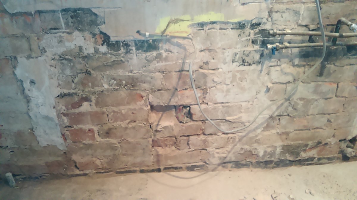

Why not post pics of the walls and floor as things now stand - & pics of the exterior?
Research similar posts on here, and maybe supply further helpful information such as the outside ground level, and what kind of walls you have etc?
I'd find it impossible to accurately help you without quite a bit more information.

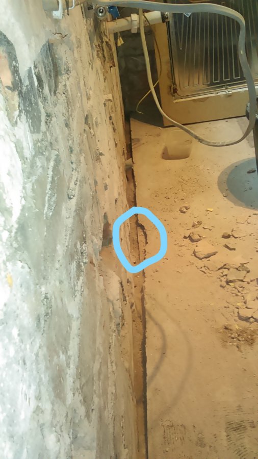

On further investigation, I've found that previous owners concreted over some of the quarry tiles towards the end of the house, probably to level the floor - photo of that area is attached, and a view of that area from above with quarry tile edge sticking out circled. This area was tiled down to the floor.(Someone also clipped cables through the middle of a gas pipe - yes, really - so you get a feeling for what I'm dealing with here!) IMAG0756.jpg IMAG0758_LI.jpg
The gap is merely the difference between the quarry tiles and screed, and the sub-floor and wall.

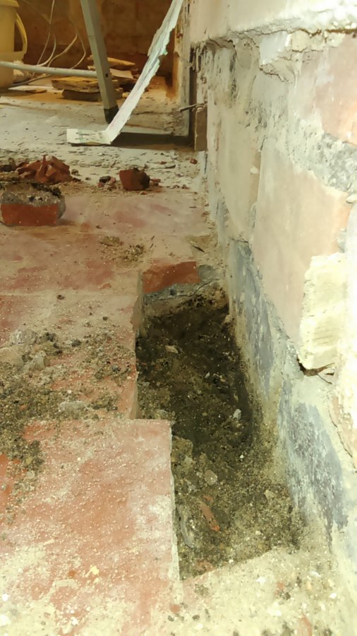

Where is the quarry tile over earth - please show earth?
The blue brick course is your DPC.

Re the floor, there's no rendering outside and the damp in the gaps between walls and floor is against internal and external walls alike. Photo of tiles on the earth is attached; tiles are on 1" or so of mortar and the earth is directly below the mortar. Hope this gives sufficient info to help people to advise.

My original suggestion for lifting & replacing the whole floor still stands.
The wood skirting plugs in the walls should also be removed.
Rotten skirting would suggest that rising damp might be by-passing the blue brick DPC course.
FWIW: you might try injecting Dryzone into the blue brick perps and beds.
