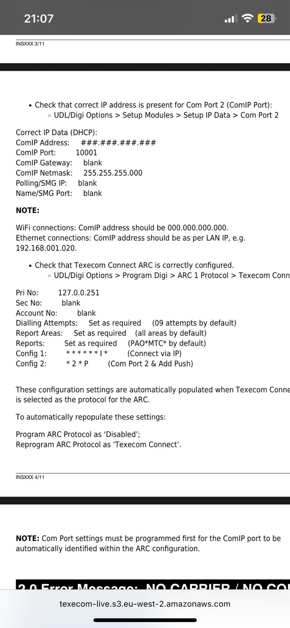

Texeom Elite 24 V6
Smartcom V3 WiFi Module
Set up system and hanging on Modem is online when generating app code
Wifi is connected
Followed texecom guide for set up including comport 1&2, UDL Password, Digi Set up for Comport
Tried to reset Digi and reboot panel and smartcom still same issue
Any help appreciated
Where is the 4 wire lead going to on the elite 24 and where is the two wire lead going to?
so in comport set up do you have com1 set up as smart com and com2 as com ip, its a bit of a stretch on the 24 if I recall correctly the positions of com 1 and com2.
yes to both and yeah com 1 middle of panel and com 2 right hand side of panel

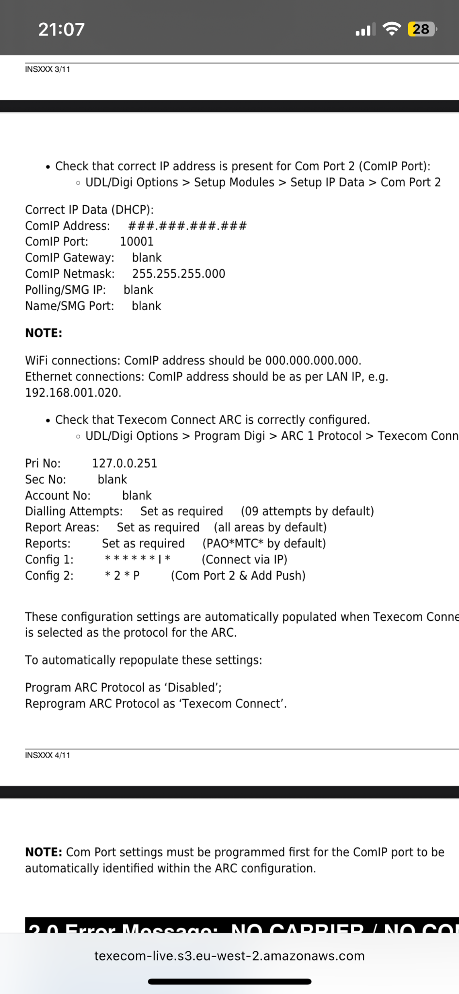

set up as per below image

Apologies but this may sound rude, you think you have it setup that way.
It’s clear the smart com is connected from what you have said.
So if the comports are correct and the program did go correct you can go and turn it all back off.
Unplug smart com wait 20 seconds, plug it back in and program back up and then attempt to generate the app code

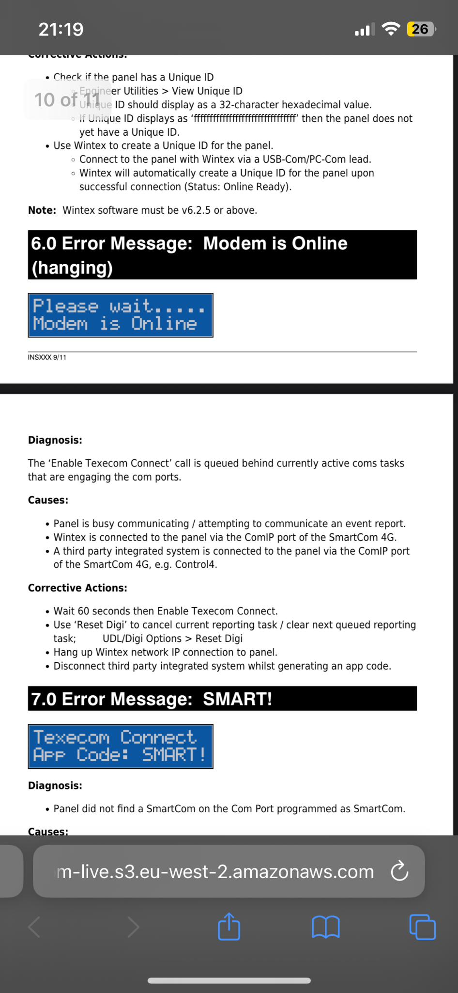

yeah iv done that i wiped the programming including defaulting the smartcom
set up again as per texecom guide
if you get this issue texecom says to do the attached but still get the same issue, not had chance to call them cause its weekend
