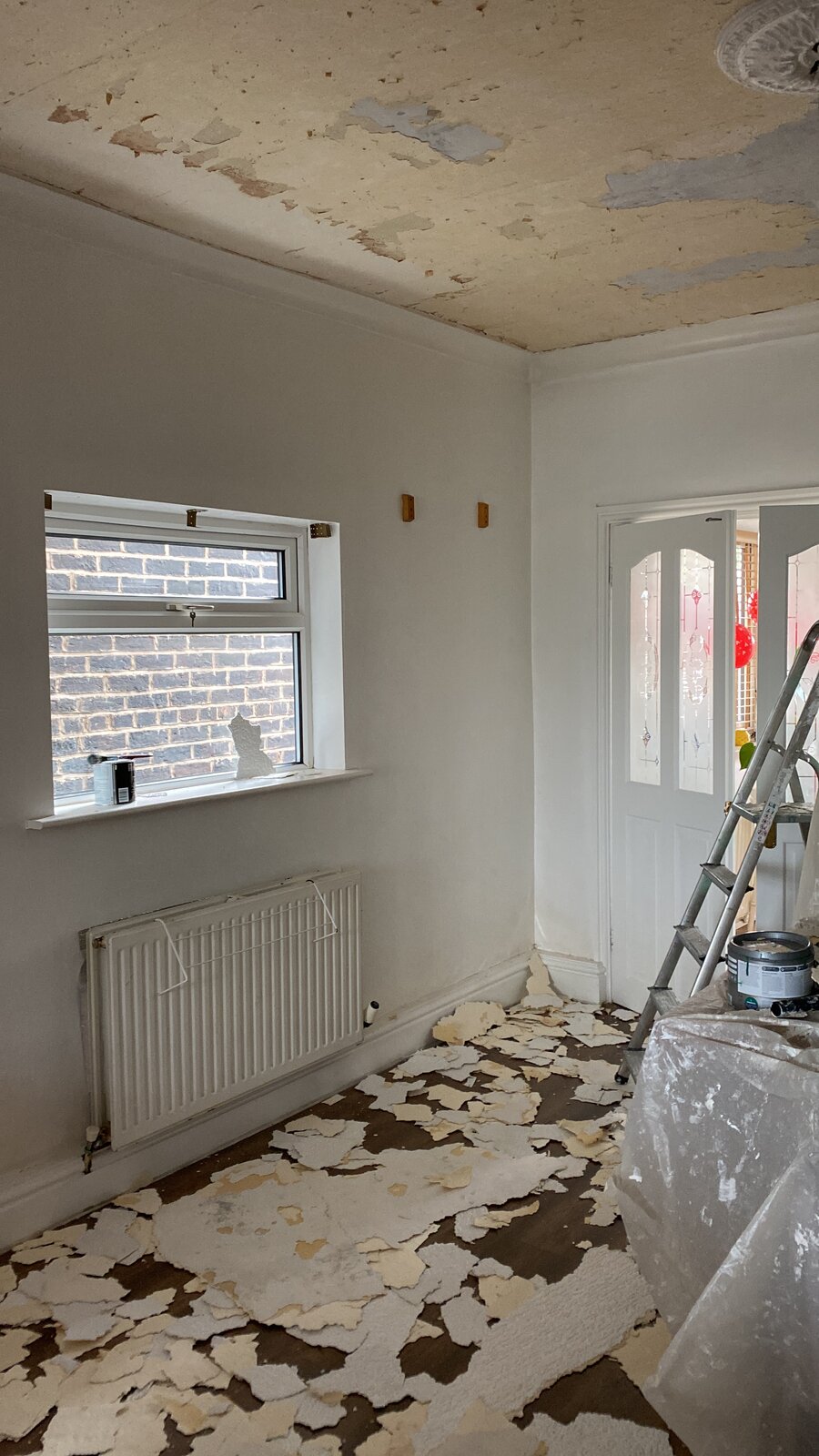

I was wondering if there was anyone with experience of telling the difference between Artex and textured paint?
When striping the ceiling the yellow textured coat under the was quite hard to get off, if I used the steamer on it it'd be quite rubbery, but a little easier to remove. It was very thin, perhaps 2mm max, more like 1mm.
The white top layer which I think is blown vinyl came off quite brittle and sharp in good sizes. It didn’t require any steaming really, peeled off really nicely. It’s then the yellow layer.
That came off quite like vinyl, sticky and tough to scrape, had to steam it a lot.
Please see photos and let me know your thoughts
many thanks in advance

It looks to me like a lime plaster ceiling, so the oldest coatings were probably whitewash or distemper, and need to be cleaned away before you redecorate.
It is a lot less cracked than usual, though.
It looks like a lot of yours will scrape off dry, but the glue in distemper dissolves in very hot water, but resists cold.

Yes, my main concern is the yellow textured layer and whether it is artex. It's a very thin layer of so, I had no idea about the possible asbestos content.
I mean what's done is done and I've cleaned up, so I'm just trying to gauge some professional opinions from sight. The photos aren't great either unfortunately, but it's all I've had as I took them half way through the job and have since plastered over them

The yellow layer just looks like a thick old water paint to me, with a lot of ground chalk in it. Are you sure it isn't painted paper? See if it breaks down in cold water, boiling water, or vinegar
I think Artex arrived in the 1970's, so the oldest paint will be whitewash or distemper.
Thank you for taking the time to reply. It could quite possibly be textured paint. It came off almost like gloss paint. Quite plasticky
Paper then polytex over white wash.
That's polytex your asking about. Rolled on.
I sand white wash off (distemper) you can wash white wash off back to plaster then coat ceiling in gardz.
Fill and make good if ceiling is ok.
Polytex never contained asbestos I was told.
No artex on that ceiling
