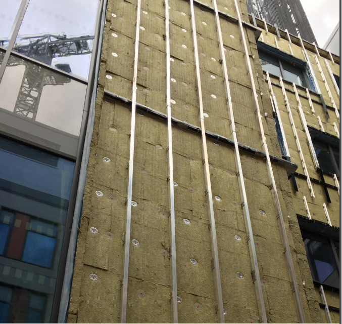

Yes, rockwool with a rendered finish isn't flammable at all and has no cavity. Can even be structural spanning floor to floor.
I was actually thinking about its use in high rise building systems, like Grenfell, rather than a rendering method used on low rise. This sort of building system seems very different to me, and it appears (to my untrained eye) that there is a cavity.
I meant high rise. This one is Structherm structural system, hard render on rockwool, no cavity.
Thank you, this is exactly the sort of thing I wanted to discuss. I couldn't find any reference to it in Rockwool's high rise brochure, they just seem to show the facade solution in my photo.
Do you know how common this is compared to the facade solution?

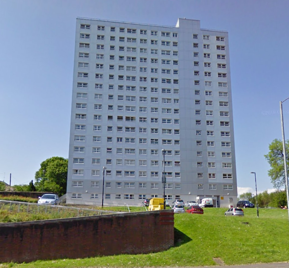

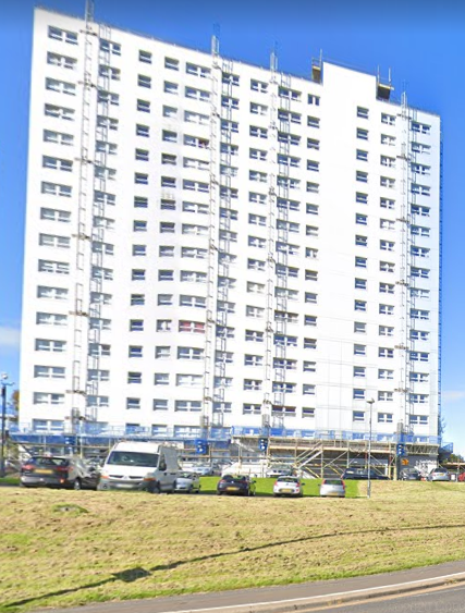

I don't have numbers but it probably changes across the UK. Scotland for example, due to rainfall, has predominantly hard render on insulation, with very little rainscreen facades, especially in social housing.
This one in Glasgow, the only one, used to be a rainscreen facade but was changed to rockwool/hard render following Grenfell.

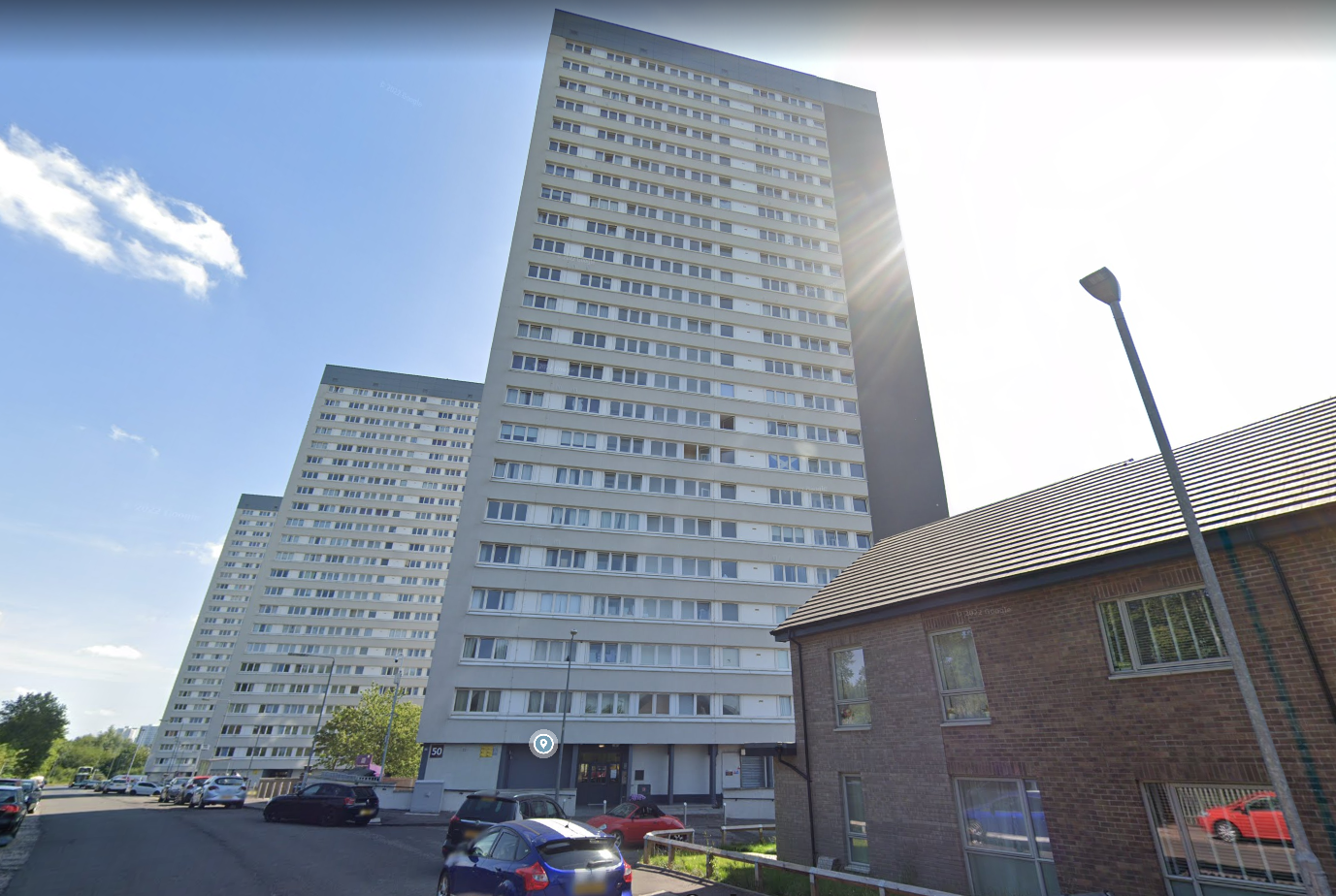

While on the Glasgow theme,
I glanced at your picture while reading the above and thought I saw this...
