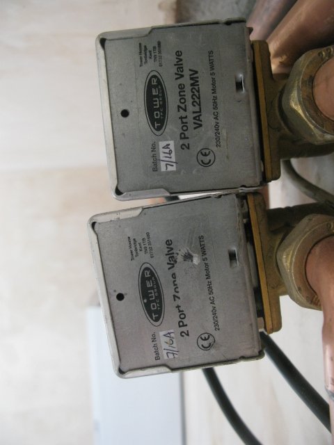

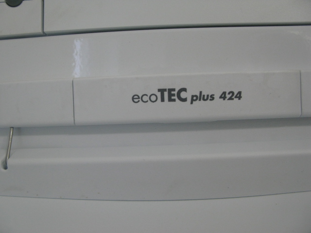

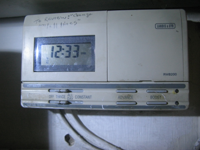

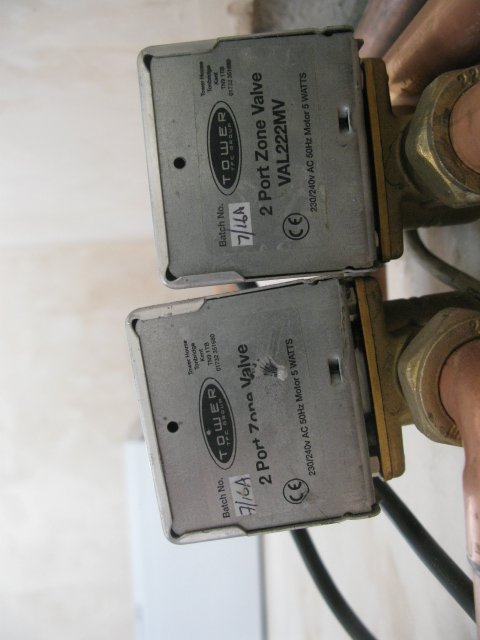

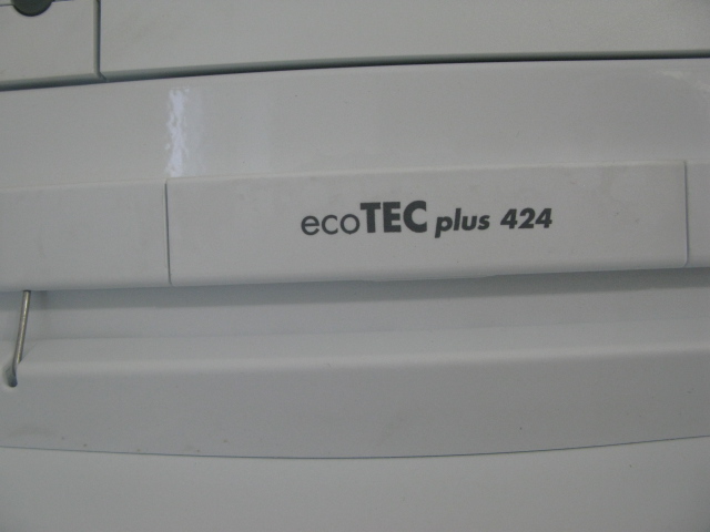

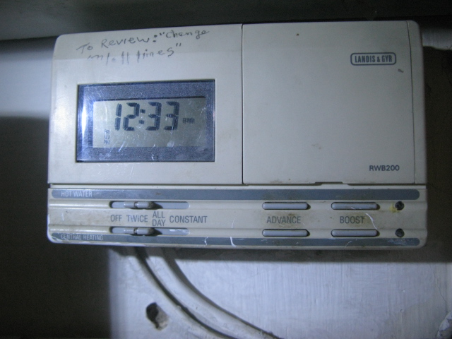

We have just had a new boiler, conventional Valiant and kept the programmer as it works.
The first bit of bad news after installation, is that using the programmer, I could not switch off the rads that came on. I asked the plumber (who I have not used before and is not communicative) if it is possible that new valves could be faulty. He said no, the programmer is at fault but I am wondering why a programmer goes wrong just at the exact time that a new boiler has gone in.
Next at night, I turned the heating right off using the programmer and they came on in the morning.
Is it my programmer and the plumber thinks I am a fool? I probably am but I will be most grateful for your comments.
Regards
Alan
sorry Alan some really good blokes on here but no one is Psychic which Valiant ? Y Plan ? S Plan ? which programmer ? Take pics of your boiler and programmer and valves , usually in the same cupboard or area as your hot water tank and we will be able to advise you
Yes Ian no one is psychic and it made me smile.
Attached are pics and hope they help, the boiler is a 25K. Y or S plan I am sorry I do not know, I am far from having any plumbing knowledge.
Best
