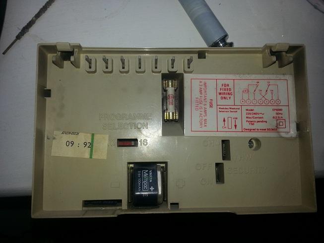

I see a little rectangular slot at the bottom of the 6000, is that something when pushed unclips the programmer? (looks like 6000 seems to be having a cover which looks different from 6002) Posting few pics of my EP 6000.

When you get the new one you'll see how the old one unclips :cool:

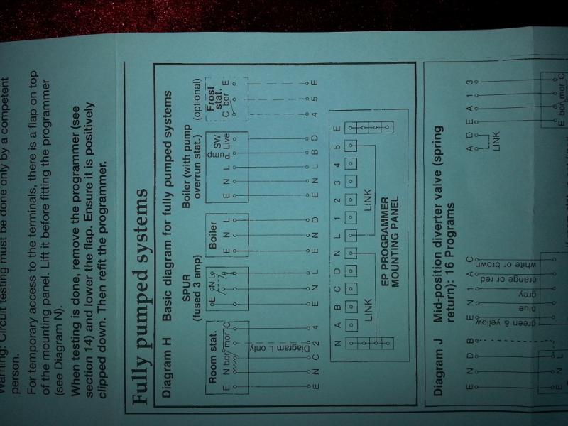

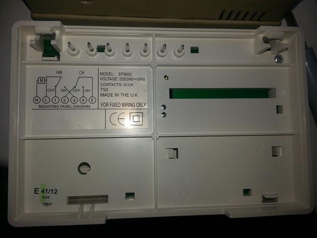

Last quesiton. EP 6000 does have a 3A Spur and battery fitted-in where as EP 6002 doesnt have any spur or battery. Circuit diagram for 6002 shows the spur between N & L.
Was wondering if I want to use already fitted backboard with new EP6002, how would 6002 be a direct replacement for 6000 as its doesnt have the 3A built in spur? Would wiring need redone with 3A spur?
EP6000(back) with spur and battery
EP6002(back)
EP6002 instructions
