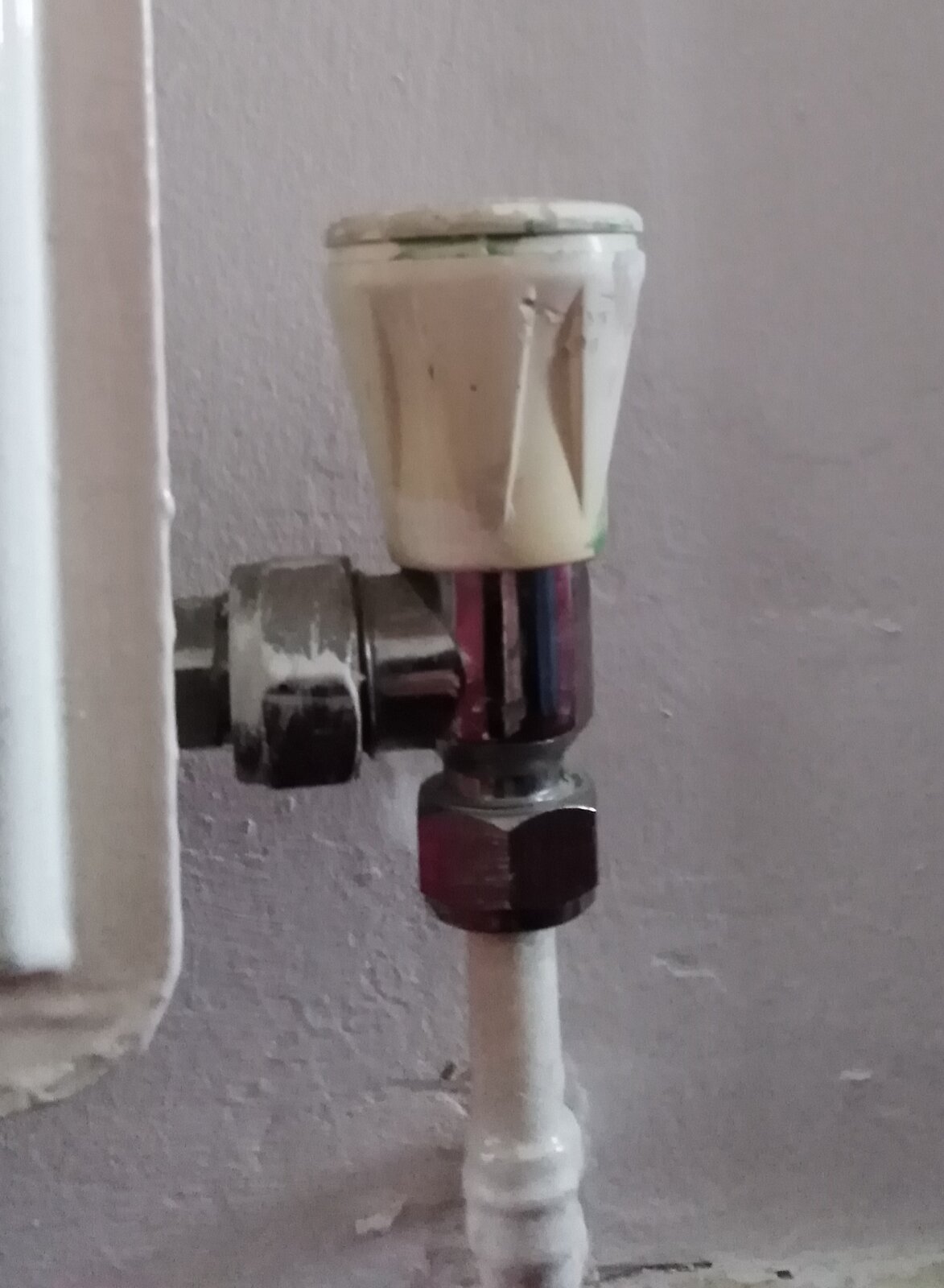

IMG_20200615_153035.jpg Can someone give me a rough idea of replacing these existing radiator valves (10) with thermostatic ones.

Basic unit costs around £6.50, the programmable head around £10 these prices can go up to around a £100 for the pair if you really want to pay that much.
Changing the valves there are a few methods, clearly you want to stop the water damaging the floor, so you could drain down which means new inhibitor or freezer the pipes or work fast and suck up what comes out, if inhibitor added water tends to be clear, but if not it can contain a lot of rust.
I am not a plumber, the last one I wanted to fit was on ground floor carpeted on quarry tiles, I got everything ready, including a Vax carpet cleaner, working fast with lock shield turned off the water radiated about 6 inches from valve and was quickly sucked up by carpet cleaner, but I would not use that method upstairs where getting it wrong could end up with water coming through the ceiling.

Blah blah blah.. It's a pig to fit trvs onto microbore as the copper is soft and invariably leaks. Best thing is to cut back the pipe and use long-tail 8/10 to 15mm endfeed reducers straight into standard 15mm valves. But this depends on you getting all the water out the pipes. Normally it's best to leave well alone.
You can get 10mm native TRV's which will fit your pipework. You may have to remove the old olives and nuts though as the old nuts & threads are invariably different.
Price would really be based on location and system type & materials (inhibitor, type/quality of TRV's, etc) unfortunately nigh impossible to give an estimate on a forum like this, if that's what you are looking for.
