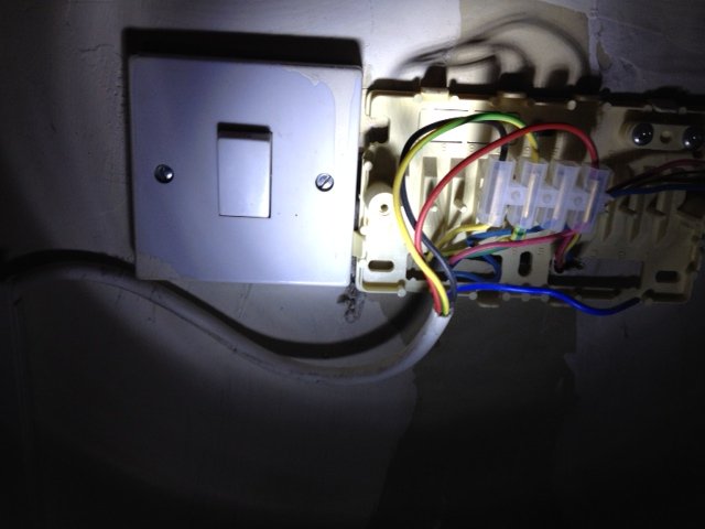

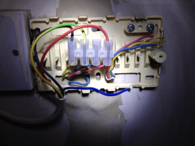

Photos of the airing cupboard and joint box would be useful, this should be a very easy fix, but it depends how your setup is configured.
Thanks Freddo. Apologies for poor quality pics!
So there used to be a boiler mate in here which was removed when i had a combi fitted so I assume the switch on left was for emersion and have never touched it. The box is to the right of it. I see one cable coming in which isn't connected to anything. Then have a cable which goes downstairs to I assume main thermostat or boiler???Thats the one you see going into the top of the joint box, 3 cables and the blue not connected anywhere.
You then have what I assume is 1 cable coming from wall behind the box which is connected to the bottom of the joint box. This has yellow, earth, blue and red connected.
Now again I am assuming the blue on the cable going downstairs connected to top of joint box which isn't connected to anything has never been connected? It hasn't been touched although the cable may of been knocked? The screw is open at top and doesn't look to of broken off.

There doesn't seem to be much there, where are the valve(s) for the 2 heating zones? I want to see the valve wiring. What programmer do you have?
