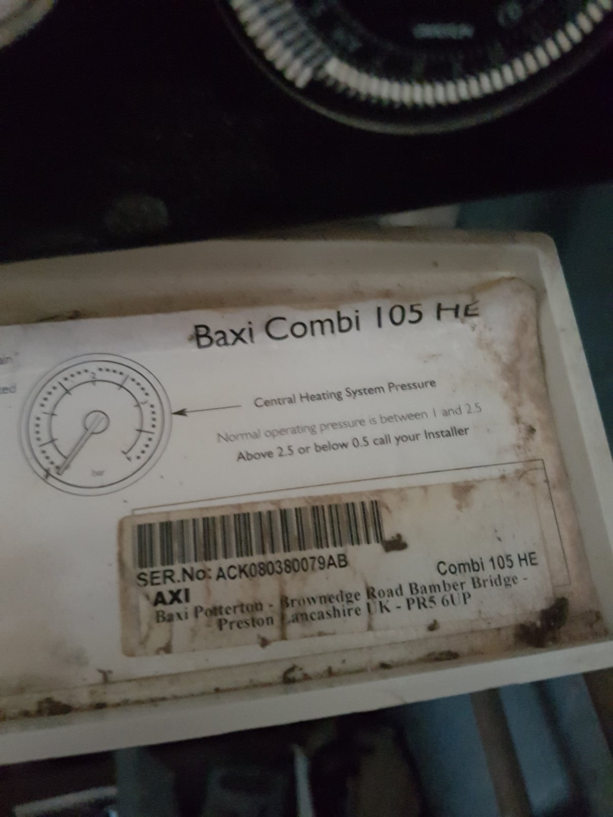

Model is baxi combi 105 HE

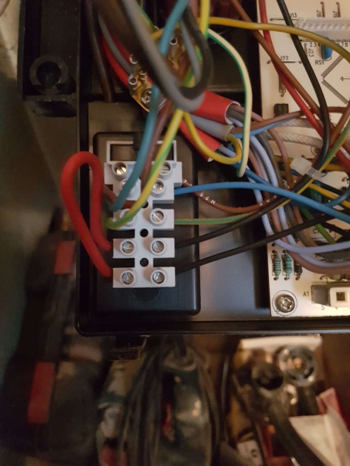

Look at the manual on page 31 is the schematic of the terminal block, remove the link wire between terminal 1 & 2 hopefully everything will then work correctly.

That red wire is the link which should be removed when external controls are fitted so yours must have been done some other way, remove it and see what happens.
So remove that and put it back together and all should be ok fingers crossed
You would expect a wire from boiler terminal 1 to the COM on receiver and a wire linking boiler terminal 2 to ON on receiver. Really cant understand how it ever cut off with that link left in. Good luck
Ive done that now the flame symbol is coming on thermostat but the boiler is now not firing up ???
Sorry looks like you need an electrican, put that link back in a use it as before
