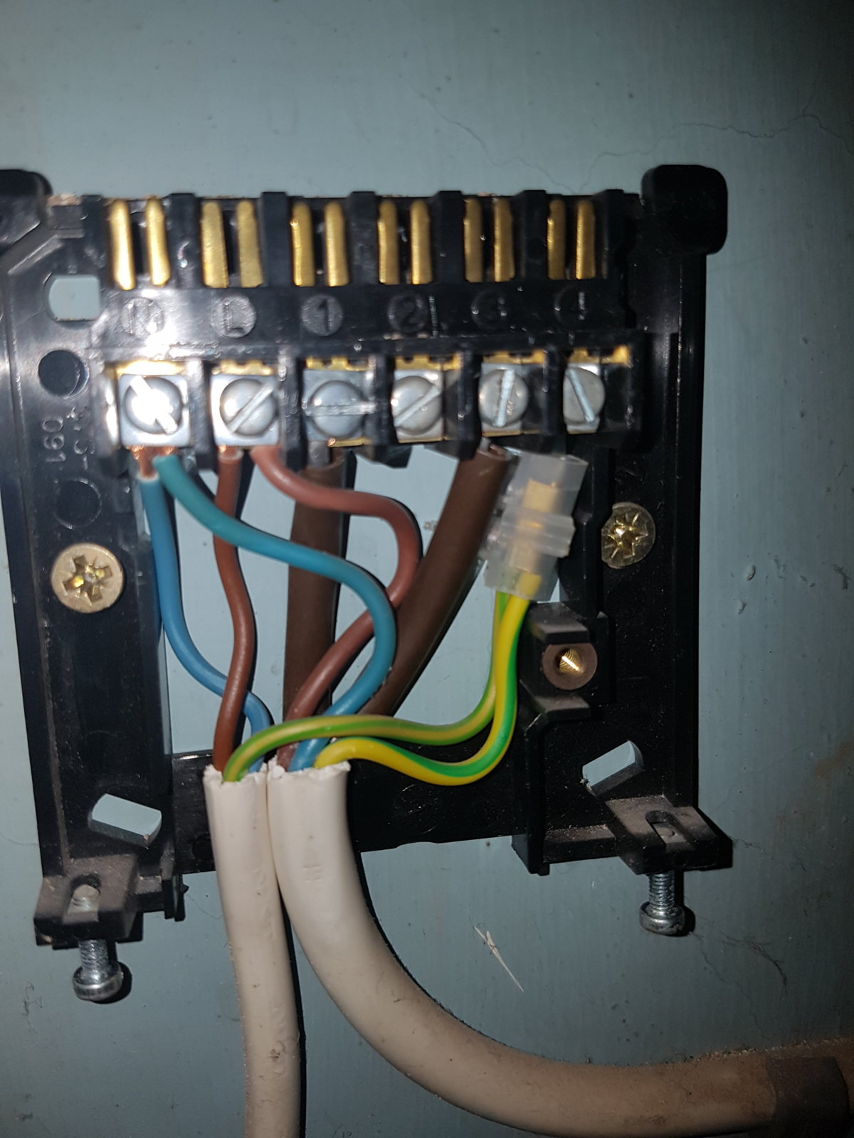

I have a baxi boiler, for 2 years ive not had a thermostat and worked the heating with the mechanical timer, ive now got a new born premature baby, so i have to keep the room temp at around 18'c, ive brought a epi esterfw thermostat and receiver wired it correctly and its paired with each other but it wont work the boiler, the boiler is on and thermostat works and the light comes on, on the receiver, but the boiler just carries on past the desired temp, ive tried another new thermostat and receiver and it would just do the same, ive also tried swapping wires around but still same, can anybody help

Post a picture of the boiler wiring, did you take the link out when you connected the thermostat ?
Link ?

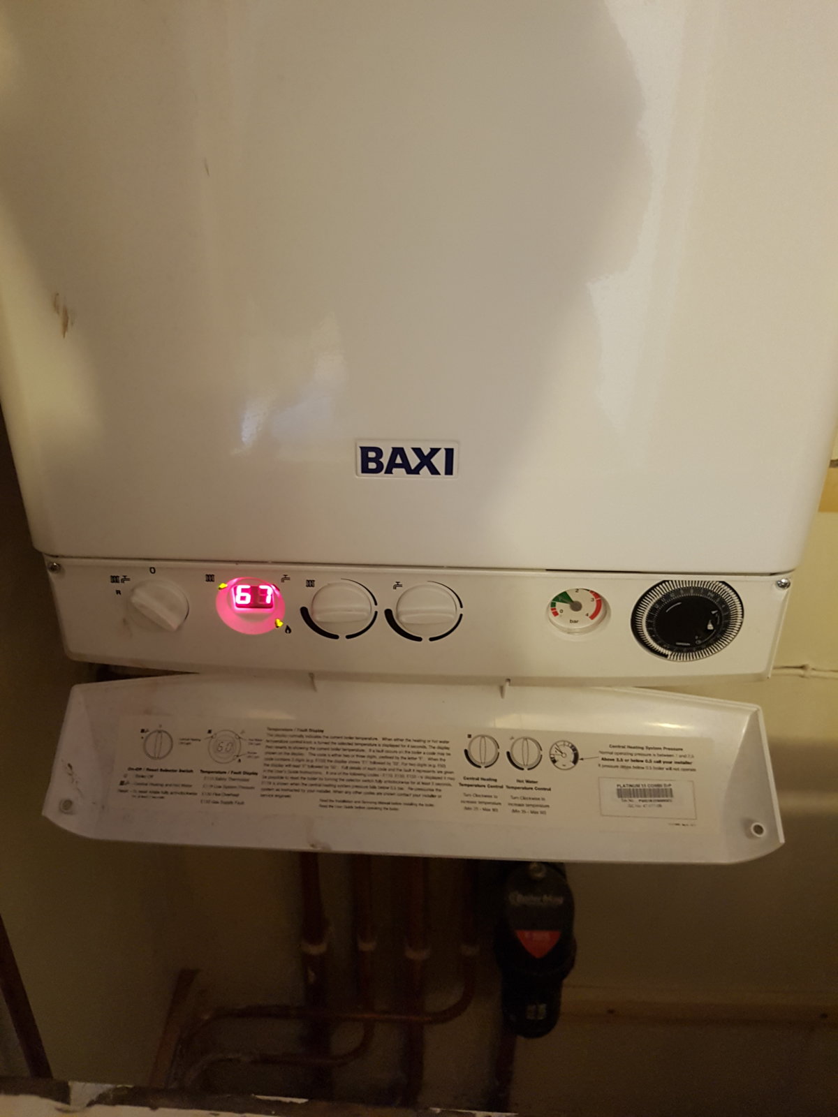

What model is your Baxi? That picture you posted is the backplate used on several makes of programmers/timers so give a clue what make & model do you have?
Ill be home in next hour i will find out for you guys, where will it tell me whst model it is ??? It is a combi, its nearly same as this 1 but its not got the digital display if that helps
