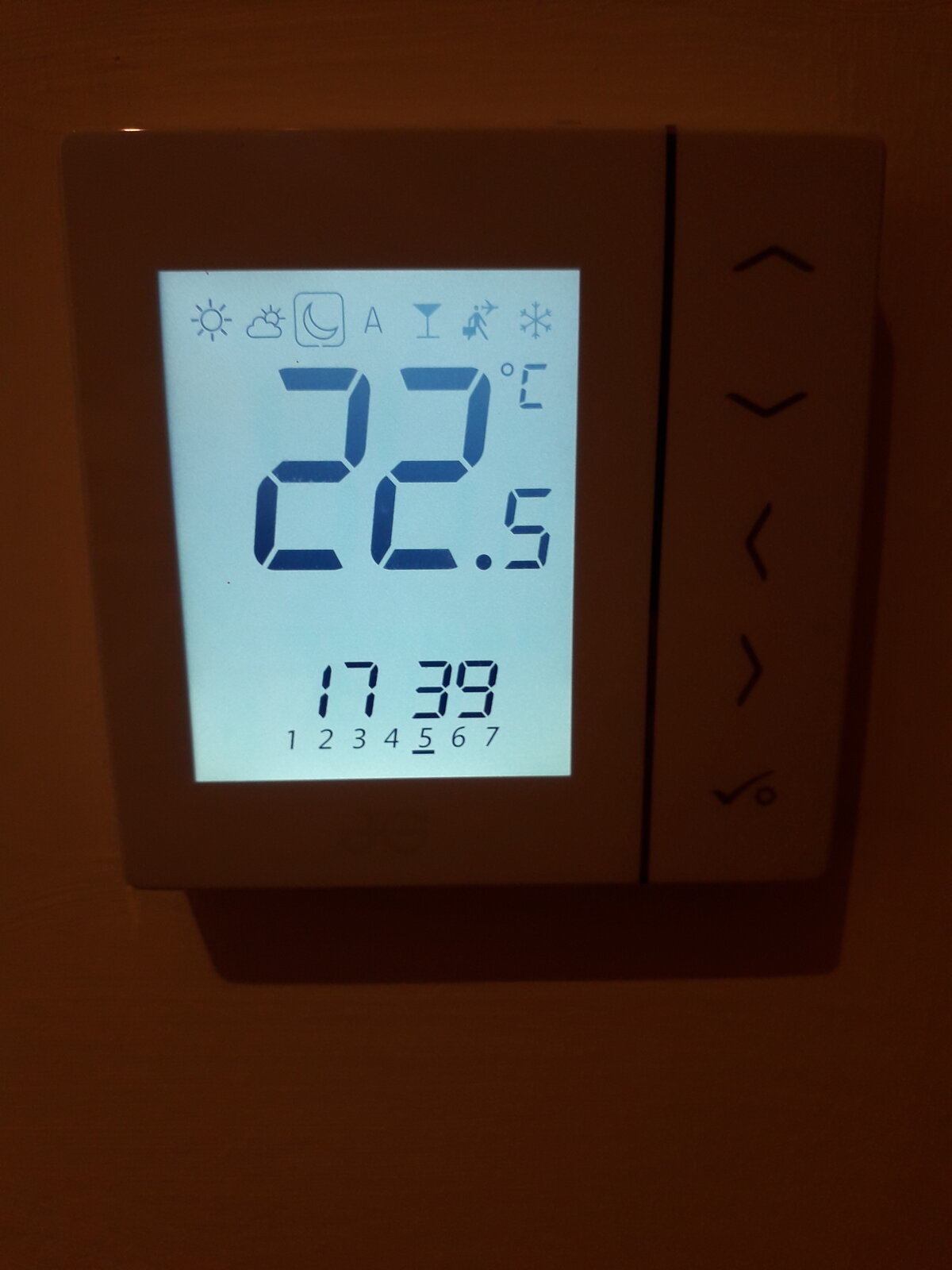

I moved into my new house recently to find the downstairs underfloor heating temp (gas boiler, not electric) is controlled by four “nightmare” thermostats in lounge, kitchen, hall and utility room. (See photo). I've had several attempts to program them, but can't get my head around setting temperatures for the SEVEN different time zones plus all the other variables I need to consider. They are just far too sophisticated for my requirements.
So I want to replace them all with simple dial-controlled stats in each of the rooms.
Questions:
(a) Can they simply be replaced with "ordinary" stats, or does underfloor heating make it more complex?
(b) Is it a DIY job or should I get a qualified electrician?

In the main wet underfloor heating has the max water temperature controlled by a thermostat on the manifold, so any wall thermostat will do.
But it depends on the manifold, there may be some where they do use under floor sensors.

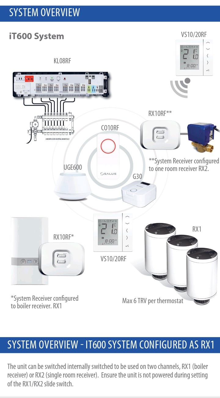

It's difficult to tell from one picture, what system you actually have - Google suggests it may be part of the Salus iT600 system:
If it is, the system is quite complex, and could include a manifold, receivers and underfloor sensors.
Replacements with simple dial 'stats may not be simple.
On the other hand, it is possible that your system has an App, and this could hugely simplify the programming of the separate thermostats.
I'm afraid you may need to do some more investigations to find exactly what system and components you have.

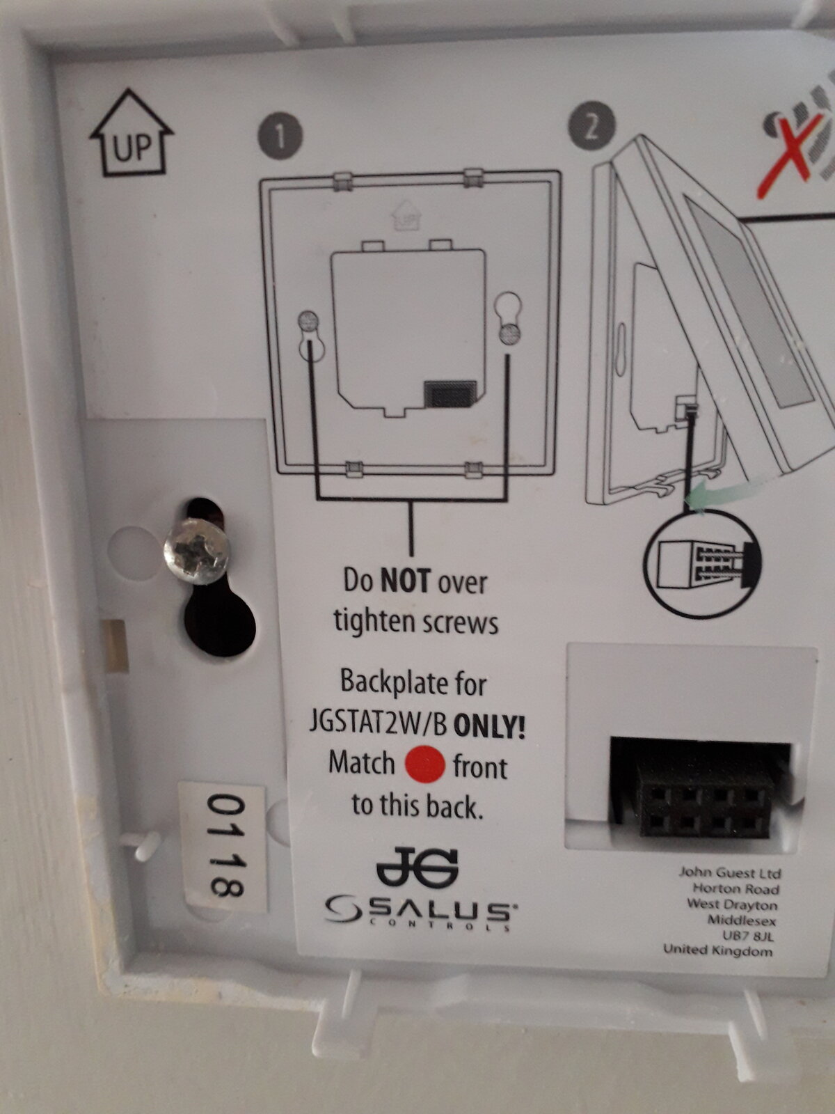

I took the front cover off and googled JGSTAT2W/B and it seems like it's a wired stat
Ok, that's slightly easier then.
Link to the manual:

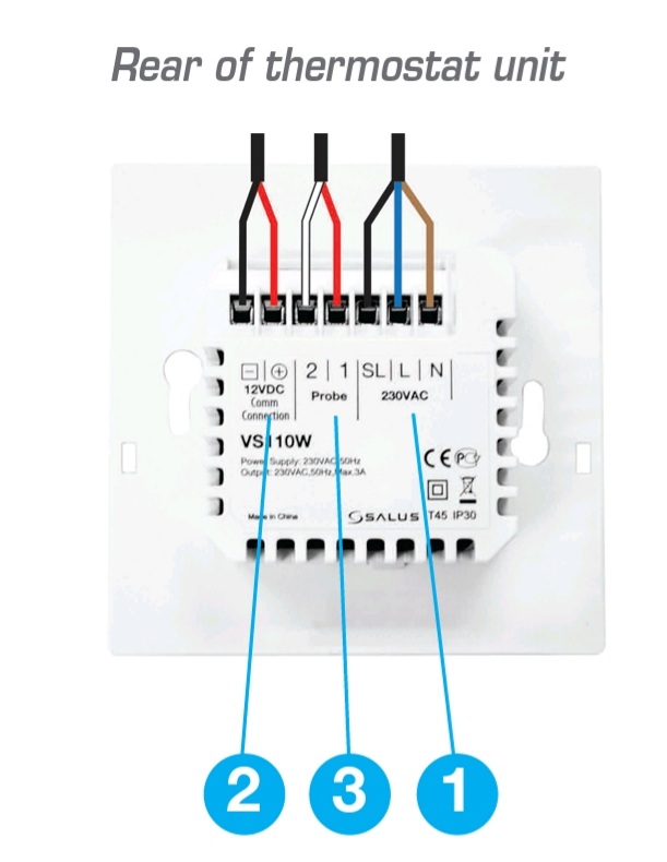

Can you see what wires you have connected? There could be communication wires and sensor wires..
If you have the communication wires, the 4 stats can be set as a group, which would make programming more straightforward.
Alternatively, the JG dial thermostat would be a suitable replacement:
It has both the communication terminals and the sensor terminals, that a more standard 'stat wouldn't.

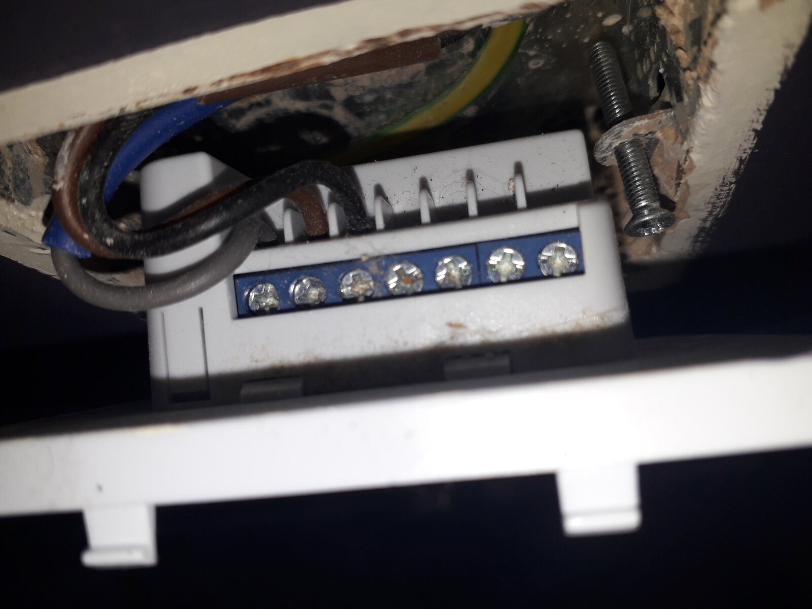

Here's the wiring - black brown and grey. Looks simple!
Good!
It would appear grey is neutral, brown is live and black is switched live - at least on this thermostat! (Check the markings when you take the stat off).
Now find yourself a simple dial 'stat!
