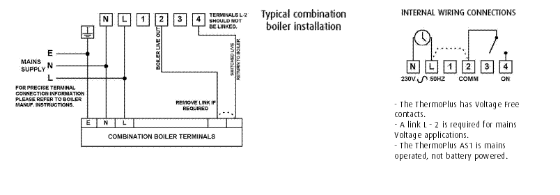

Maybe I'm misinterpreting the instructions, but to me this appears to be a contradiction.
The internal wiring diagram for the Horstmann Thermoplus AS1 states that "A link L - 2 is required for mains Voltage applications", while the other wiring diagram states that "Terminals L - 2 should not be linked"?
It depends on your boiler. The thermostat is what is called volt free that means the switching contacts and the supply contacts are independent. Where it is used to replace a thermostat which switched the 230 volt supply the link may be required. Where the boiler used a 24 volt control voltage the link would damage the boiler.

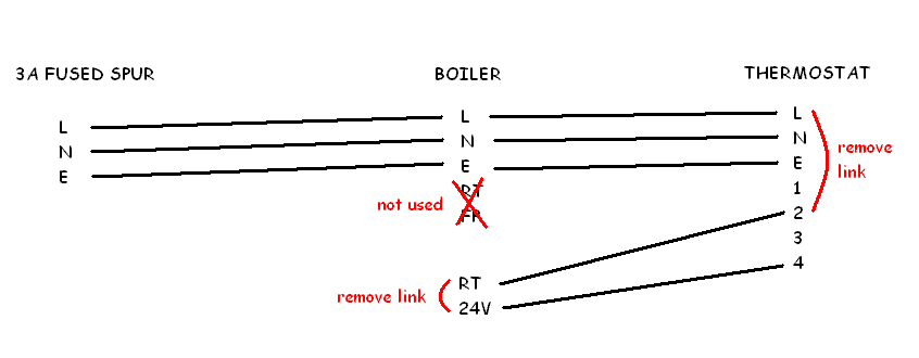

OK, that makes sense. Where I'm still a bit confused in applying that to what we have. The thermostat is mains powered (230V) but volt free? So does that mean using the mains supply the thermostat's mains supply connections, and the boiler's 24V connectors for the thermostat's comms connections? (Whilst removing any links between the 230V and 24V)
Basically, this:

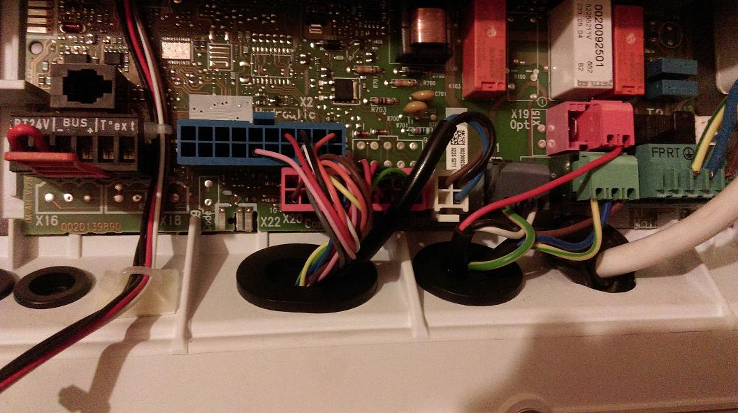

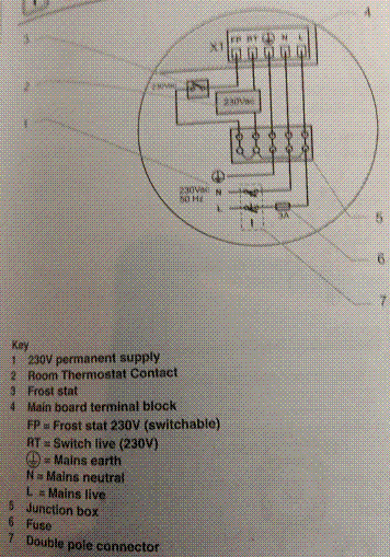

Boiler is Heatline Capriz 24a. Wiring diagrams below.
Boiler Supply
230V System Controls - NOT USED
External Accessories
Yes, 'volt free' is a misleading term meaning the thermostat contacts are not connected to 240V supply - unless you connect them.
This means it can be used for 240V or 24V.
I think so - a bit unclear.
To use the boiler's 24V you must connect the 24V terminals to the volt free terminals. Remove links.
As per your diagram.
Got it.
The wording wasn't very clear. So the thermostat is volt-free, but can alternatively be used for 240V switching if putting the L-2 link in (which would not be the intended use with our boiler).
I was going to use two T&Es for the wiring. The one being used for the 24V connections will have an unnecessary earth wire. Should I still go and connect that across to the boiler and thermostat's earth connectors?
Yes, connect the earths.
However, (I don't know the layout, but) if the cable is not to be clipped to the wall, i.e hanging loose, flex would be better.
