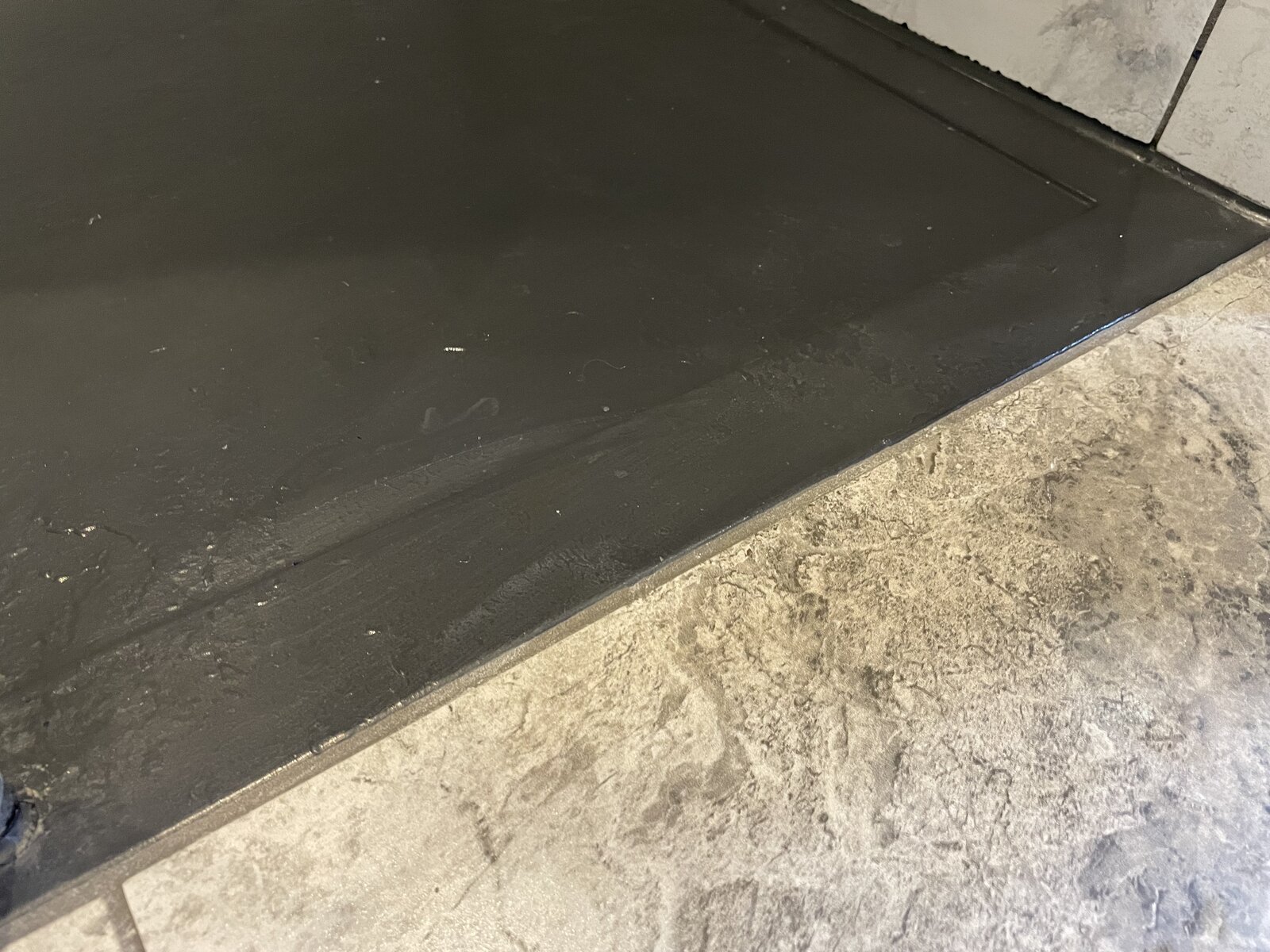

Yeah +1 with @dilalio - if you are looking for a floor level tray, tray height dependent, then that's what I did for my own en-suite tray. To allow it to end up level with the finished floor, (10mm tile with ditra matting, mesh UFH and a 4mm adhesive layer), the original P5 floor was cut out, dwangs installed and then 22mm OSB was installed and area was then fully tanked.
Ended up like this
Ended up like this
