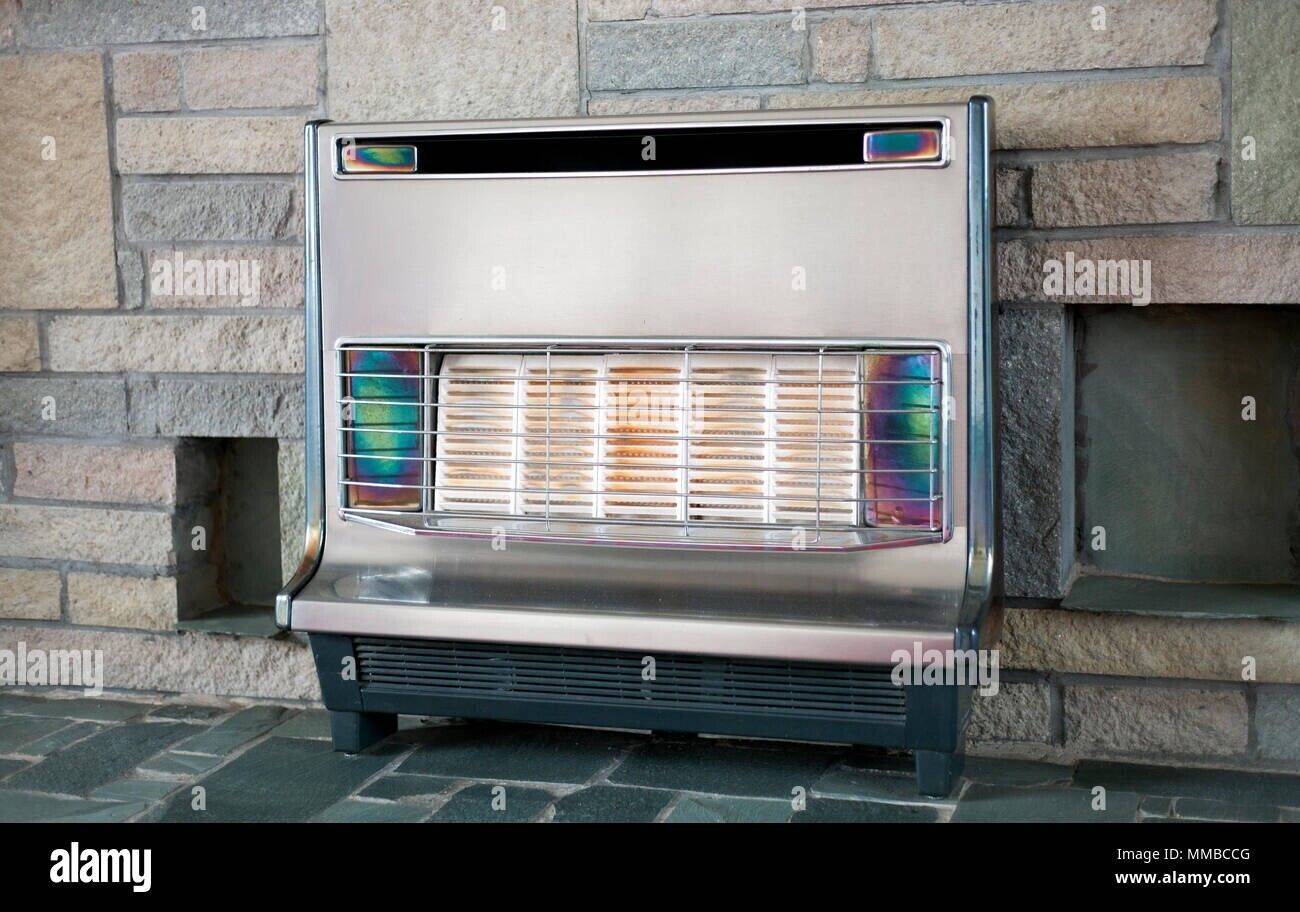

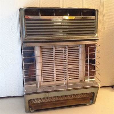

Not something I've knowingly encountered, Historically certainly not used for gas fires which simply stood on the hearth, snugged back against the tiled surround. But of course not something I have encountered in recent times since regulations changed.

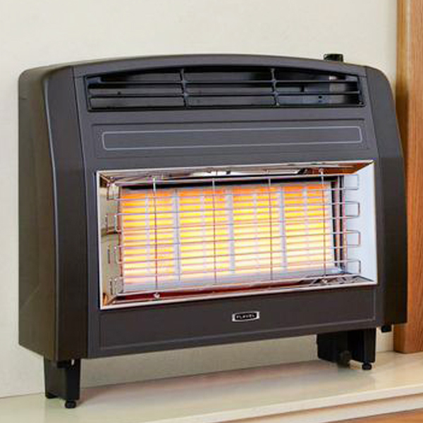

Our gas fire, is of the same style, and is screwed back to the wall/ hangs on the wall.
