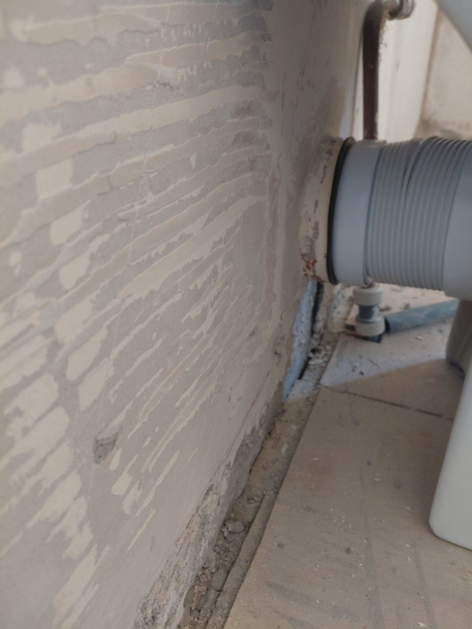

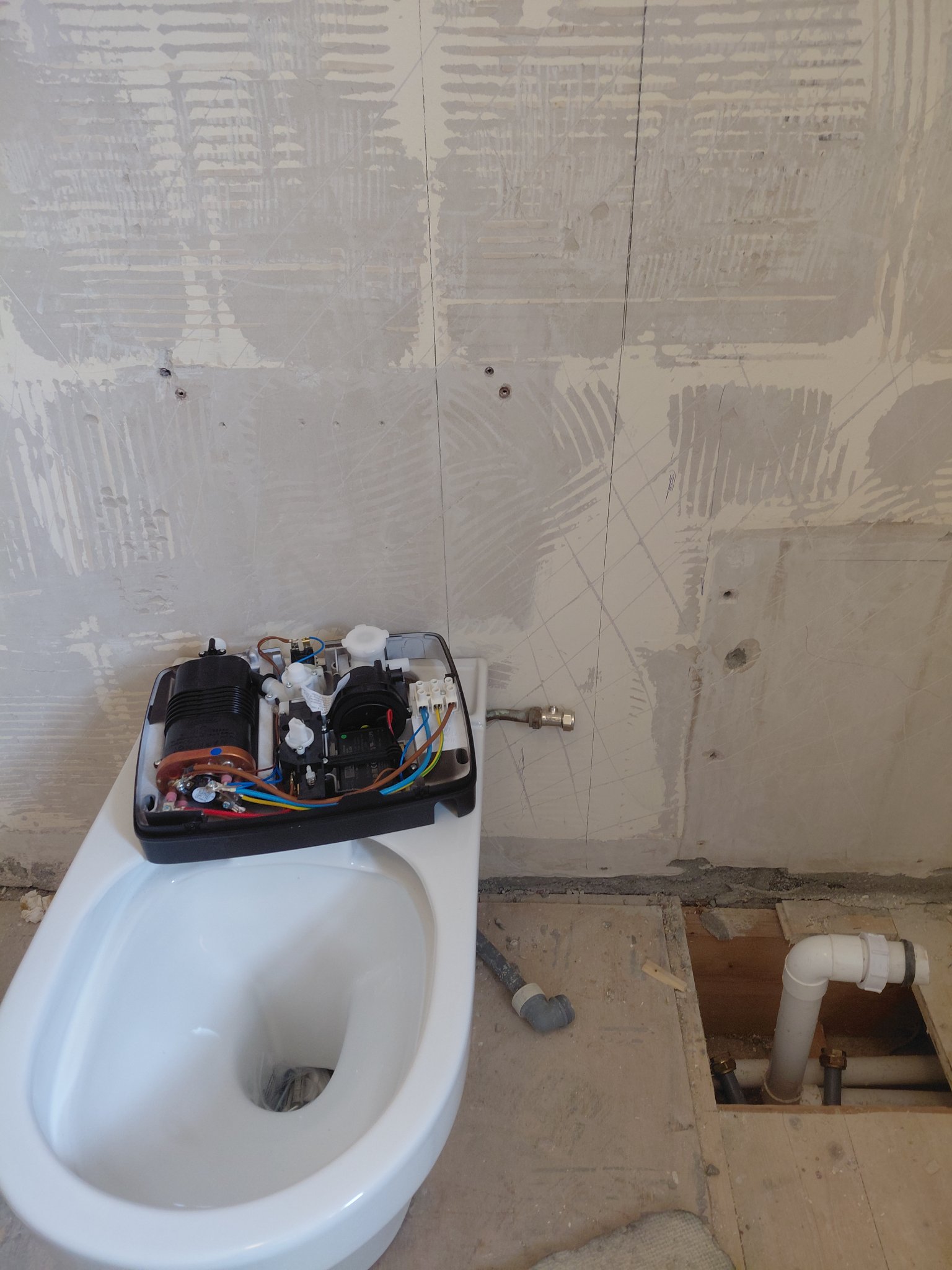

Tight spot with toilet flexi in my sisters house. Any suggestings on how to get around it.
Originally there was a bath besides this toliet but now a 1200x800 shower and screen going in which if the toilet goes back in original place where the waste pipe is drilled through the wall, its very tight against the sceeen if one was to sit on the toilet.

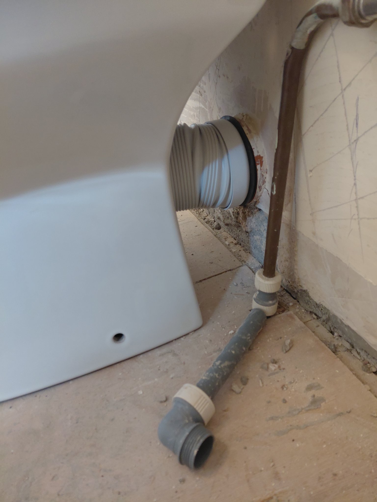

Bought a flexi but its very tight kink on it and the toilet not going right back to the wall without the kink and dont think itll seal properly.
1/2 inch pipe still needs tidyed up
Thoughts

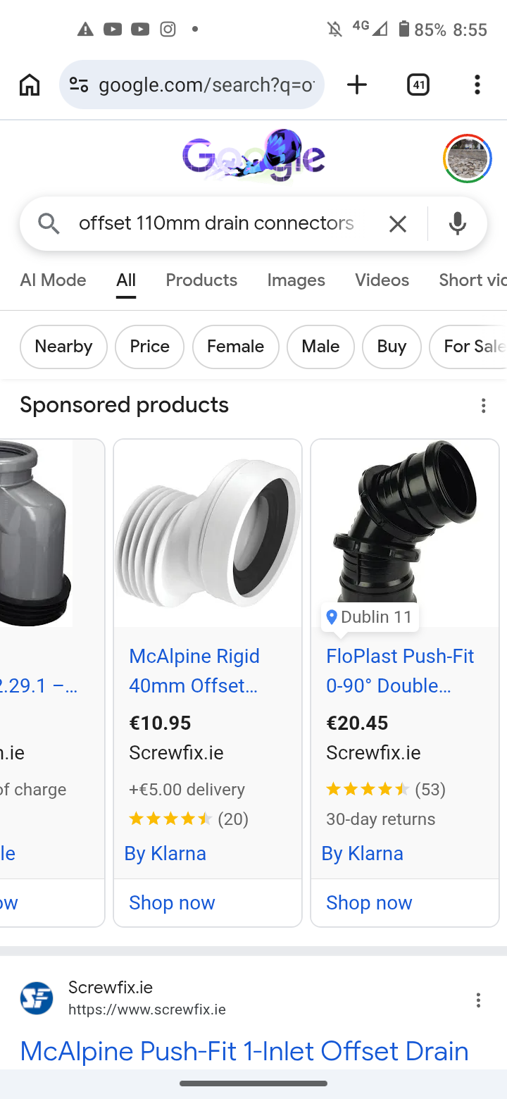

One or two offset 110mm drain connectors. Place on inside the other to move sideways.

Looks ok seal wise, but would be better suited to rigid fittings.

Discussed this but doesn't want it boxed in. I could even drill a new hole through the wall and connect into soil pipe but trying get out of it with less work.
Would I get away with using two of these or one and the flexi I have.
Is this the fitting your on about?
