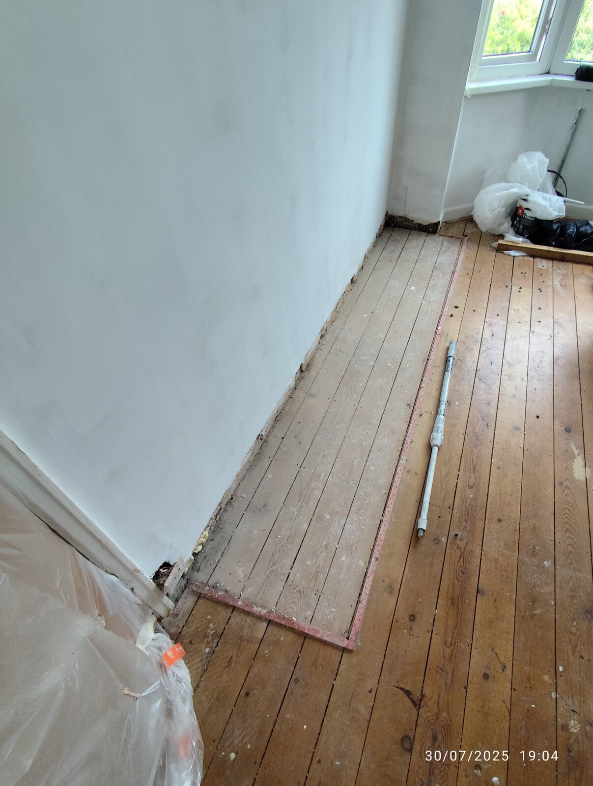

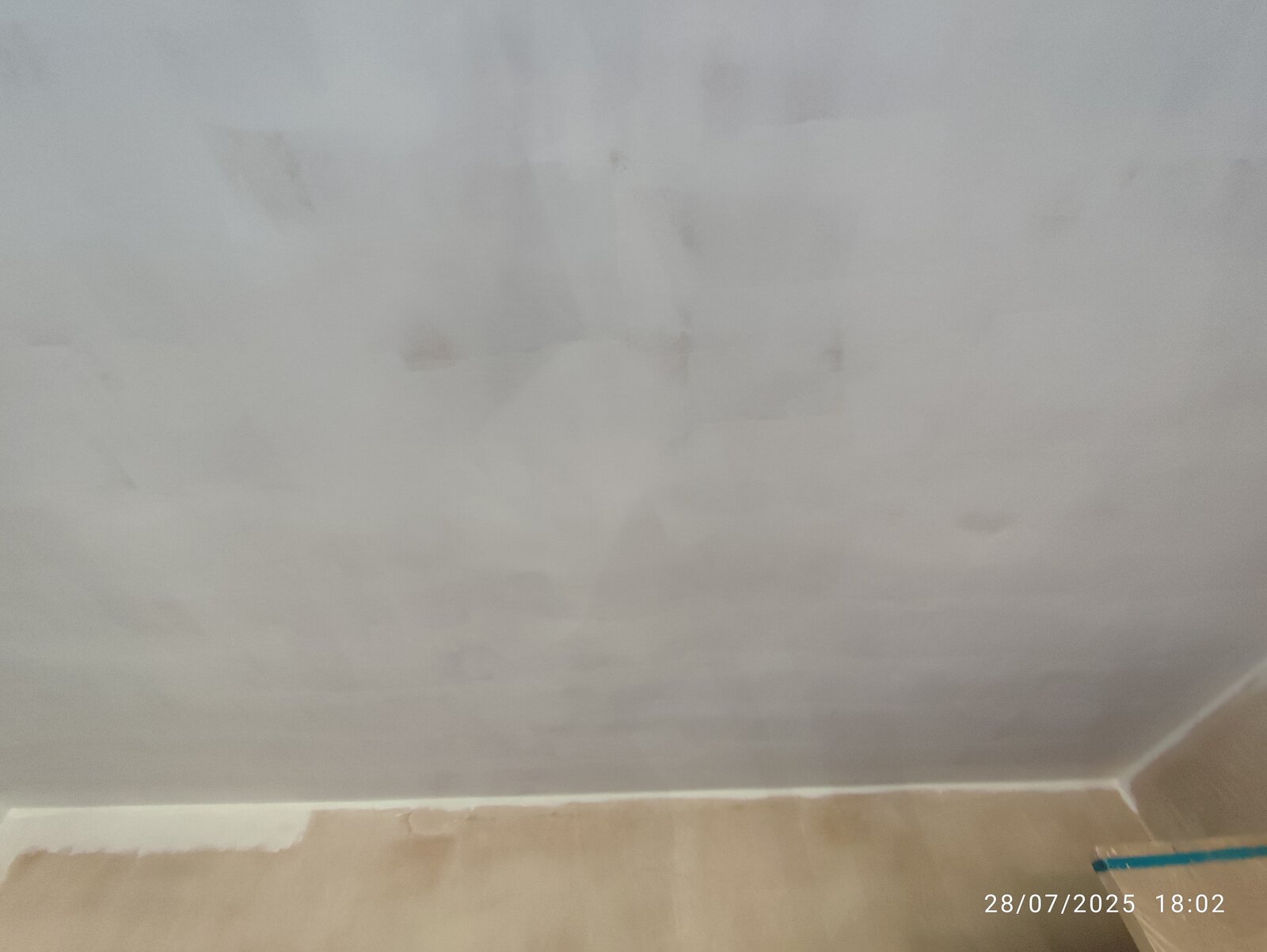

Hi all, I bought Tikkurila paint and primer as it's VOC free and had a lot of VOC in this bedroom.
Room has been plastered and I have used Tikkurila primer. I did one coat and it was very patchy. Tried doing a second coat but it didn't make much improvement.
I have now done 2 coats on the ceiling in Tikkurila colour range and that is patchy too.
I was advised to use Tikkurila primer but it was very difficult to put on.
Any advice please?
It feels like a total waste of money and effort. And to rub salt in wound VOC levels are still high.

Plaster is a difficult surface to paint with a first coat.
New builds get plots spray primed by gangs ready for the painters for this reason.
You will also find the primer is not great opacity and a second coat doesn't take or cover much better.
It you have voc free paint then it won't have any vinyl in id guess? I've used tikkurila but not that paint ..
Big roller. 15 inch min.
Roll in a band. Always finish the roll top to bottom. This will keeps the roller nap the same.
Then next band overlapping first band and finish roll top to bottom.
This will help

How many coats do you reckon? I've done two for the ceiling so far.
Is tikkurila worth it in your opinion? Yes no vinyl but has acrylic.

The primer seems to be one for all ie wood, walls, new plastered walls etc.
It was too thick to apply. Ceiling took 3 hours, and the walls took 4.5hours for a 13sqm room...
I have been using a short pile roller for a smooth finish, could this be the reason too? medium pile has more paint on it and better coverage?
