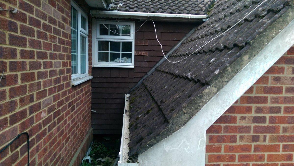

We have a triangular shaped section of wall about 1Mx2M that is covered with hanging, fairly loose fitting tiles. It covers what I think is essentially a stud wall (its actually a linkway connecting the main house with a room on top of the garage).
My question is, would it be difficult to remove them temporarily and then put them back (how?) ? Or maybe I could replace them with something? It would only need to be temporary since we've planning to demolish it in a few months. Maybe just roofing felt would survive that long?
Any advice gratefully received.
If you start from the top there is normally some lead flashing, if you pull that up you should see the nails that are holding the tiles on. Take them off and put them back on the same way, but your correct roofing felt will last that long.
Sorry I didn't post this earlier. The "floor" in that picture is actually on the 1st floor (and yes its a mess....the cable is coax and not put there by me but yes I should remove etc....)
I couldn't find a pic of the other side but its the same but there's no window and only accessible via ladder .

Do you know, i didn't see the co-ax cable until you drew attention to it. Talk about the elephant in the room.
You are well advised above but now we have the pic i cant see the usual head flashing above the hanging tiles - so perhaps the gutter has to be removed before you can start de-nailing the tiles. Its still a simple job.
There's a few bits of remedial work in the pic that will need doing but i'm sure that you are aware and intend to take care of things when you re-build.
