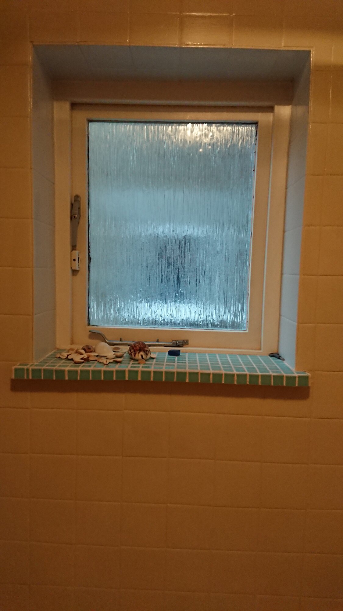

Tiles have come off again after two years, and I have now regrouted. If there's nothing I can put over the tiles to completely insulate them from the water perhaps I'd better try the window box idea next time.
Remove the tiles and overboard with PVC window board. This will stop all the problems that you are having. Or you could try posting in the tilling forum as they may be better to answer your question!

As the guys said earlier and I have also done many times PVC glazing products are perfect for use in bathrooms, tiling on to a wood Cill is a major no no, and will always have this same result as the wood will expand and contract causing the grout to hairline crack and then water will enter and ex celebrate the problem. If you want to tile remove the wood using a chisel and splitting the wood and pulling out the shards, fix a baton to the front edge and then using this as a mould fill behind with bonding plaster. When you fit the tiles put a little more adhesive on the back edge making a very slight slope towards front edge. This is much easier than it sounds and will give you a perfect straight and stable Cill, ps use quality adhesive and grout, ball or similar not DIY store own brands
Alternatively glue the tiles down with silicone or CT1, then use the CT1 to fill the grout lines.
CT1 will cost more than silicone but you might find it easier to manipulate when filling the gaps.
Both will remain flexible.
Thanks, I'm tempted to try doing it with CT1, but I think that tiles with sealant might look a bit odd.

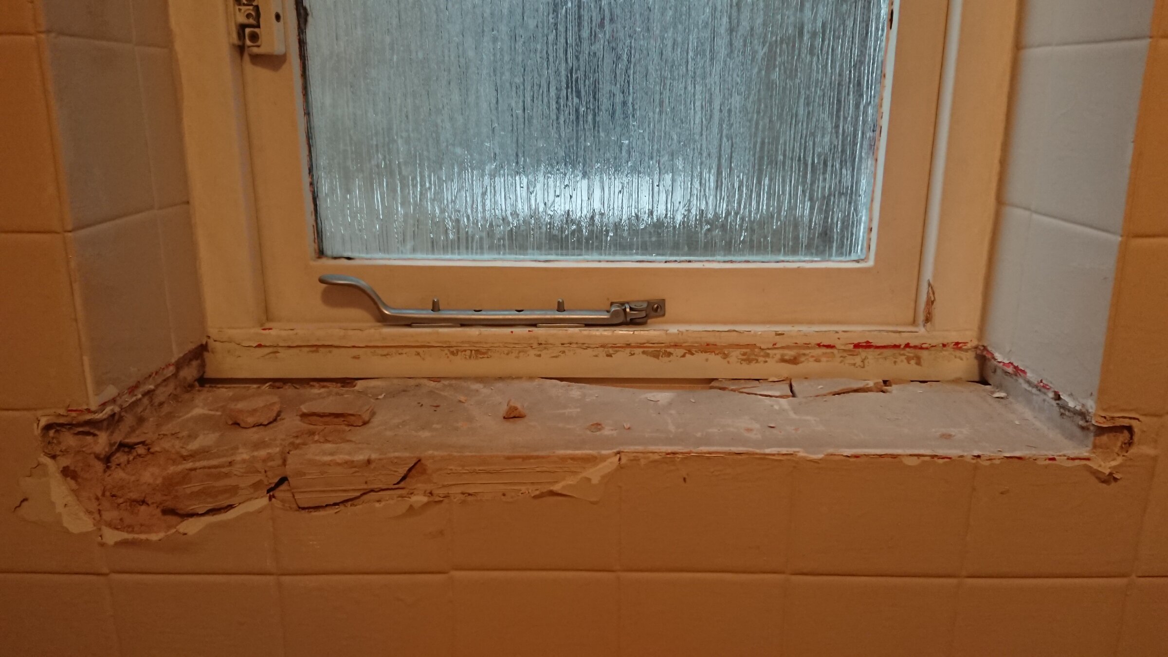

Edit: Here's how it looks currently. The tiles are in place but only just. White PVC might be a bit boring so if anyone has any suggestions for an alternative I'd be very grateful.
A number of the tiles have fallen off today. I think a visit to Homebase is in order tomorrow...
OK, I've removed the wooden sill. It was nailed down onto a plaster base which inevitably I have now damaged.
I have some Knauf Aquapanel board 12.5mm thick which I think I will cut to size and place where the wood was, and then tile over this. I'll probably do this flush, i.e. no overhang as with the wood sill.

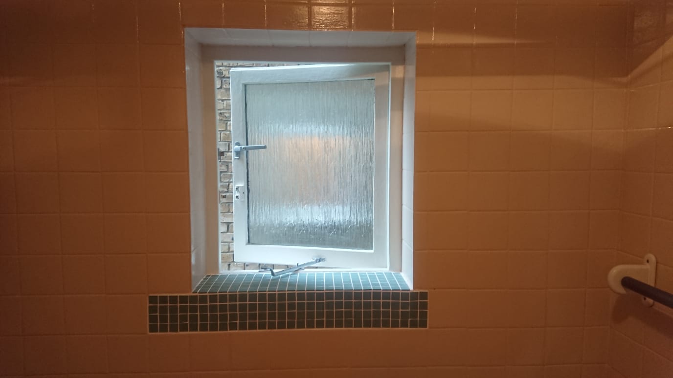

Done. Had to build the cill up quite high so that I could fit four mosaic tiles on the front, but I think it looks good. Let's see how it lasts.
