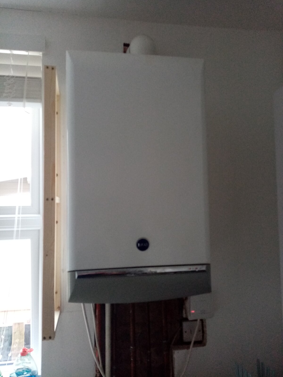

I'm building a timber frame for my boiler
I will be fixing a cut to size piece of end panel to the LEFT hand side of the timber as seen face on from the boiler. p.s. the end panel will protrude slightly higher than the timber frame so it covers the height of boiler, i'll just secure it to the timber where suitable.
i will then create a hinge off this end panel for the door front
My issue is connecting the end panel to the left hans side of the timber frame that i've put on the wall. As the boiler is in the way, i cant access it from the inside. the reason i can't bring the timber frame out more is because i also have a cupboard on the right angle to the boiler that will hit when opening the door
So my question is, how can i fix an end panel to this timber frame without screwing from the outside (screws will be visible), bare in mind the boiler door front will also be hanging off this end panel with standard hinges
Is my only option to screw from outside with screws visible?
All I will say is respect the MI`s and boxing in along with leaving full access for the guy/gal servicing/repairing it.
im only boxing in the side panel and front door so the right hand side and top will be open/free (but not visible)
Take a look at KEKU clips:
Four of those attached to the frame should allow you to snap the cabinet end on and off without screwing. Commonly used in shop fitting
No frame required, just make up oversized kitchen cupboard , hinge front for general access and fit back to wall with keku clips as suggested by J&K to allow complete removal should boiler need maintenance or changed.
