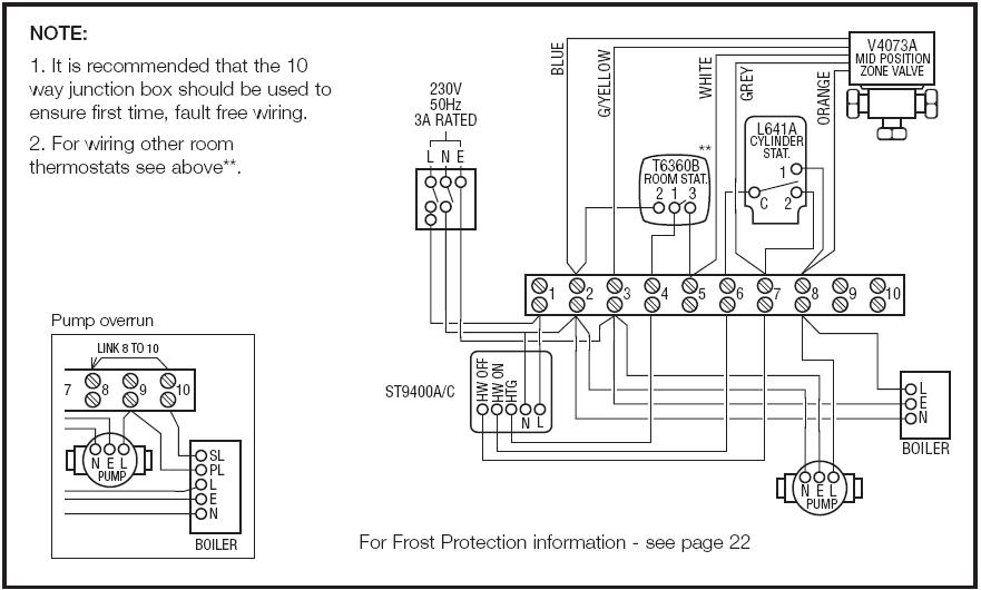

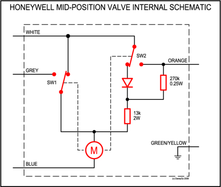

mid-position-valve.jpgY_Plan.jpg Given are the internal wiring of three port valve and general Y plan wiring diagram. In theroy there should be three wires to both the programmer for DHW and the Thermostat for DHW, the extra third wire turns the DHW off when set to off by either the programmer or the thermostat, so power to three port valve when DHW is not wanted.
With an old boiler it did not matter too much if water went through the hot coil when not required, with a new boiler the returning hot water will cause the boiler to modulate (turn down) so I have seen where the off wire is not connected to one of the devices.
But the main point is all the micro switches in the three port valve do nothing if only DHW is called for, it is only the programmer and the tank thermostat which does anything when only DHW is called for, so the valve should not move, default with no power to valve is DHW.
The lever on the valve can hold the valve half way for bleeding, it activates one micro switch, and when the other has failed I have seen that latching the lever on has allowed central heating to work, even with a faulty micro switch.
Fault finding is hard, as the three port valve back feeds, so you need a volt meter as need to see not just line, but line at 230 volt. Use of volt sticks will not work with the Y plan for fault finding.
