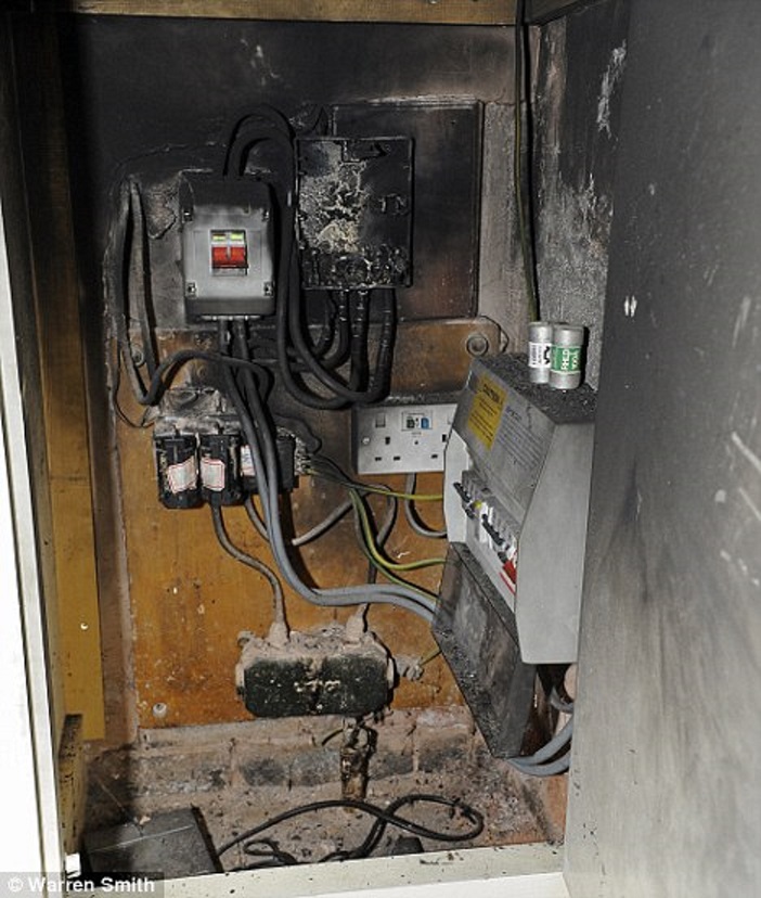

Small but there have in the past few years been several instances of bond cables melting.
For a start, "several in the past few years" is hardly a lot - as I recently wrote, I think that 3-4 people are killed (and a lot more injured) each year in the UK by being struck by lightning.
More to the point, of these "several in the past few years" cases of melting bonding conductors, how many do you think (or know) were due to a simultaneous phase-neutral short and a severed neutral (severed on the 'right side' of the short) ??
Kind Regards, John
I do not keep records of conversaions in which I have learnt of incidents so I cannot give specifically numerated answers. "power surges" have been reported after metal thefts have open circuited the Neutral. At these incidents some properties have had voltages far higher than 230 + 10% which have damaged equipment but also some have had fires involving ONLY the bond wire.
This meter cabinet fire was caused by the high currents flowing through the bond to the MET. All the damage is above the MET and the although the meter appears to be burnt it is only a coating of soot from the seat of the fire below. Several other meter boxes suffered similar damage. I recall that the water mains in the area were metallic.
This picture can be found in this article http://www.dailymail.co.uk/news/art...ters-called-71-homes-massive-power-surge.html
