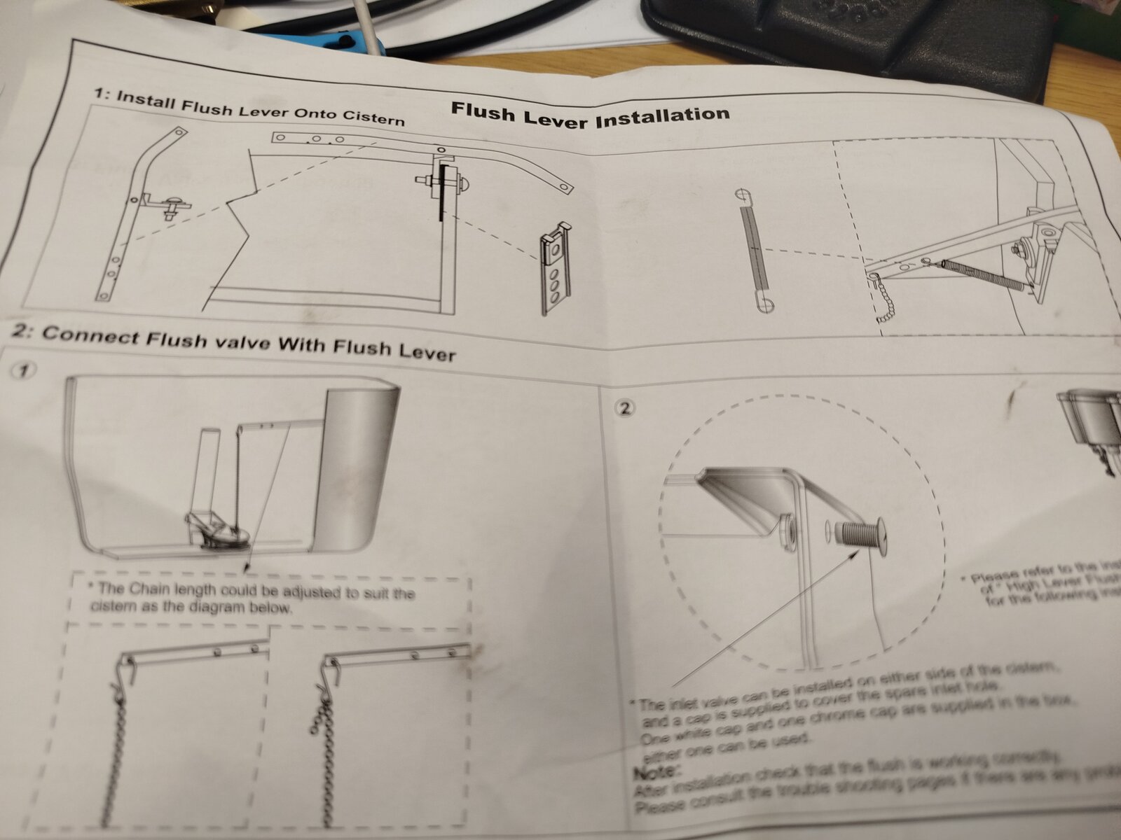

Haven't fit a toilet with a flapper valve for a flush before. Do they come with a spring onion the handle that keeps the flapper open?

The flap is lifted by the handle, then it floats, and stays open until the water has drained away. Then it flops down and water pressure on top holds it down.
You can put a weight, such as a brass nut, on the chain if you want it to shut more quickly, or to make the handle return when released.

On ours you can turn the floating valve to adjust the length of time it stays open I think it's on a shamphered base that allows the water to drain slower or quicker. No need to add weights
On mine, the press handle is quite heavy, and drags on the chain, so a weight counterbalance it.
This is the set up.
Looks the same as ours. You just turn the seal on it's mounting to adjust how quickly it floats or closes.
The bit that goes into the the pipe that goes through the hole in the base of the cistern . Ours has CW and Anti CW arrows embossed on it but I can't remember which direction reduces and which increases. It should be in the instructions.
