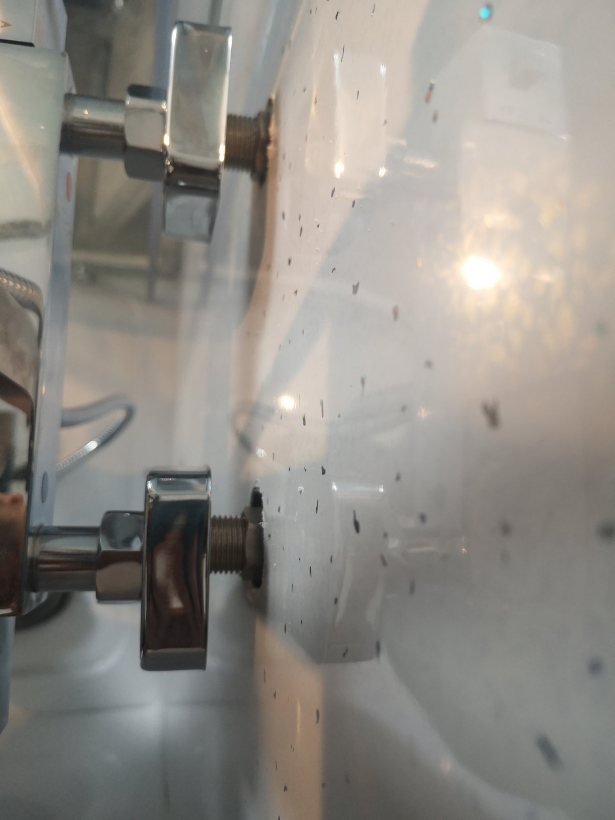

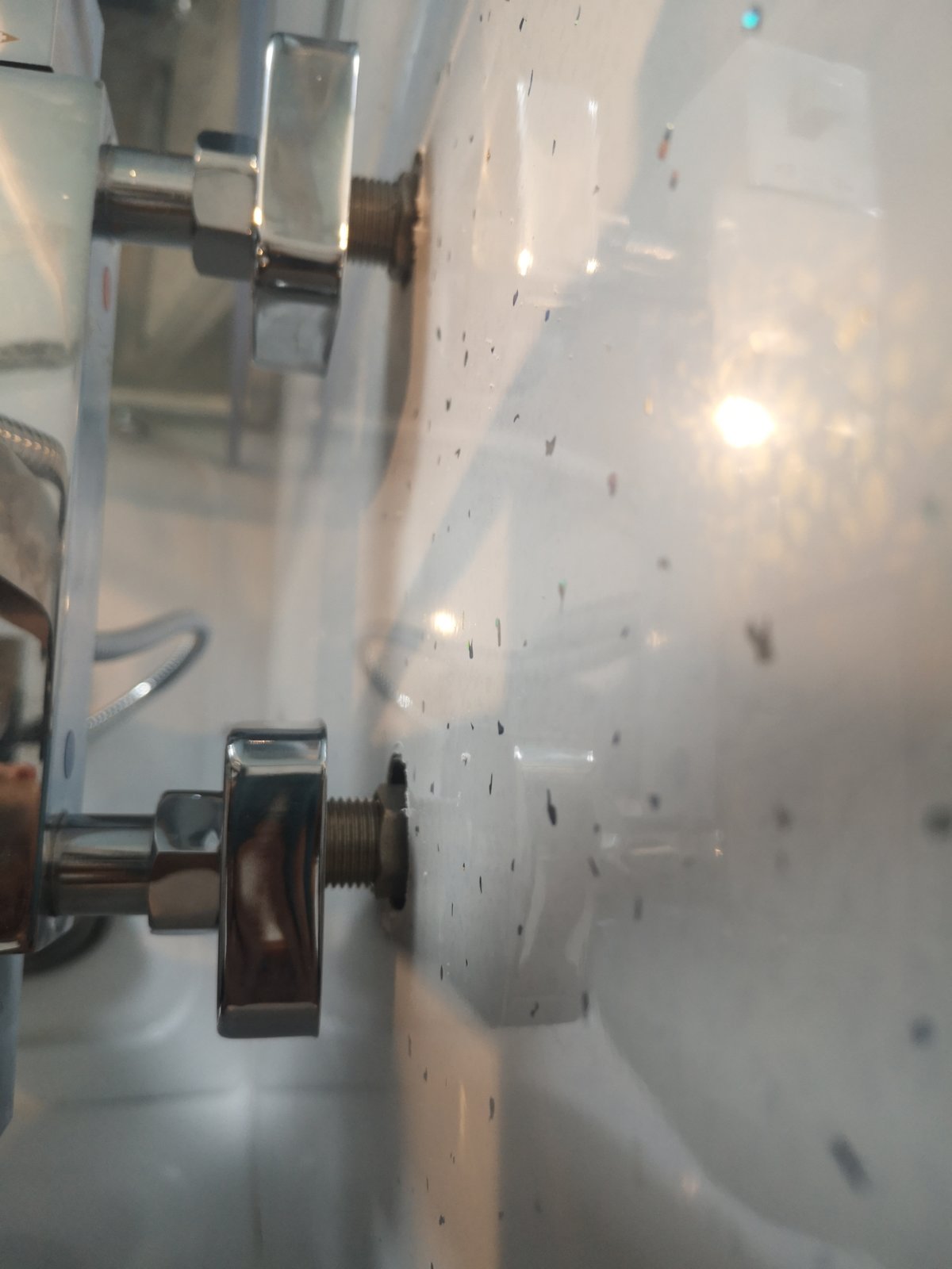

How long are the shower feeds coming out from the wall and is it the chrome shrouds for say a bar shower that won't fit? ... more pics please.

Thanks again, have attached a photo of the shower installation. I've had a few people out now, 1 plumber asked for the original plumber to put this right as he doesn't want to touch it, 2 others have said shower nerds to come out and board needs to come back. Off and then to be re done
What do you all think?

Oh dear looks like those ridiculous Z connectors.
Honestly, it needs to come out and get done properly.
That's shocking, why does the original plumber think that any of that work is acceptable never mind asking for money for it ..... actually going by all that work, he really shouldn't really be called nor trade as a plumber

Before you start ripping boards off, is that the tight final position of the mixer? if so just measure the gap and cut it off the 1/2" thread
and redo.
If those connectors are tight into the fittings and bar mixer, I would say the gap's too big to make up by cutting the connectors and still leave enough thread to get it all to fit tight together. Alway worth a try though.
