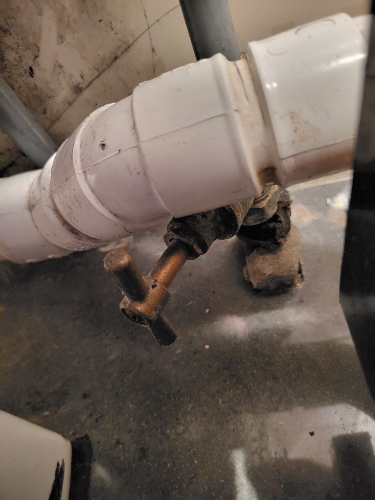

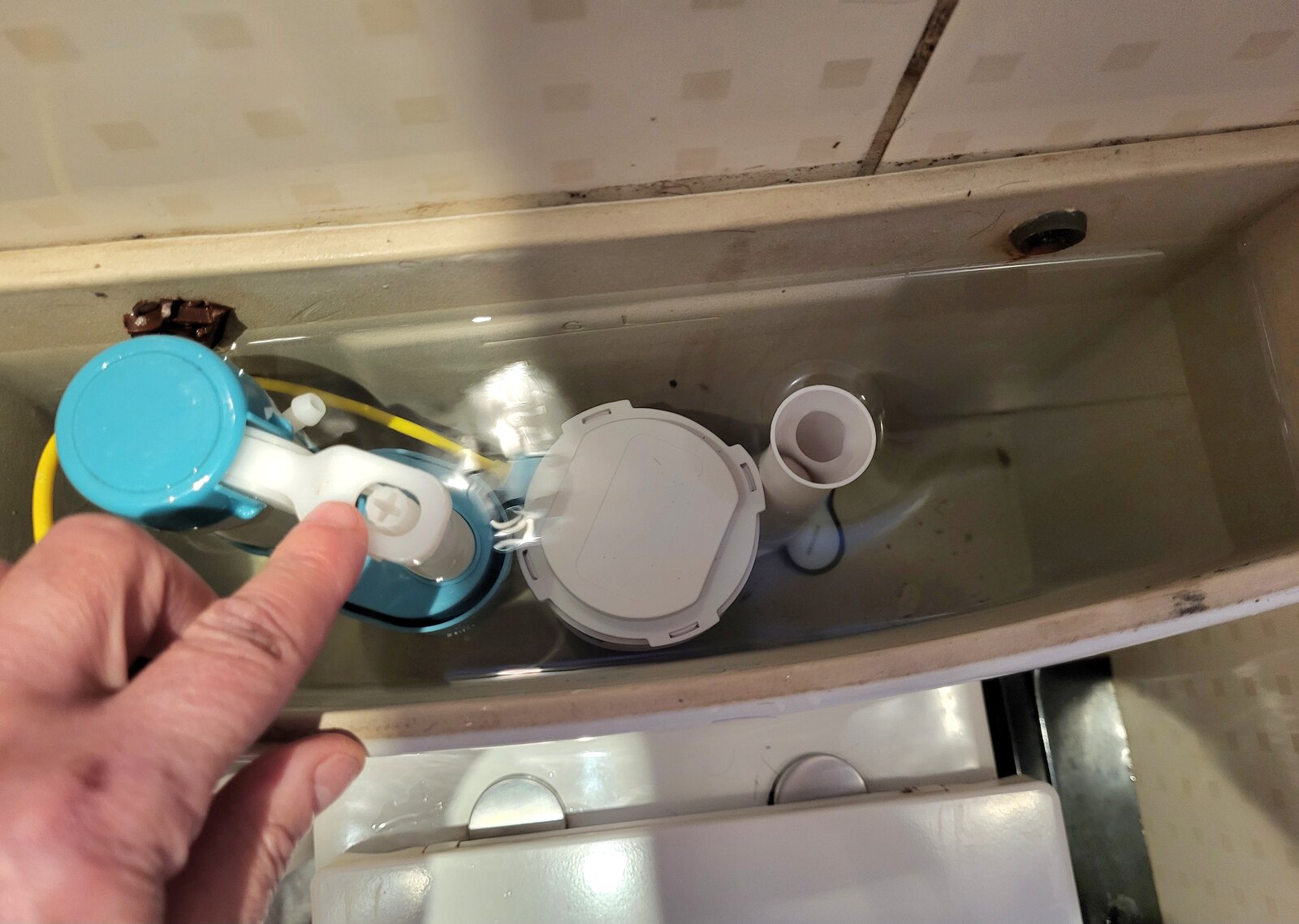

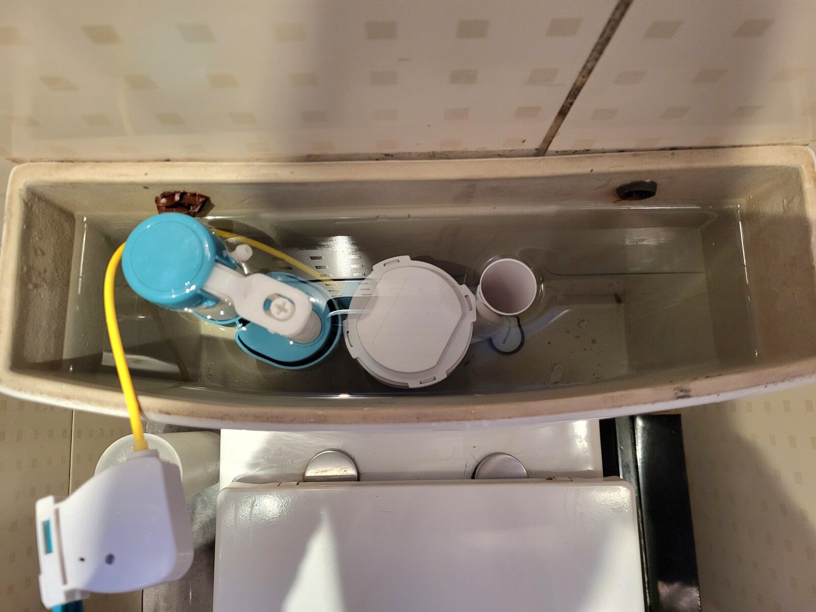

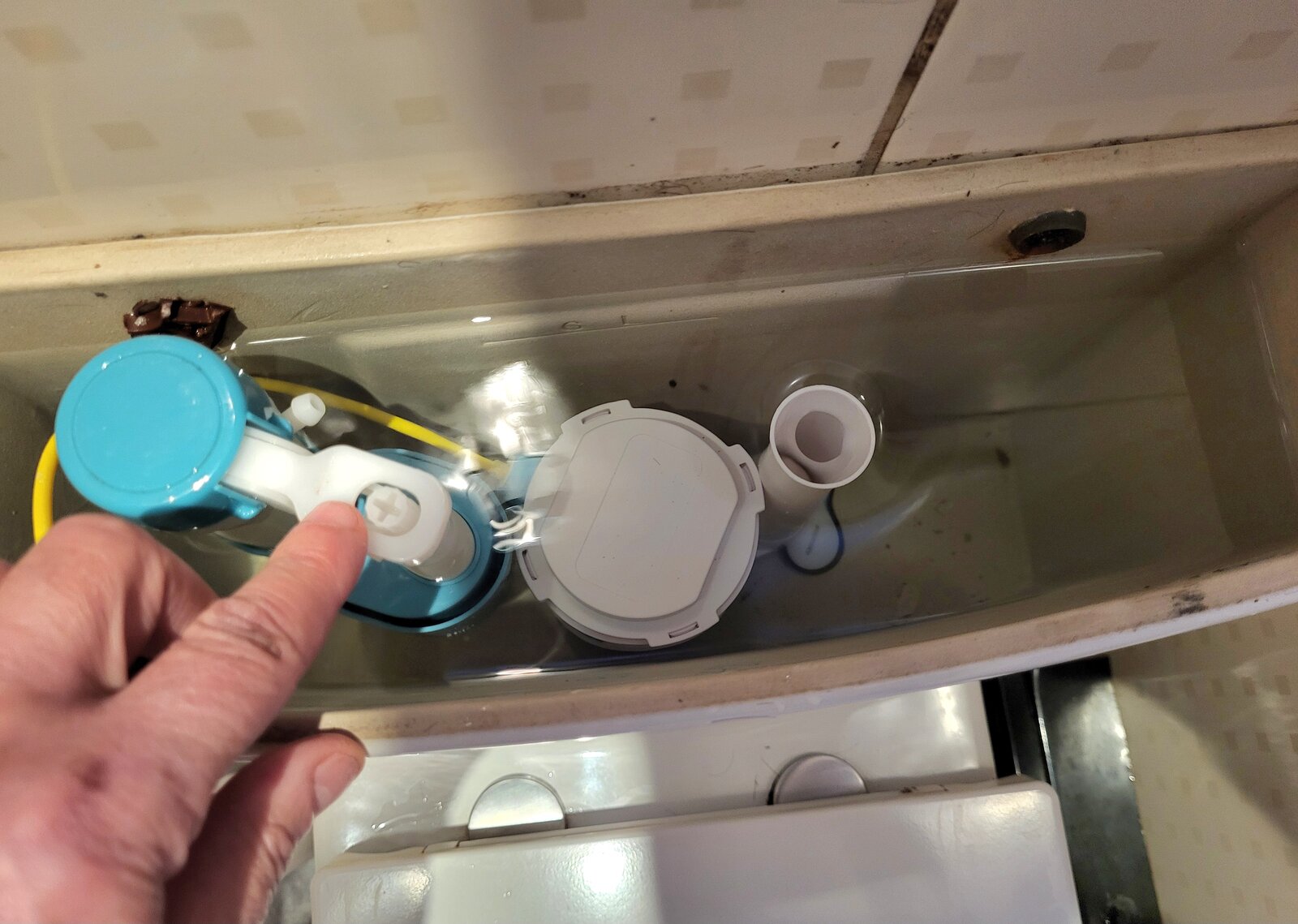

Hi. Whenever I turn the shower or bath tap on I get water flowing into my toilet (situated next to the bath) from the toilet cistern and that gives me less water pressure when using the shower. I'm not sure how to fix it. I don't know if it's the inlet or outlet valve that needs cleaning or replacing. I turned the shower on, took the lid off and noticed that the water starts going into the overflow pipe even if the white plastic thing on the inlet valve is not pressed down. As seen in the photos, the water level always sits quite high in the cistern, just below the overflow pipe. I'm assuming it should normally be lower?
Any ideas? Also, is it ok to try and fix it without turning the water off? I presume it's the brass tap in my photo which is positioned at the right of the toilet near the back, but it's stuck. If I use a wrench would it be clockwise or anticlockwise to turn the water off? Thanks.

1. Much more likely to be the inlet valve. Particularly since the water is reaching the overflow level.

3. If the brass tap in your photograph is connected to the inlet valve, i.e. directly connected to or connected via a short length of pipe or flexi hose to the threaded shank of the inlet valve which protrudes below the cistern, then that is the isolation valve. Shut it off, flush the WC and see if it refills. If it doesn't, then that is the valve. However, it is unusual to have that type of valve on a WC.
4. If looking at the tee handle of the tap end on, it would be clockwise to close and ant-clockwise to open the valve.
5. As a first step I would adjust the water level by turning the cross head in the white plastic screw which adjusts the height of the float. Left of the picture, blue green circular cap with a white strip at about 4 o'clock. White strip has an oval cut out. Adjustment screw roughly in centre of cut out. Can't tell you which way to turn it as some are right hand thread, others left hand. What you want is for the float (oval blue green plastic inside outer blue green plastic) to go further down. In that way it won't rise as far as water enters before operating the valve mechanism under the round blue / green cap. You don't need to turn the water off to do this, but you might feel more comfortable with it off.

6.2 Under the round blue / green cover there will be a rubber diaphragm washer. These go hard over time and cease to work properly. You can almost certainly replace it, but would need to know the make and model of the inlet valve to obtain a replacement, and hopefully to find out how to remove the cover.

7.13 Turn the water on and let the cistern fill. It should stop filling when the water level reaches a height mark on the cistern back. This should leave it about 20 to 25 mm below the overflow pipe.
Thanks pal, that's a very comprehensive answer! Tomorrow I'll have a go at adjusting the white plastic crosshead screw and see what happens. Otherwise I'll try and get to the diaphragm washer. I certainly hope I don't need to remove the whole cistern and valve, it seems a bit fiddly and I don't have another toilet to use if I leave myself stranded with a disconnected cistern and broken rusty screws, lol.
That brass tap I think controls the toilet, bath and sink. It's connected to a brass pipe coming up from the floor so it must be the main water inlet pipe for the whole bathroom. I had a feel behind the toilet and could feel some flexi pipes but I didn't feel any valves to turn.
