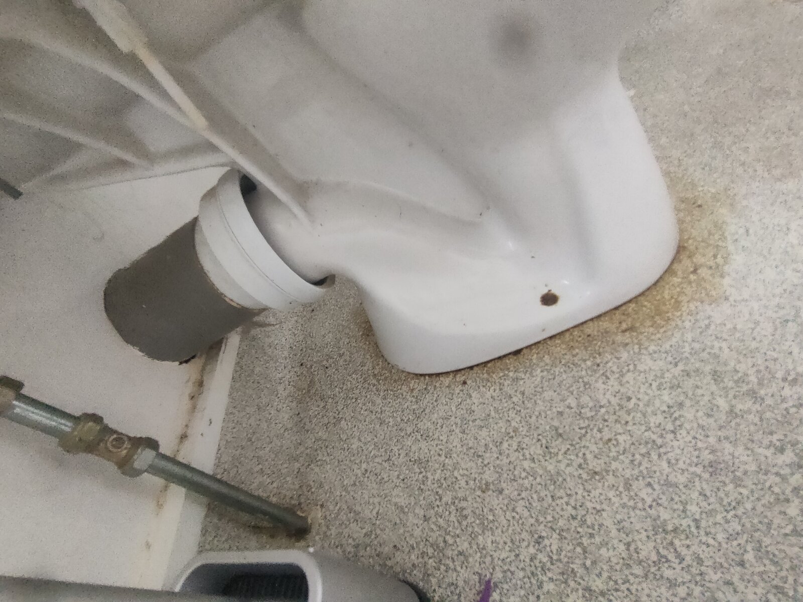

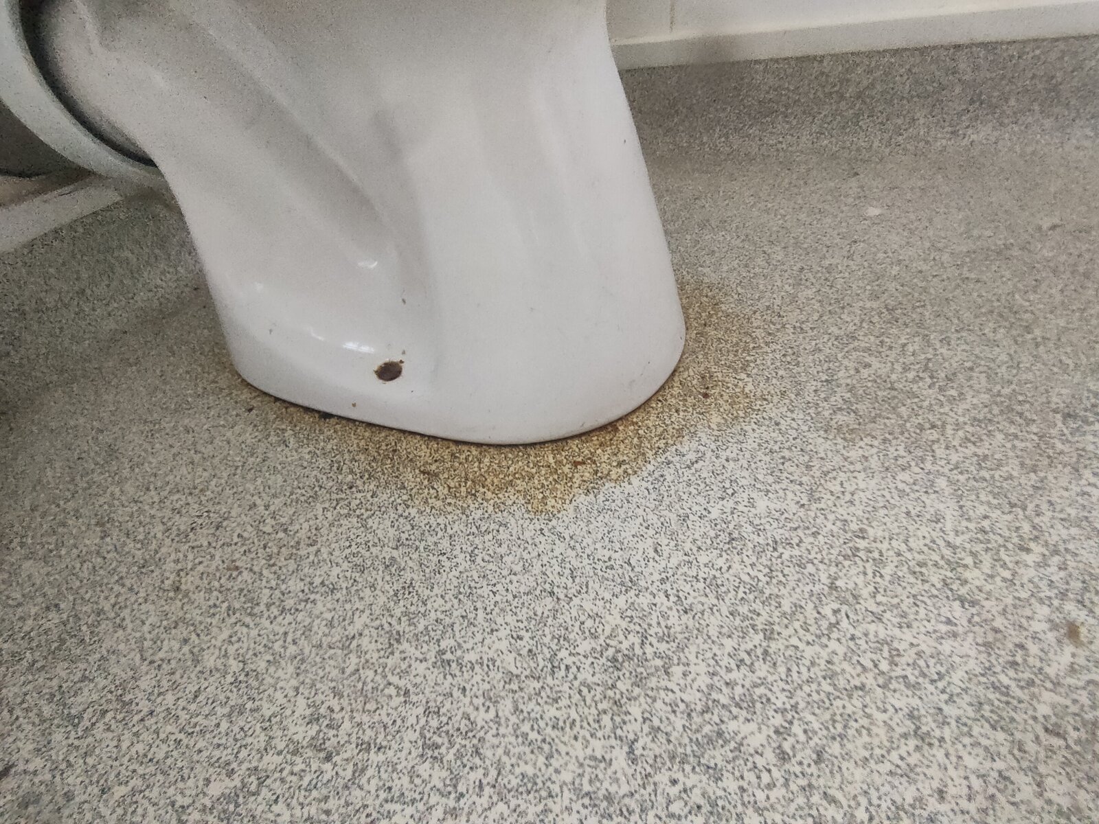

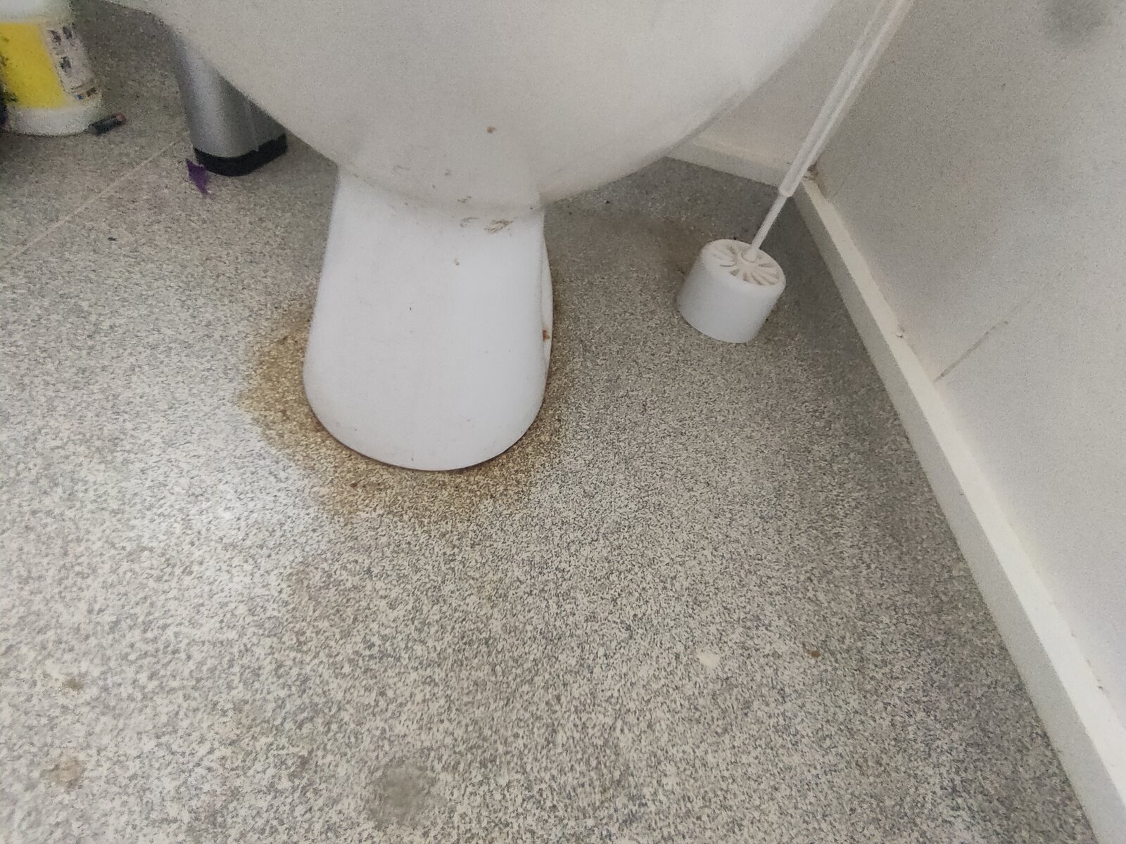

Got a toilet that seems to be giving out some nasty sludge from under the base
I have attached a photo
What do you reckon guys a crack in the toilet itself ?
We have cleaned it multiple times for it to come back so defiantly something going on

Could be water and rust from those screws, could be someone missing the bowl, could be the back connection leaks after someone has sat on it.

I am not a plumber, but I can see that the back of the pan is less yellow than the front.
Please do not run a bead of silicone though, it might mask issues.
As mentioned in a previous; reply, the screws might be rusting... but nah, that is unlikely to be the the problem

I have high suspiciona ther is a crack in the pan
As you say the back is dry this is mor underneath and pouring out the side this was cleaned only hours before the photo
Could be a small crack at the base of the U-bend, caused by over-enthusiastic use of the toilet brush?
Is the pan secure on it's mountings or is there a bit of rocking movement?
Are you aware of anything having been dropped into the pan, such as a spanner/screwdriver/small hammer etc?
If the water inside the pan is crystal clear after flushing look carefully for a hairline crack or chip below the waterline. You will need to look very carefully for the hairline crack becaue, as the name implies, it may be the thickness/thinness of a human hair.
If you have some feeler gauges, (car mechanics/engineers often have a set), try to slide one under the base of the pan to see if there is a gap anywhere. It may be an idea to exchange those screws for stainless steel ones but when you change them, try to flush out as much of the gunk as possible from under the pan and allow it to dry out before screwing back down.

I think what I am going to do is I am sure there's a hairline crsck myself
We have only had the house a month so anything g before that I would not know about
It has just became more visible this week
I reckon I am just going to go grab a new bog and get it in
I'll also be using stainless steel screws for the new one
