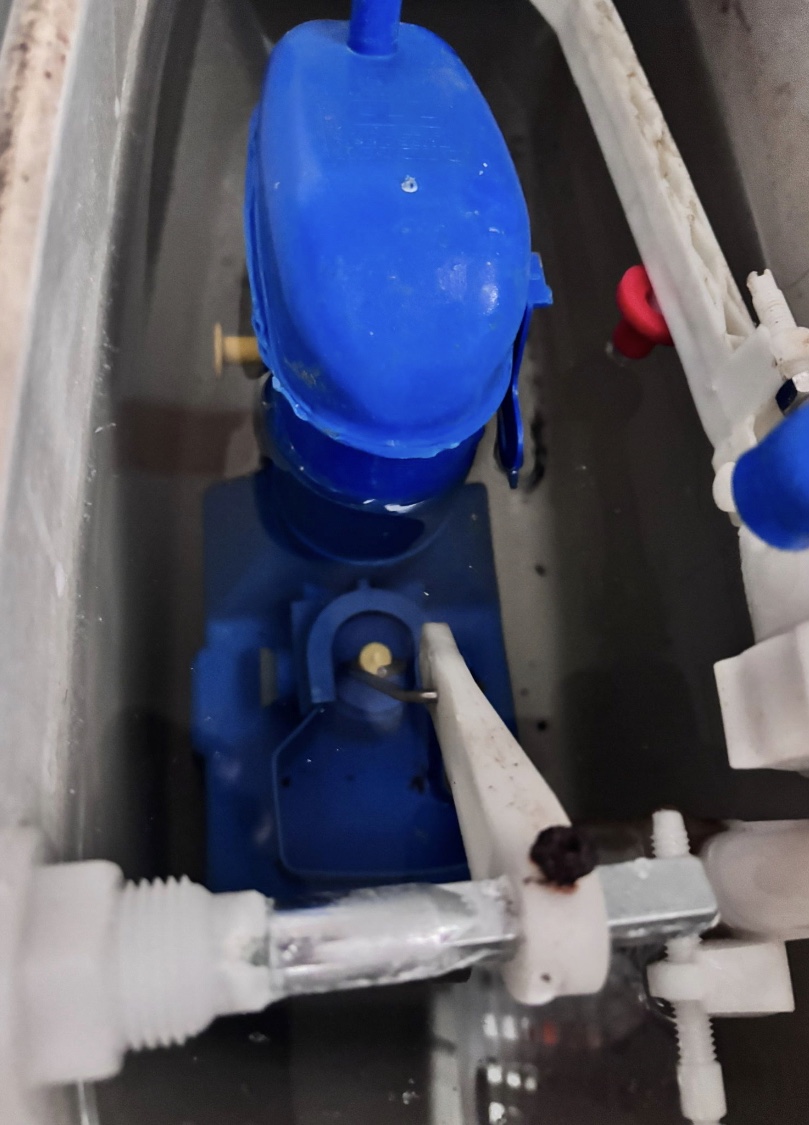

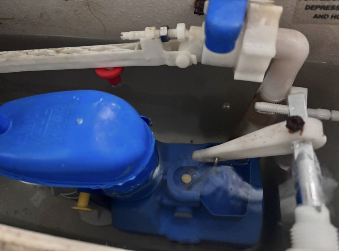

I need to change this toilet syphon which I’m aware that I will need to remove the cistern to replace. I believe this may be a Thomas Dudley syphon & some of these can be taken apart & replaced without removing the whole cistern. Does anyone recognise this one or know whether I can take it apart in the cistern or not?
Google. Thomas Dudley turbo edge diagram.
What's the writing on top say?
You pull the yellow tab and lift off I think
1. If you have to push the handle repeatedly to get it to flush, likely to be the syphon diaphragm.
2. Otherwise, could be too low a water level requiring adjustment of the inlet valve.
