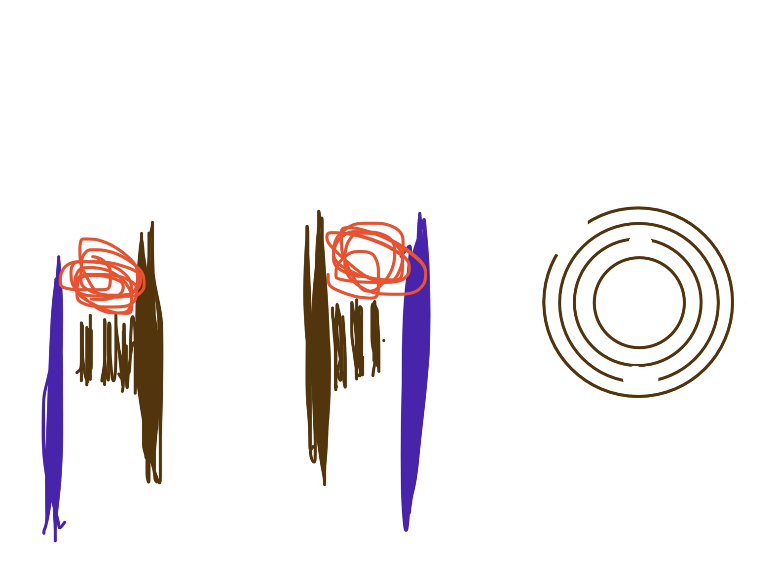

Get a bit of 110 soil pipe (maybe out of a skip if you don't want to buy a length), cut some inch wide rings off the end of it, then cut them so they can be opened up like a C shape. Cut a 3 inch section off the 110 and snap the 1 inch C shapes progressively onto the middle of the 3inch to increase its diameter to roughly the diameter of the in-floor pipe, ensuring that the openings in the C shapes overlap each other.
Now place it into the floor pipe so it's flush, and silicone up the gap between the 110 and the 5 inch. Fit a flexible pan connector like normal after it's cured
Brown=new 110 with c rings of 110 around the middle
Red=silicone
Blue=existing 5 inch

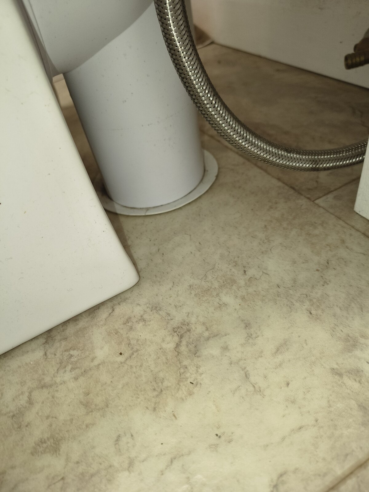

I had what sounds like a similar scenario, I
cut the collar off and fitted a longer tail pan connector with a finned grommet inside the pipe
Similar to
