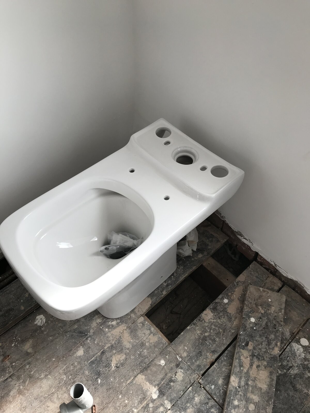

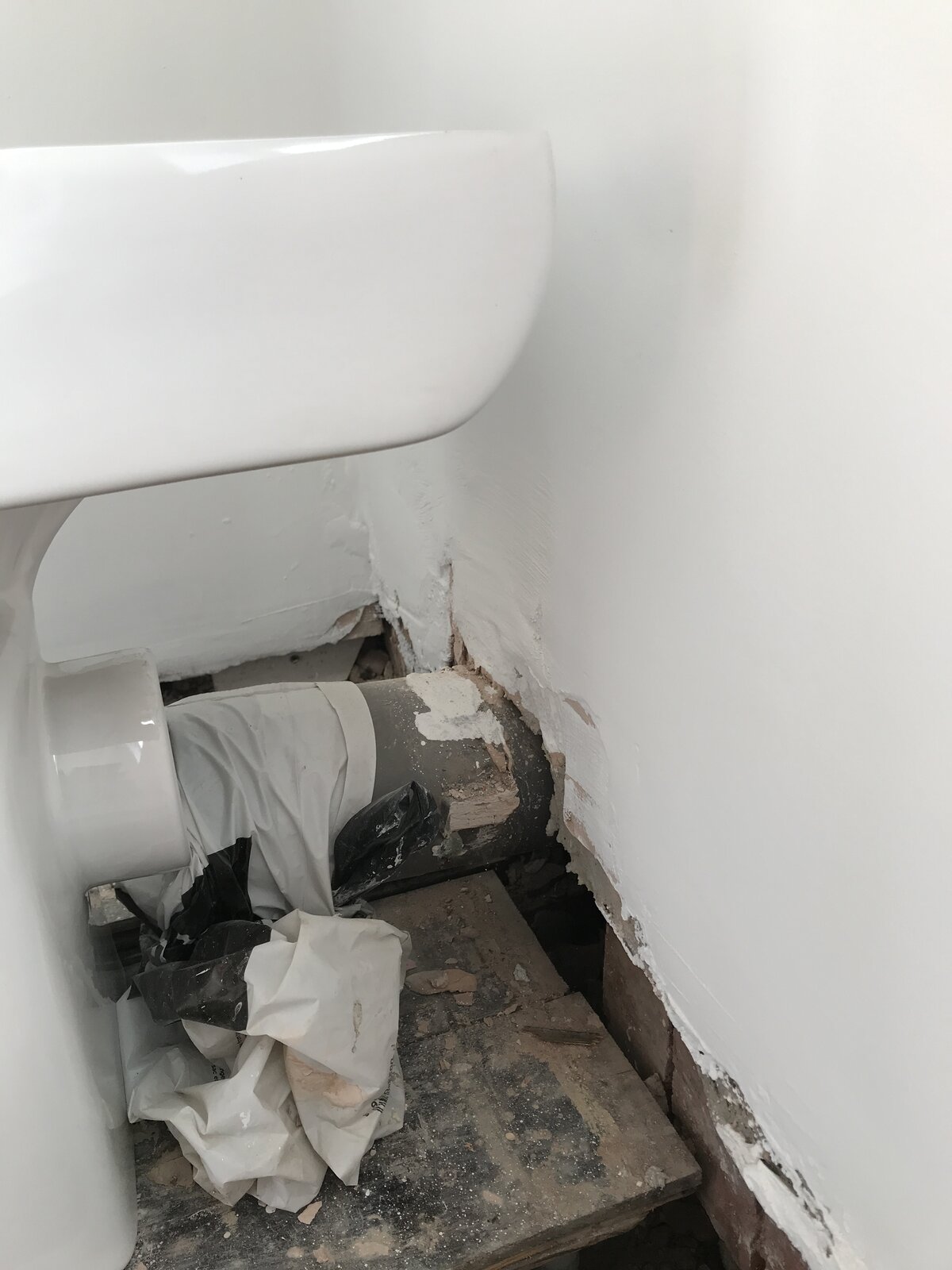

Hi guys,
I am have just purchased this toilet for my new house. However, it seems as though the waste pipes won’t match up. I want to add one of those flexi waste pipes. Is this possible? And how do I do it? Currently the toilet is around 7cm from the wall. I have added pictures to help. Thanks in advance

Looks like you are going to have to cut the soil pipe towards the wall and leave a short stub , you can then fit in a flexi waste, make the flexi bend is as smooth as posible no kinks
