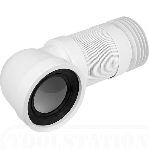

I have to replace my toilet. The waste pipe is in the floor, not through the wall and I'm told this may be a problem when buying a new close coupled toilet.
The distance from the wall to the edge of the waste is 110mm.
I have seen a toilet and when fixed to the wall, the distance from the wall to the edge of the waste (where the pan connector would go) is 145mm. I am told that a 'flexi-connector will be the most suitable type and that because a lot of the end of the connector fits over the part on the toilet, the flexibility will be more than enough. All sounds fine, but it was the guy in the shop who gave me this advice and just wanted to get a 2nd opinion, just in case I went ahead and bought the toilet only to find it wont connect to the waste properly.
Sorry to waffle on, just wanted to make sure I gave all the relevant info.
In summary:
Distance from the wall to the edge of the waste pipe (which is in the floor is 110mm.
Distance from the wall to part where pan connector fits is 145mm.
Basically, will this 'flexi connector' do the job or shall I look for a different toilet which has a bigger gap from the wall to the connector on the toilet?

All depends on the pan.
Can't think of one which would be any good for you, and I've never known a flexy help.
One of these is usually best (rotate picture 90 degrees anticlockwise!)

im guessing the swan neck connector dosn;t go back in under neath itself far enough. A flexible might do it but not sure if it will restrict the flow. Could you box the toilet off the wall 35mm or so?
I might have to.
I think I'll commit to buying this toilet, put it in and see how it goes with a swan neck connector. Worse case scenario is to build the cistern out, like you said.
I reckon that from what you say, the swan neck won't fit. If it is on floor boards you cold always re-route the waste under the floor using connectors - or its a box on the wall.
Most waste pipes from coming from a floor are on ground floor and boxed in or in bungalows and covered in cement,so i doubt it can e moved. So its usually a case of putting a baton behind the cistern to achieve correct position. Dont use a flexi if you can aavoid it , it is just an expensive **** collector that will cause probs later.
If you box it in you can also hide the pipework usualy and make a nice tidy job.
