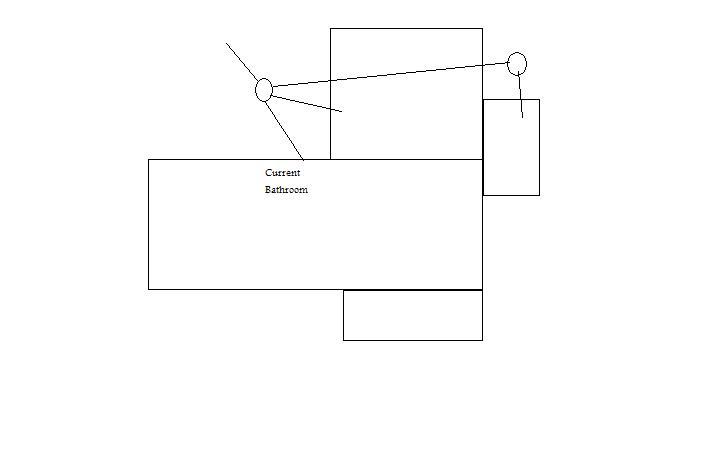

Just some points regards soil pipes
the current run to ceptic tank were we have to join into is deep
plan is to join in with inspection chamber at the 90 degree run 1 line of pipe(110mm) through foundation on the side to insepction chamber on other side then run from the 90 on that one sound run over foundations then up with slow 90 in the corner of which will be ulitiy room in to loft space pick up bathrooms in loft conversion trying to avoid soil stack running down out side walls.
Then back to first inspection chamber use the other socket to run pipe through foundations and then up under new kitchen sink unit.
going to bring pipes up on edge of foundations which mean there about 150mm from internal walls is that correct?
pipe the run though concrete foundations going to shutter arournd and leave open then lintol over, or should i just rap with loft insulation?
Many thanks
Paul
Heres a plan i've tried to do with paint
The exsisting bungalow is just the middle rectangle the rear is new kitchen with ulity on side then new lounge extension to front.
Currently dormer bugalow with flat roof
the new front and rear extensions are going to be built up gabled new ridge running right trough.
I'll see if I can get some pics.
