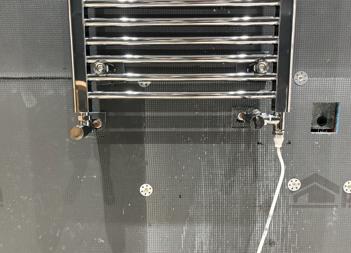

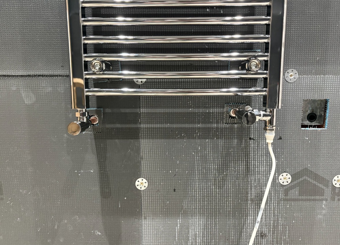

I’m currently in the middle of a bathroom refurb and fitting a towel rail with a heater element so I can use it over the summer. I just bought a flomasta 1200 x 500 with a flomasta element from screwfix for ease.

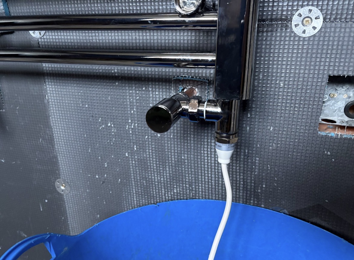

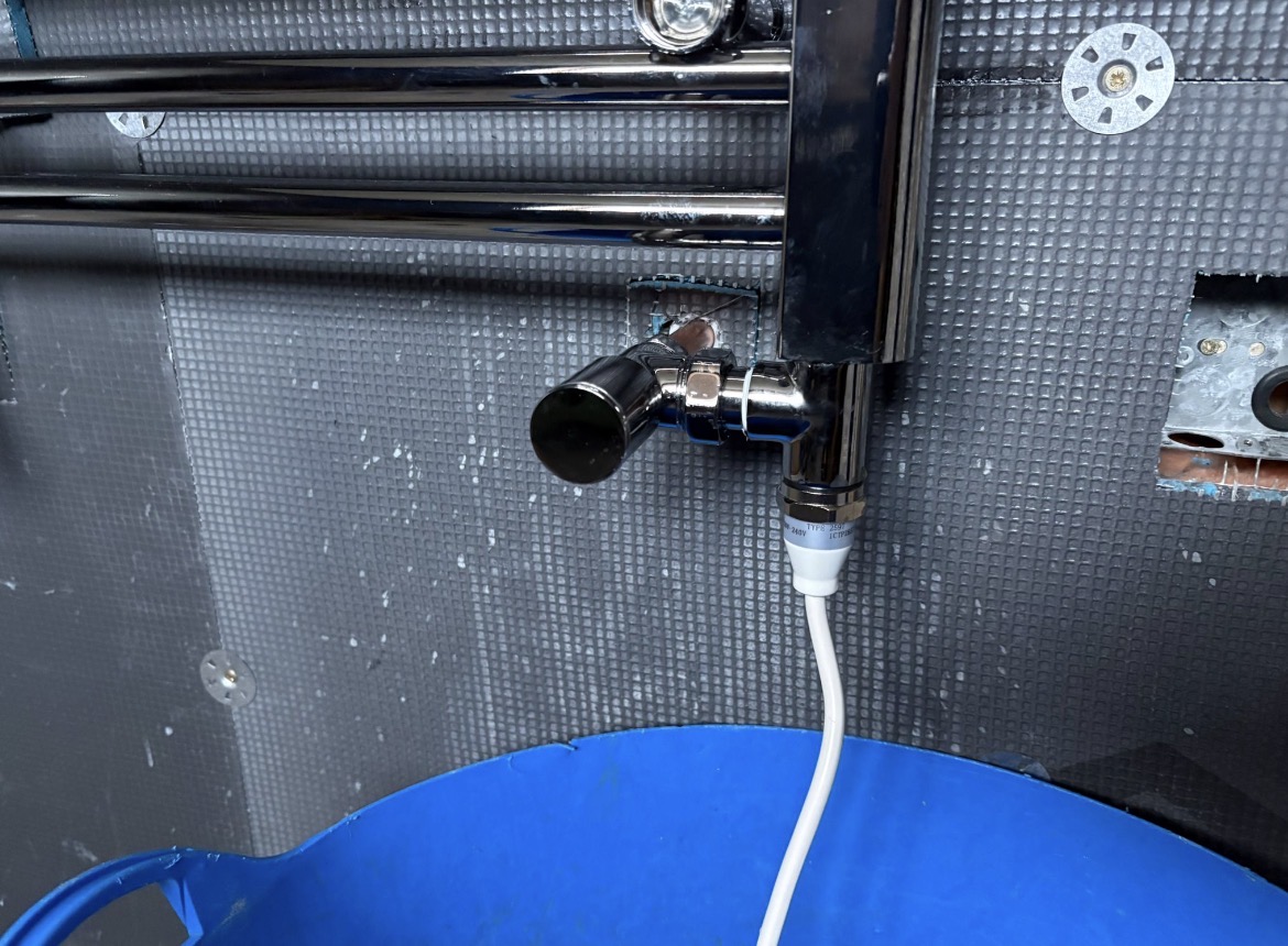

The issue….. when I have fitted, i cant get the element in tight due to the direction i need the pipes see below (and the image from flomasta) and it really needs a 1/4 turn to nip into the rubber seal on the element. I have used ptfe, more ptfe and liquid ptfe (worked the best but still seeps at pressure).
Do I have a faulty rad /element in terms of threads or am I doing something wrong?
Any help would be great

Yes, sorry the tee into the rad. It has a rubber seal, but just doesn't nip, even with lots of ptfe. Used flomasta liquid ptfe but still seeping
Cheers for the advice, Loctite turned up today and worked a treat 6 hours in and no drips
