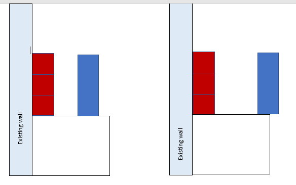

3 courses of Trench blocks have drifted inwards at the end of the run, shall i overhang inner blocks or bring everything in 20mm and reduce 100mm cavity to 80mm cavity is full fill batts ?
A maximum 20mm overhang towards one end of the run shouldn't be an issue.
The old rule was that you could overhang up to 1/3 the thickness of the block, as long as there are plenty of ties.
