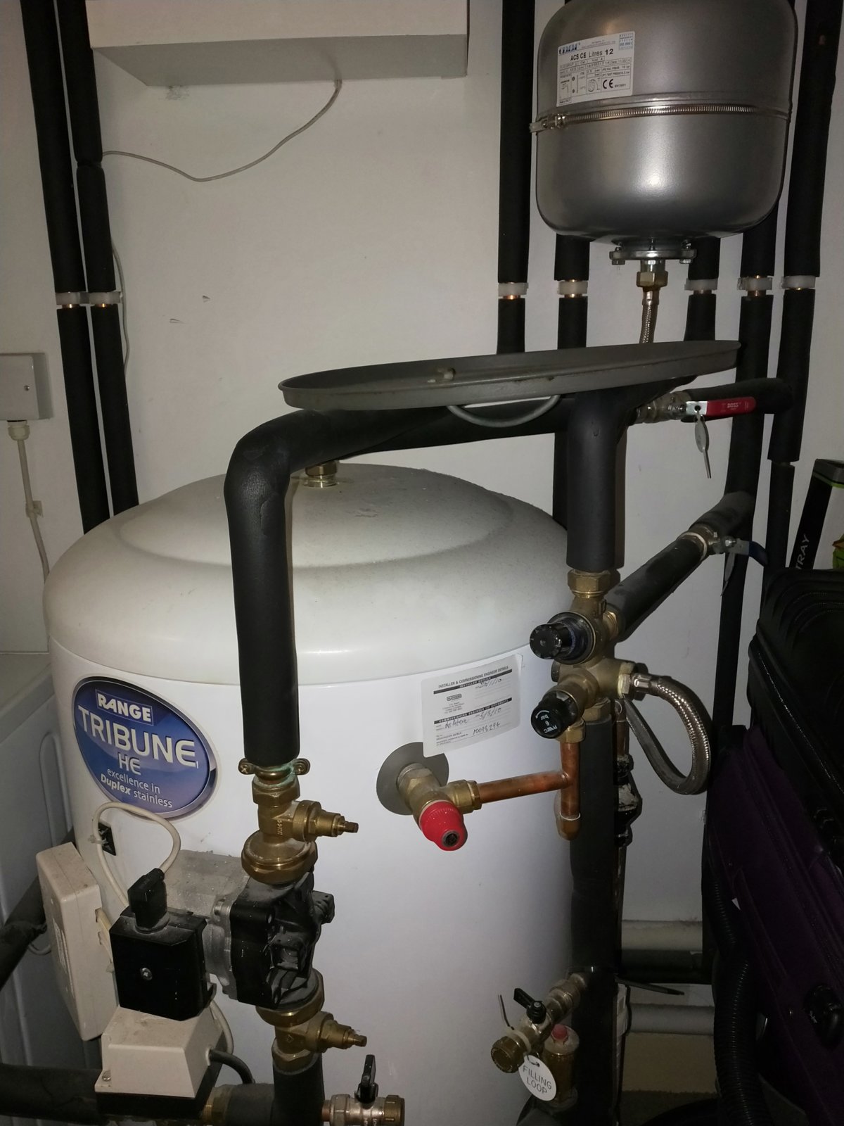

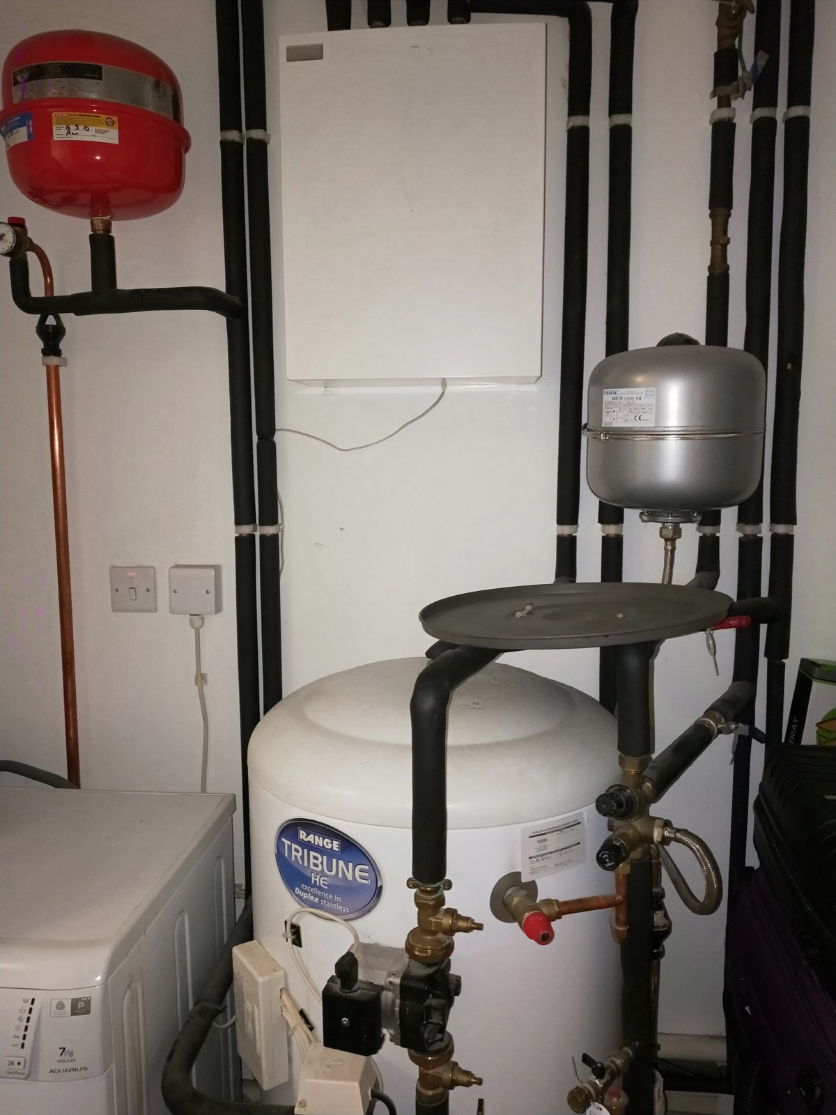

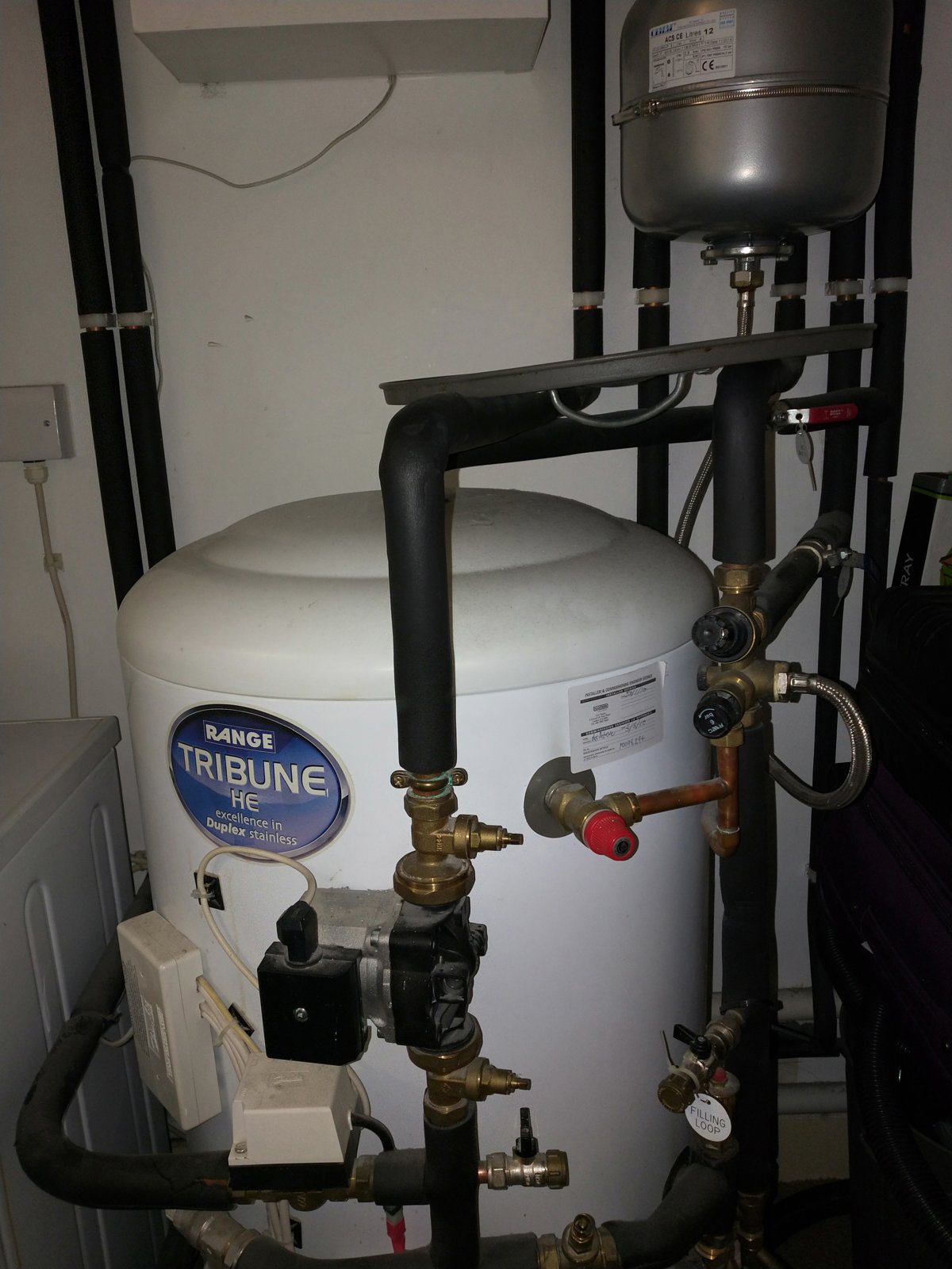

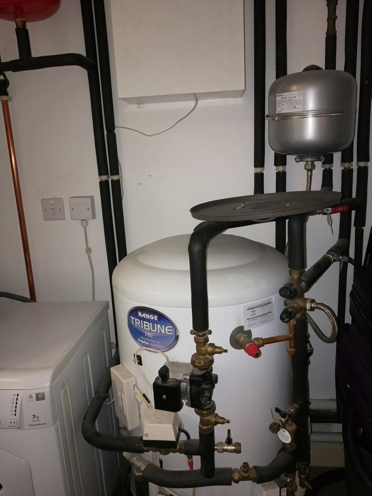

I stay at an apartment which has a hot water cylinder, the pressure value reads low value of 0.2. I need to bring it up to around 1.5 as informed by the heat supply company.
Can someone please help me with the valves to be used to get this sorted. Really appreciate your help here. Attached are few images of the boiler.

About halfway down the cylinder there are 2 capped off isolation valves. There should be a braided hose loose somewhere nearby which you need to connect between these valves after you've removed the caps. Open both black taps and you'll hear the water going in and see the pressure rise. Close the valves remove the link hose and replace the caps when finished.
Or as your in an apartment and any leak would show.....get a foot pump and recharge the red vessel.
Thanks for your reply.
We are unable to find the braided hose pipe around to connect them. We are not sure if have it was at our rented apartment. Can you please suggest where we can buy / find a new one for this boiler. We really appreciate your help and advise.
