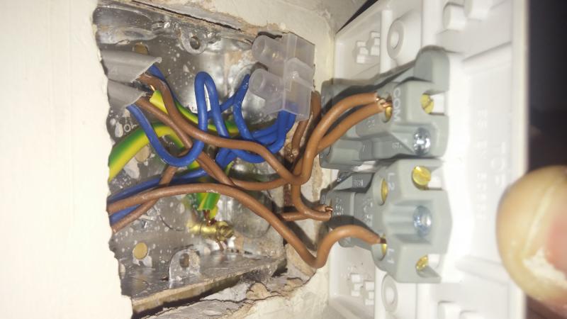

Hi,
I'll try and keep this short and hopefully someone can help me. I have also attached a picture to help.
We just moved into our house recently and our living room lights are unusual (to me anyway) there are 2 lights and a 2 gang switch with 1 for each.
After decorating we just wanted to change that light switch to a dimmer so went out and bought one. Went to try and fit it and was a bit to complicated to be honest so we didn't bother.
As id changed light switches before though i didn't envisage failing so i didn't take note of the wiring of the original switch before i took it off! :(
So i had a look at the kitchen one that works in a similar way and tried to copy that however the right switch turns both lights on and off and the left one just doesn't do anything. Also, now the kitchen lights or the outside light no longer work.
As you can see inside the box, there are 2 separate feeds, each with an earth, 2 blues and 2 browns. All 4 blues are screwed into a junction box thing and not used and then there is 1 brown to L1 and 1 brown to COM from each feed with an extra wire joining the 2 COM's.
This is the only switch in the room so no need for the 2 way
First of all is this correct? and if so why would this be happening?
Also why are none of the other kitchen or outdoor lights now not working?
You have mixed up the browns, somehow.
Does your man drawer include a multimeter? you are going to need one.
Also All 4 blues are screwed into a junction box thing and not used
They jolly well are used, they are the neutral feed in and out and the neutrals to the two lights. They are, and must be, all connected together or nothing will work.
There's probably one somewhere. no idea how to use them though, ha
Well the switches worked fine before with the blues 'tucked' away, i have never touched those. Its the same in the kitchen switch as well?
Leave the link wire between the com terminals.
The wires from the back are upside down.
So on the right switch swap the wires top and bottom around.
Then do the same for the left.

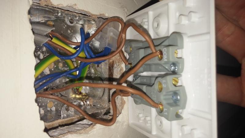

Can you take another photo, just like your first? We could see which lives from each cable went where in your original pic, so from another and your description of what has now changed we might be able to figure it out.
Turn the kitchen switch to on then.
And then fiddle with the living room lights to work out what needs to be on for the kitchen light to be on.
Ok, just went to take a picture and all the bloody wires popped out! Anyway, after re-tracing steps and screwing them back in i am in a position now where the kitchen/outdoor lights work and the living room works apart from the right switch turns on the left and vice versa.
What do i need to swap to get them correct?
Added a new pic too.
