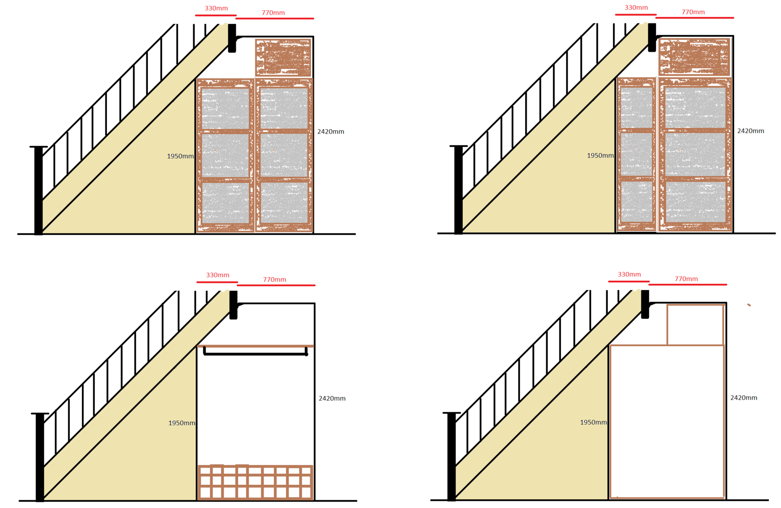

Thank you. If we can't cut it flush we'll still have to box around it, so may as well leave it. Here's what we are thinking of doing. Shaker oak doors with mirror infill where shown. Shelf with hanging rail at 195cm and shoe storage below.
I think the 2/3 1/3 split would line up better with the newel but be too wide and heavy a door especially with mirror so am inclined towards equal doors.
I was going to screw & plug a 4x1 oak veneer lining around the opening, and infill the triangular panel with the same oak veneer MDF as used for the shaker door panels.
Do you agree with MDF infill or would painted plasterboard look better?
Face fix (doors on frame) or in-frame? I was thinking face fix with 4x kitchen hinges in each door. Top door right hand hung with two hinges.
What do do with the lining? Run it around the newel, stop either side, or only line where there will be a door and caulk / bead around the infill panel? I was thinking to do the latter and to bring out the shelf flush to the door lining so it acted as a top stop for the doors. See the picture.
