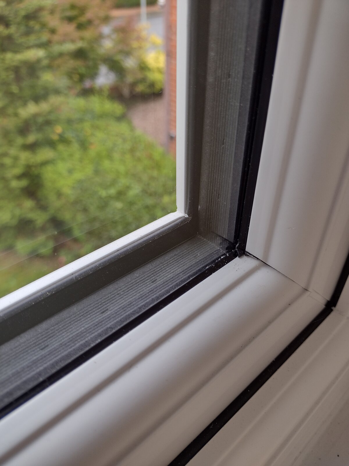

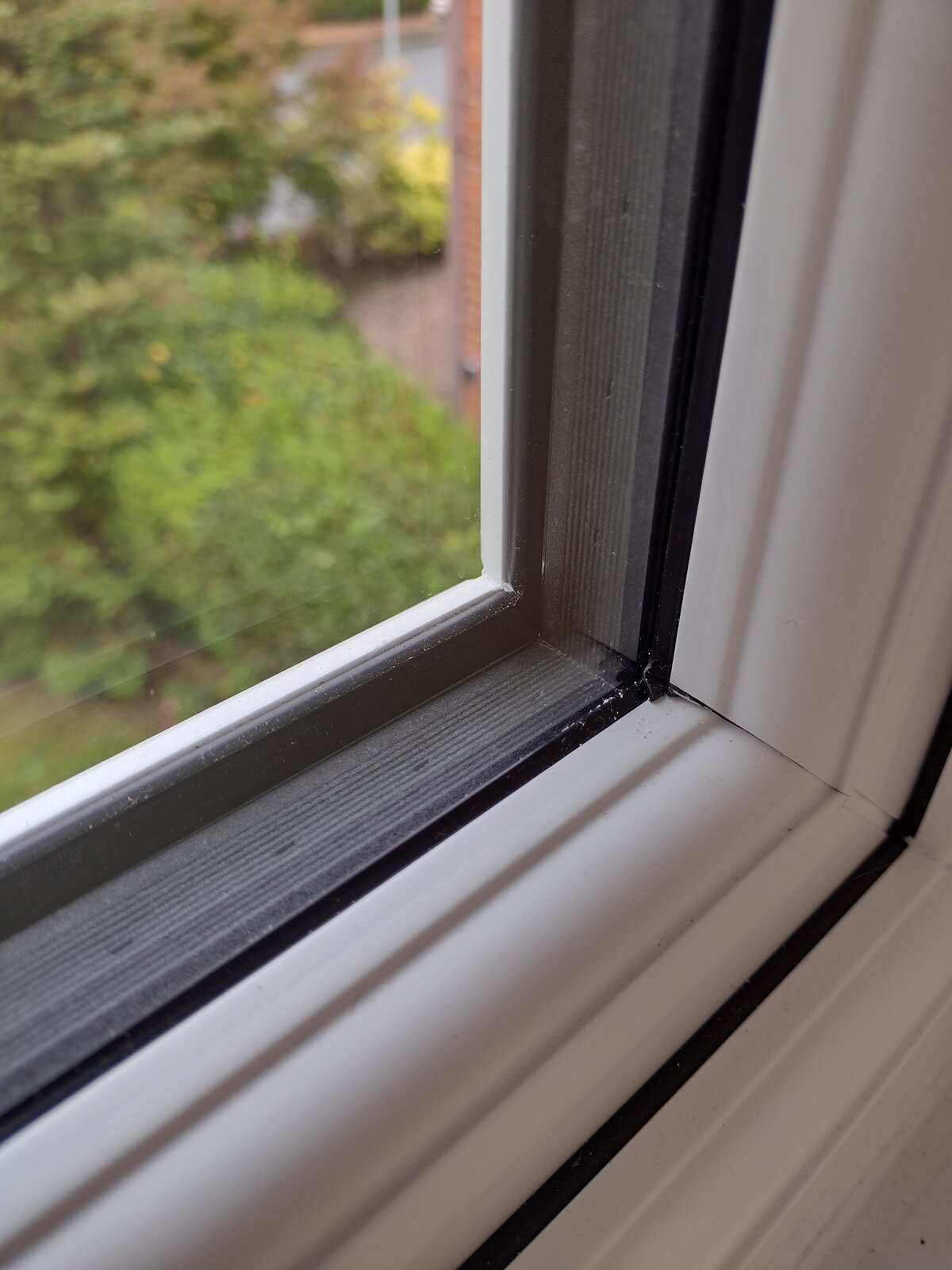

Recently had our 30year old upvc double glazing replaced,as we felt it wasn't up to todays standard,
We got a quote, and paid extra for Triple glazing, now that it is all installed, realy good and neat job,
How can I tell it is actally triple and not double? what does Triple look like?
see attached Photo

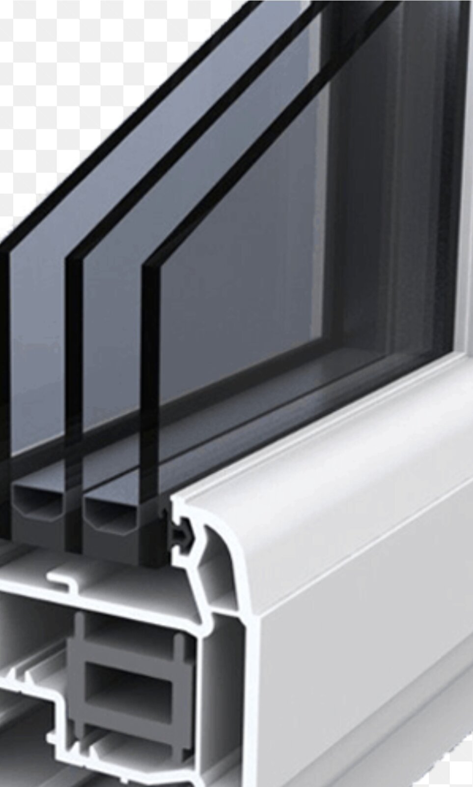

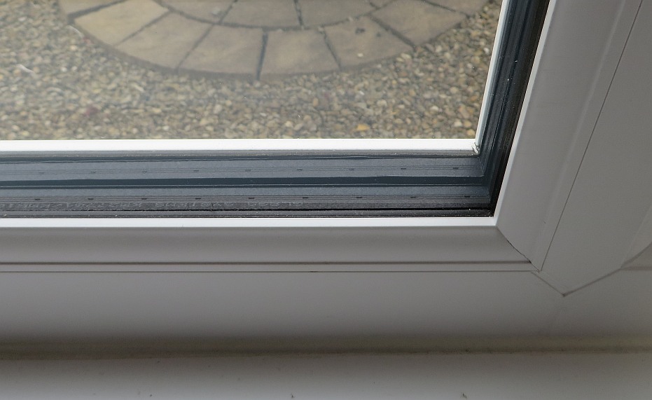

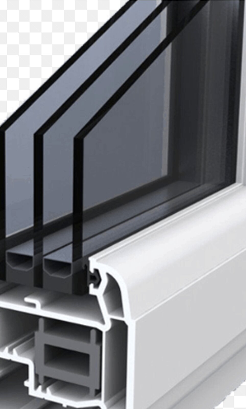

Agree, looks like double to me too, if it were triple you'd see 2 spacer bars or certainly a join in the middle indicating there are 2 spacer bars
I agree with previous posters, that does look like double glazing rather than triple. Shine a phone torch onto it, if you see 4 reflections then it's double glazing, if you see 6 reflections then it's triple glazing

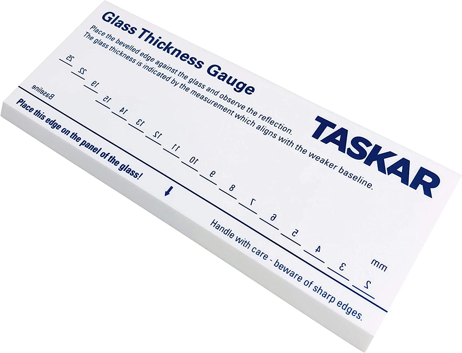

Also, for a tenner you can get yourself a glass thickness measuring gauge. After you receive an itemised invoice, you can check that it is 6mm as they are saying and not the usual 4mm.
