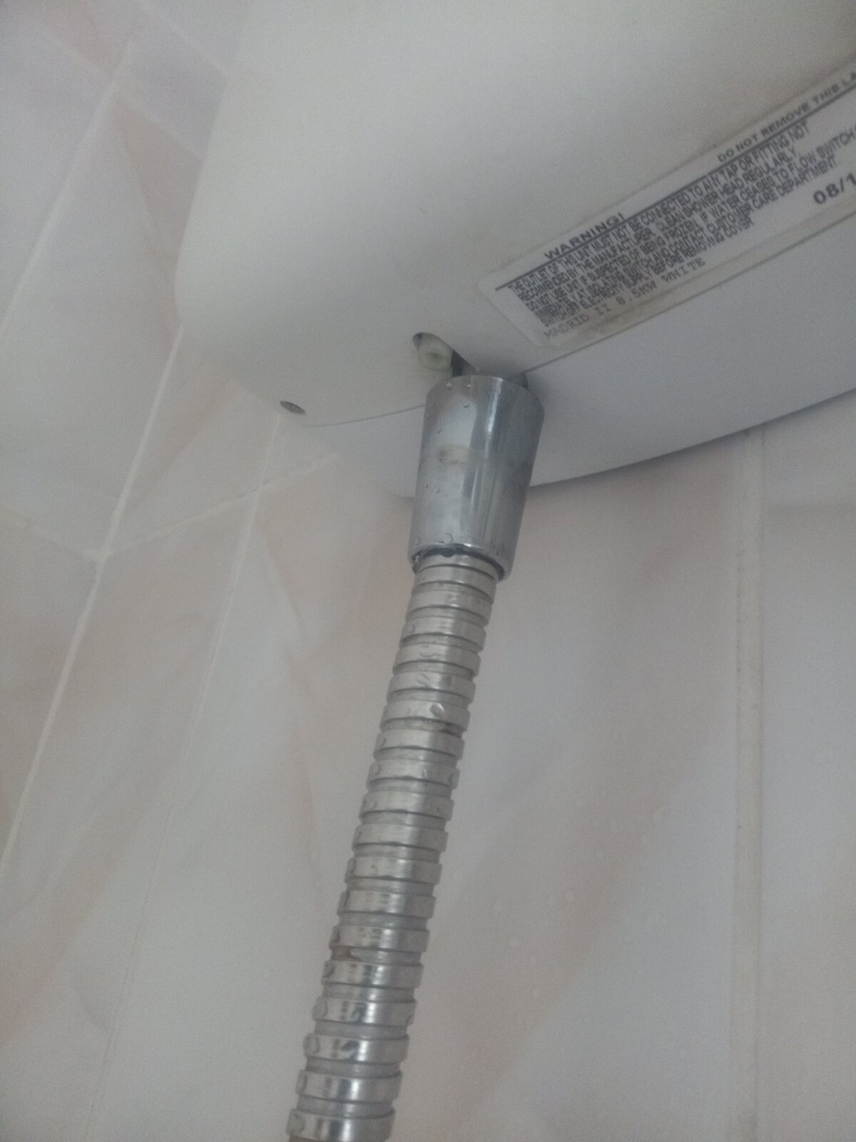

Hi Everyone, I have a Triton Madrid electric shower which is around 12 years old and the overflow is leaking. I thought there might be a kink in the hose, so I replaced both hose and head but with no success. This only happens when I lift the shower head parallel or nearly parallel to the shower, if I lower the head towards the shower floor it stops overflowing. (I could shower while sitting down I suppose?)

Electric showers don't have overflows. What exactly are you referring to ,could it be the pressure relief valve ? Small tube low down near shower bottom ?
Yes, next to the hose outlet.

I removed the shower cover and the PRD, there is a membrane cover that has blown. This now makes sense as the problem has only surfaced since I replaced the original shower head which, along with a possible kink in the old hose, must have been forcing the water back? I have ordered 2 PRD's (which include the rubber covers) from the Triton website for around £11. Thanks very much for your advice and I will let you know how I get on.

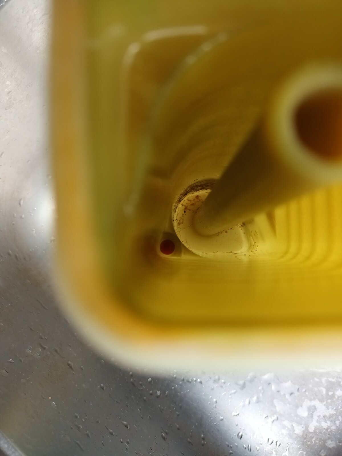

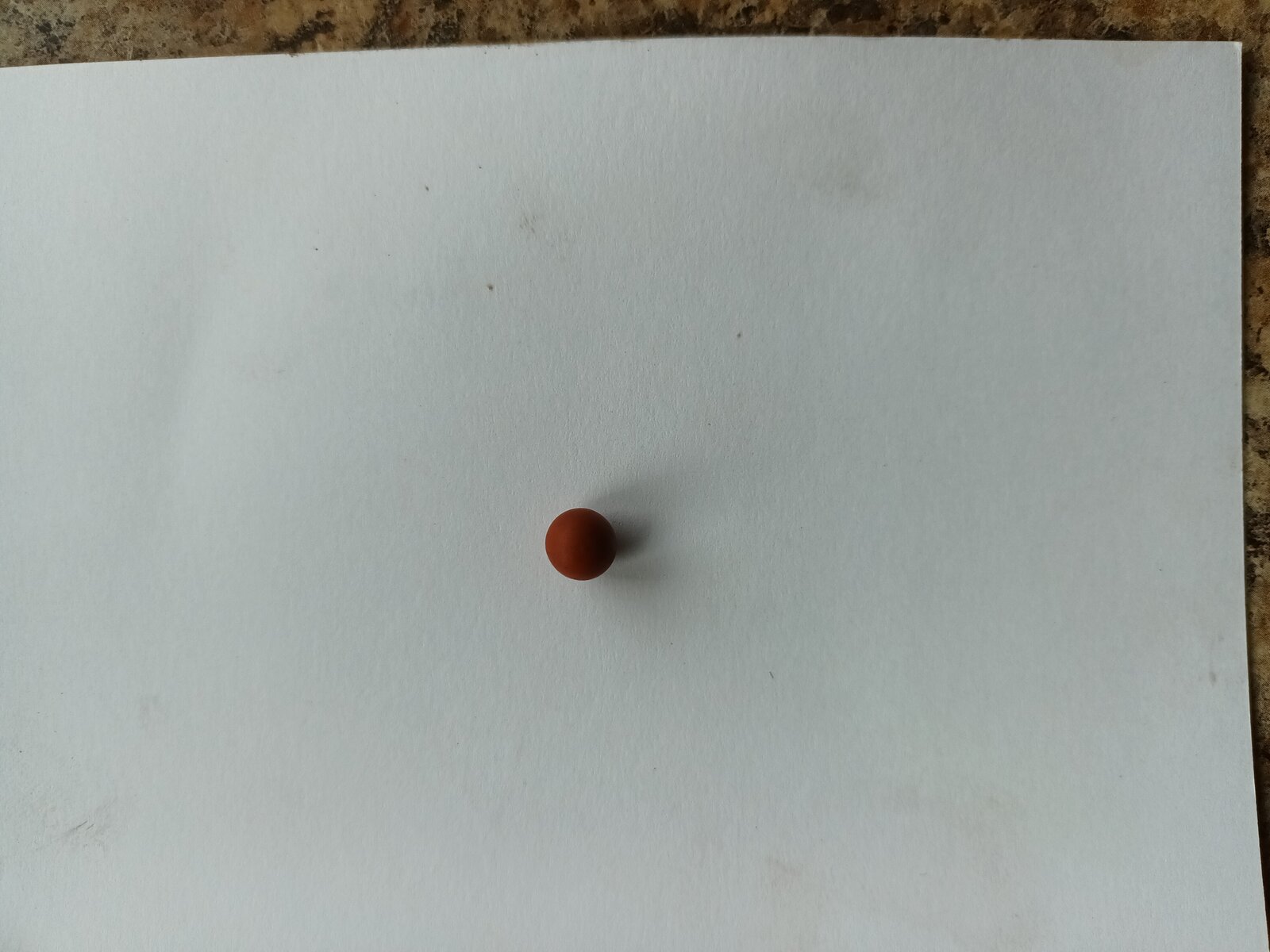

I replaced a 18 year old Mira Sport with a Triton T80 Fast-Fit, the Mira had no PRD but the Triton does, I think both are rated for 10 bar static but wonder why the Mira had no PRD as I wouldn't fancy seeing its heating can subjected to very high pressures, wonder what pressure does the PRD operate.
Spoke too soon, on inspection, the Mira does have a PRD, its a little rubber ball inside the heating can, see photo of the opened heating can with heating elements removed and a photo of the rubber ball removed from the can.
