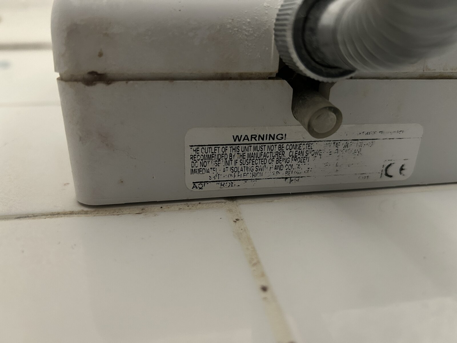

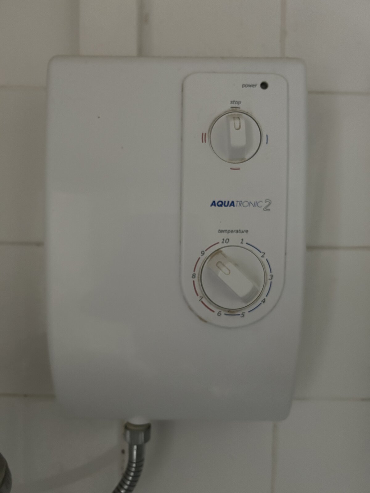

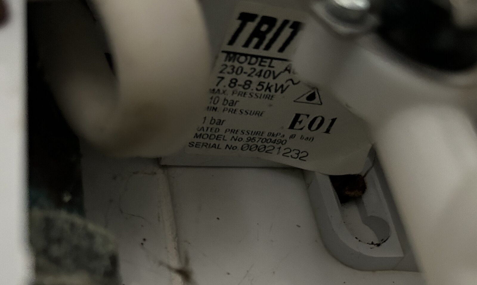

Hi,
I'm looking at having this ancient unit replaced. I want to replace it with a model of the same wattage. The sticker on the bottom has worn away. I took the cover off and found a sticker saying it's 7.8-8.5KW. Does this mean it's 8.5KW? I have tried google searches but it's so old I can find much apart from they made this model with different power options. Any help would be great!
The maximum wattage it will use is 8.5KW. Depending on the setting you use, it can go from 7.8 to 8.5.
It's probably reflecting the fact that mains voltage is 230-240V.
It takes a fixed current, the wattage depends on the actual voltage.

It has a fixed resistance. The current and Wattage depend on the voltage

Not quite - current and wattage are dependent on the voltage applied, and resistance of the element. Assuming the resistance stays the same, increasing the applied voltage, will increase both watts and current.
