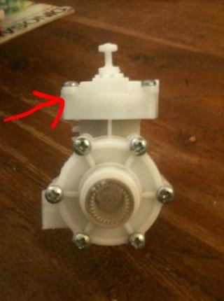

I'm at my wits end with our shower and am hoping someone can help, here goes.
A little while ago i noticed water pouring out of the bottom of our triton t80si shower, coming from inside the case. I took the cover off and turned it on and water was squirting out of the stabiliser valve where the top bit screws on
I bought a new seal thing for inside the top section and fitted it but it still leaked. Then i got a whole new stabiliser valve and fitted that but it still leaks!
Is it possible the pressure is just too high? If i take the whole shower hose off where it joins to the case, and turn it on, there is no leak
I did buy an eco shower head that is supposed to reduce the water that comes out, but this has been working for ages.
Thanks in advance.
