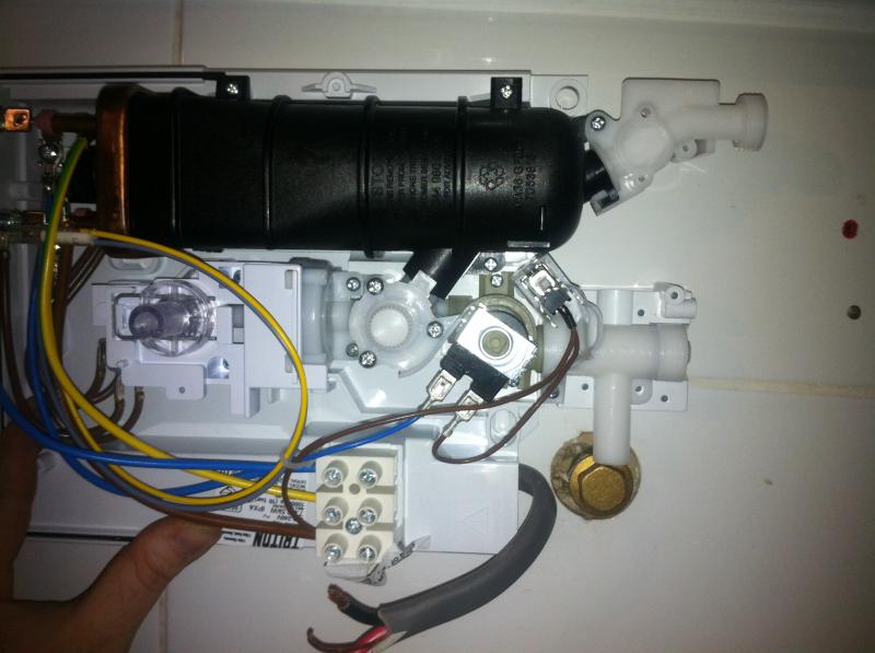

:roll: I am trying to fit this new shower however i am having trouble locating a pipe...? to connect my water inlet to the shower can anybody tell me what this is called?
i want to connect the brass pipe to the plastic pipe but i dont know what with. At the moment the brass water pipe has a stopper on :/
You want a 15mm x 15mm compression elbow fitting.
That one is a compression you tight the nut with a spanner and that compresses the olive to grip the pipes.
They don't recommend using pushfits on the shower outlet (plastic part).
Will state that in the MI's.
Don't over tighten the compression onto the plastic shower inlet you'll break it.
Best to fit the nut and olive to the shower before fitting shower.
